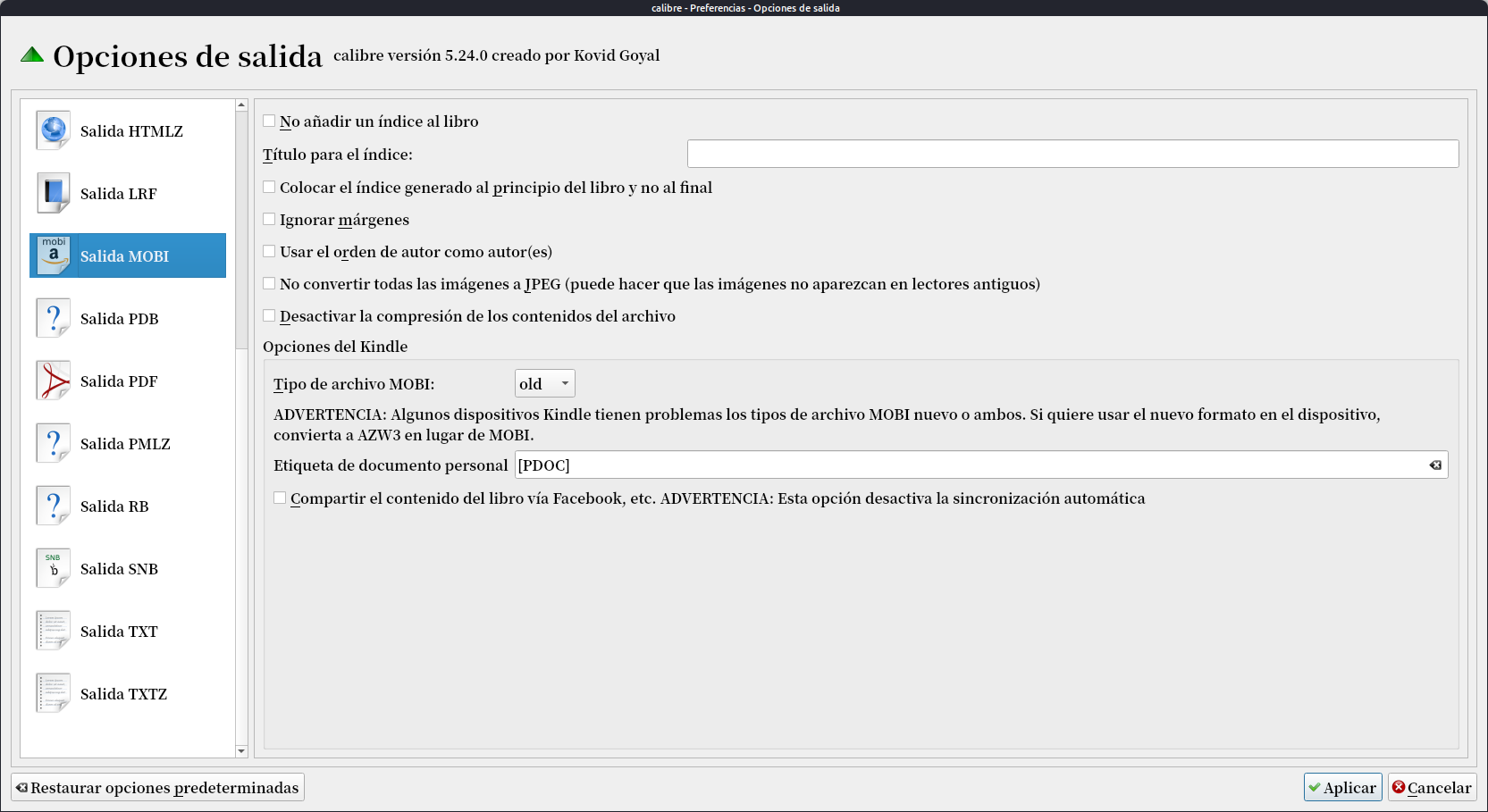

Sorry but I can't find that option in my mobi output. Could you tell me?

Make sure that the "Enable sharing of book content..." option is not selected in the MOBI output or AZW3 output conversion settings.
It it the last option, "Compartir el contenido del libro.."
