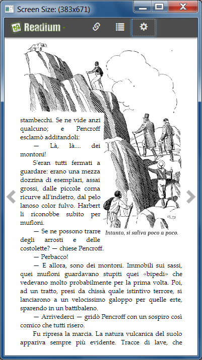

And here you can see how it looks under Readium, BibiReader and EpubJSReader:
ID:	188126 Click image for larger version
ID:	188127 Click image for larger version
