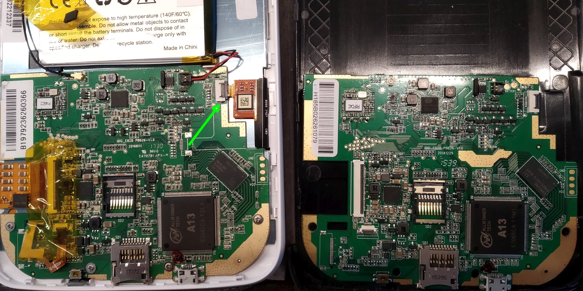

Hi
I have PocketBook Touch Lux 3 (626). Some time ago it stopped to work (it was a process, but it's a different story) and everything seemed it was power supply section that was dead.
I bought another PB with broken screen with an intention to replace mainboard in mine. But it appeared it is slightly different: touch screen socket location is different (attached picture) and it was impossible to connect the flex there. But there were soldering pads in the old location, so I resoldered the socket (i checked that pads in both location are on the same lines).
PB has started, but the touch screen is not working. I suppose it is caused by different driver in the system. I tried to replace memory card with one from my original mainboard, but PB is not starting with it (screen is not even turning on). I suppose it is caused by device serial number check.
I see following possible solutions:
- to use the card from new mainboard and somehow replace the touch driver
- to use my original card overcome somehow serial number check
Am I right? What and how would you do?

I compared both cards and found few differences between files. I started moving files one by one from the old card to the new one and finally following combination worked:
- deleting screen.cfg (not present on the old card)
- replacing hwconfig.upd
- copying 320_G110_AA9224_ED060XD4U2_TC.wbf
vugie is offline   Reply With Quote

I noticed another effect. When I turn on the backlight and than off again, it doesn't go off completely. It does only after turning device off. It wasn't so with the previous board. Do you know on which file it may be dependent on? I tried replacing vcom file (it contains single negative integer in plain text), but nothing has changed.
Originally Posted by nhedgehog View Post
BTW on your mainboards pictures I could not see a difference.
Look below touch screen ribbon
Board on the left is already after moving its socket (indicated by arrow).

Here they are. I didn't made full image, just copied files from boot partition. 8gb is from the left mainboard in my picture, 4gb is from the right one. I can make full images if you need.

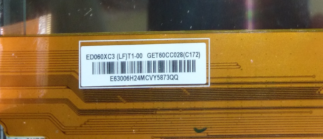

To sum it up for other that might be reviving Touch Lux 3 / 626 hw revision PB626-1.9 without having original SD card.
HW revision 1.9 is using ELAN touch controller and this can be found on its LCD sticker
ED060XH7
U1-50
LET60G7004/(G120)
EJ8509C01R7A0113
