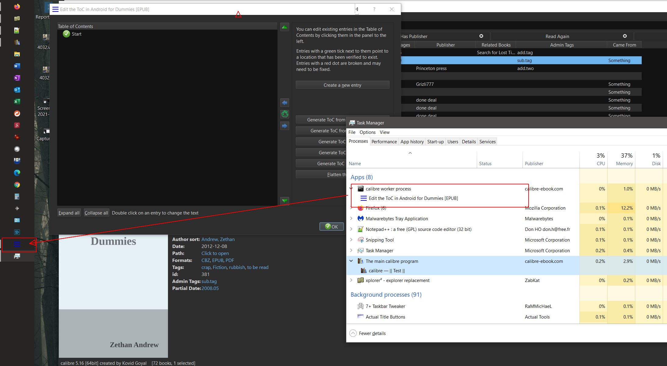

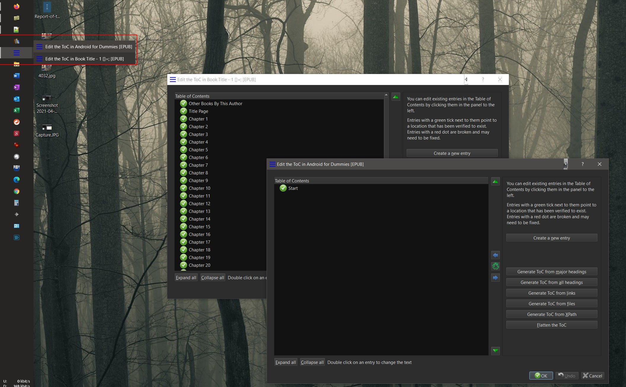

I noticed this:
I can have several Toc Edit Windows open, and when I exit calibre the Toc Edit windows don't close
Name:	Screenshot 2021-04-26 143826.jpg
Seems unusual for calibre

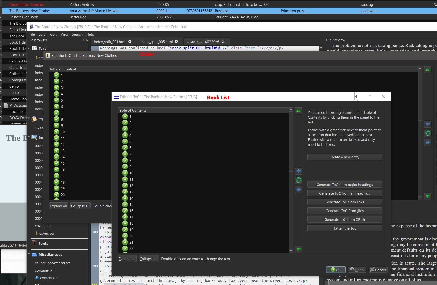

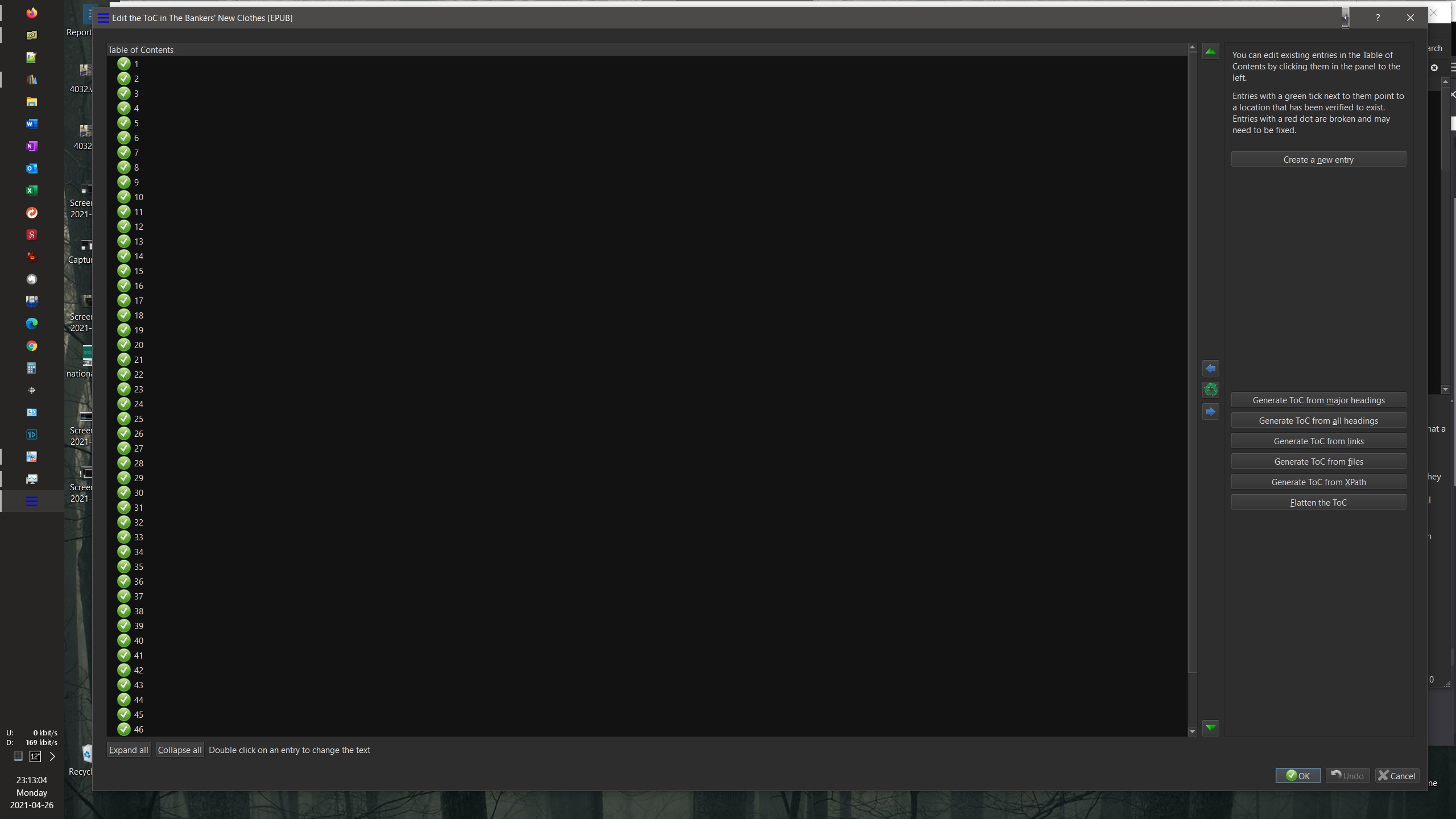

@Kovid - should the Toc Edit window be the same size if its invoked from the Book List and Editor - because its not.
Name:	Screenshot 2021-04-26 225353.jpg
I think the one that's used when the ToC Editor is invoked from Book List is defined by - 'toc_editor_window_geom' in gui.json - I couldn't find another one.
If I stop calibre, delete that entry, run calibre and open the ToC Editor from the book list I get a very large window
Name:	Screenshot 2021-04-26 231341.jpg
If I resize it, and exit the ToC editor and calibre gracefully, the toc_editor_window_geom entry is not written to gui.json, so when I start calibre and open the ToC editor its still a very large window
Added : Changing Adjust for high resolution screens : from Automatic to Off had no effect
