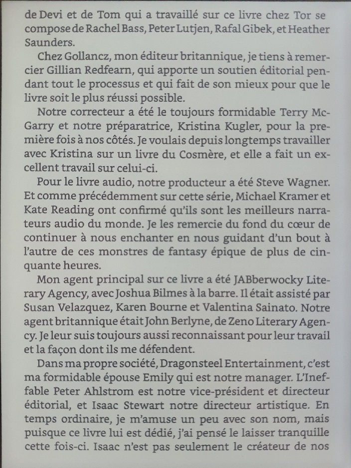

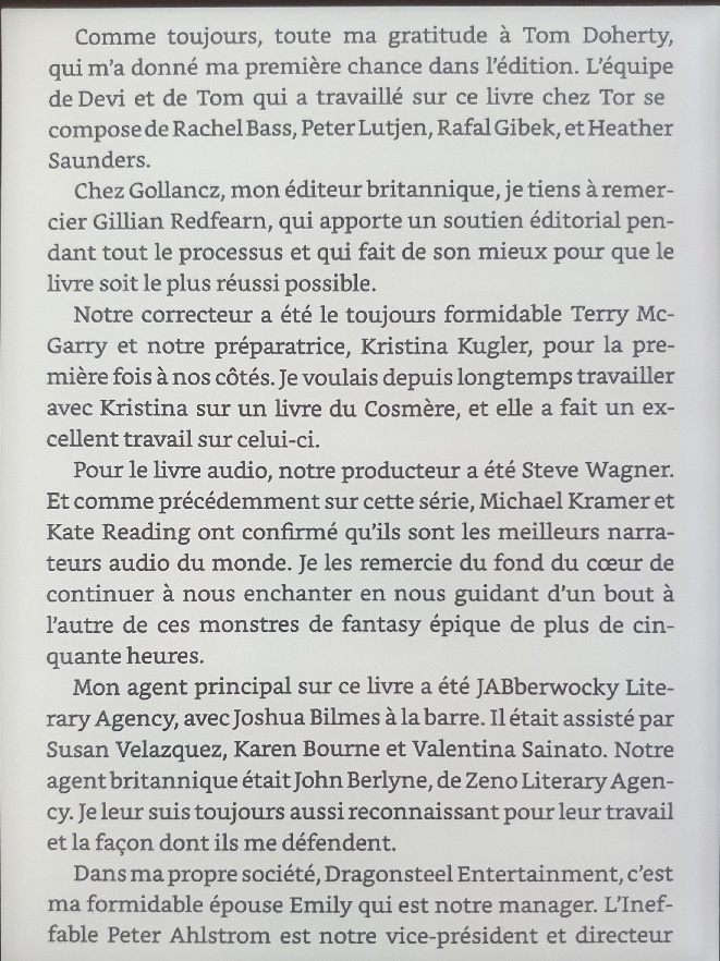

Hi guys,
When I shutdown my Kobo Forma, start it again, and reopen the .epub I was reading, line-height property adjusted by the slider isn't properly applied (see by yourselves, two attached pictures showing what happens).
I don't find any long-term solution, considering I already removed any line-height property of the book by conversion (double-checked the book stylesheet, no line-height property remaining).
I did find a temporary solution, which is touching anything on the Kobo slider, forcing the epub reader to refresh, and everything is back to normal (until next shutdown).
Did I miss something ? Thanks for any help.

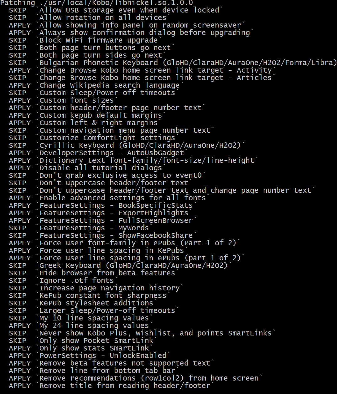

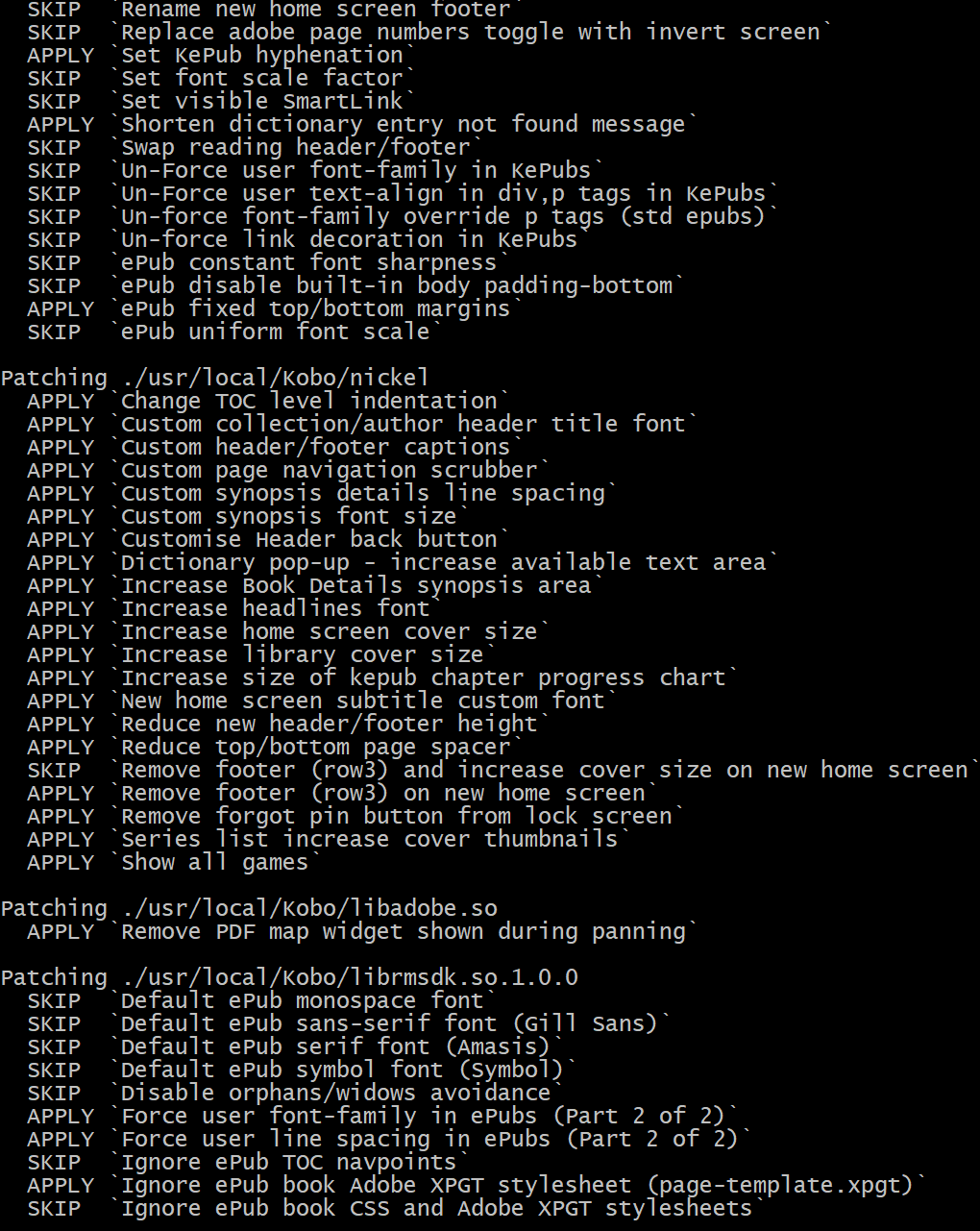

Sigh. You didn't ask for it in your previous message.
By the way, I did check my enabled / disabled patches too, before posting, and I didn't see anything irregular.
Nonetheless, I gladly post my patches' list (please see the two attached files).

I've no interest in applying patches. I'd suggest you unpatch and test again
