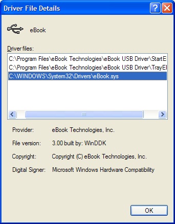

If you see that ebook item, then double-click it to see the Properties and tap the Driver tab (it should then look like "-pic2", below). Ensure you have the right driver, if not, click the Update Driver button. You may also want to tap the Driver Details button to ensure you have the info as in "-pic3" below.
However, if on that ebook item you notice a yellow exclamation point, then you must Uninstall the driver and then, WITHOUT the EBW1150 being connected, re-installed the ETI usb driver v3.00. Then when done, connect the EBW1150 and see if it works.
ID:	19271   Click image for larger version
ID:	19272   Click image for larger version
