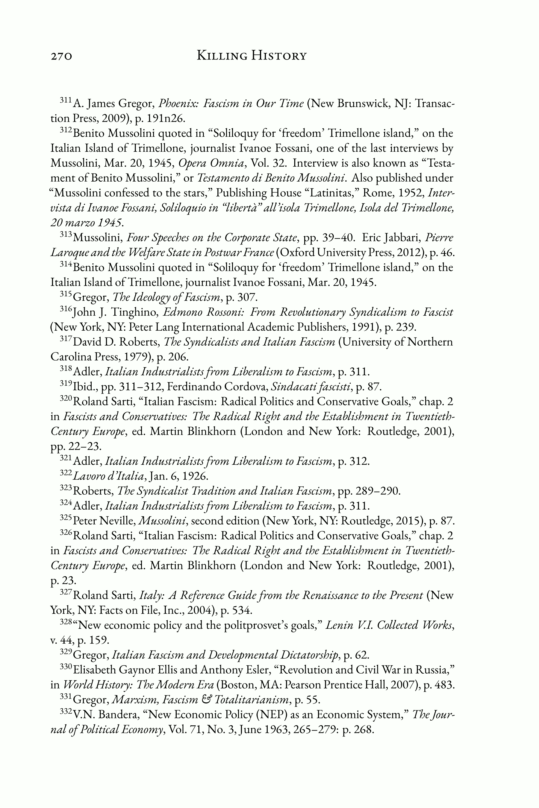

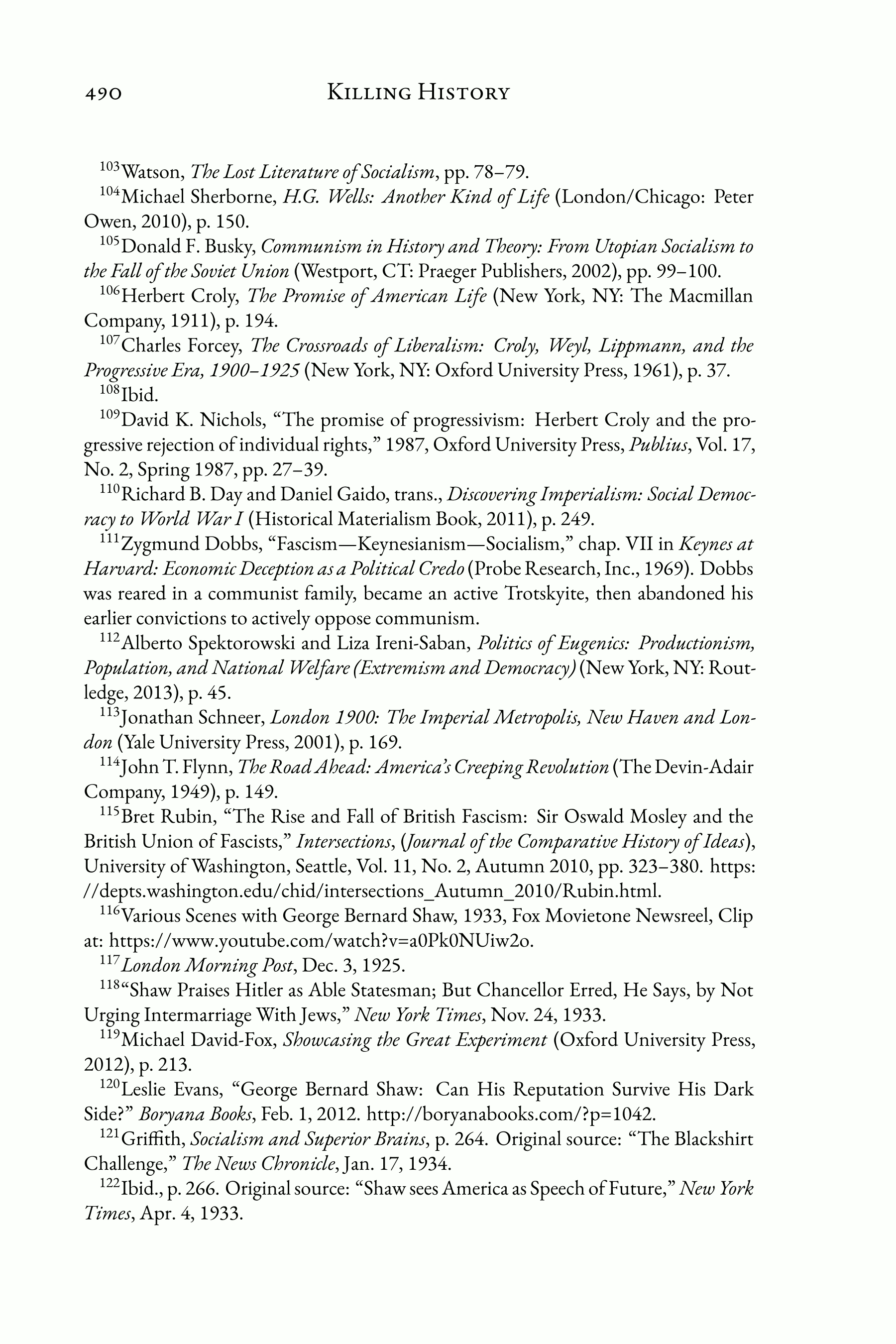

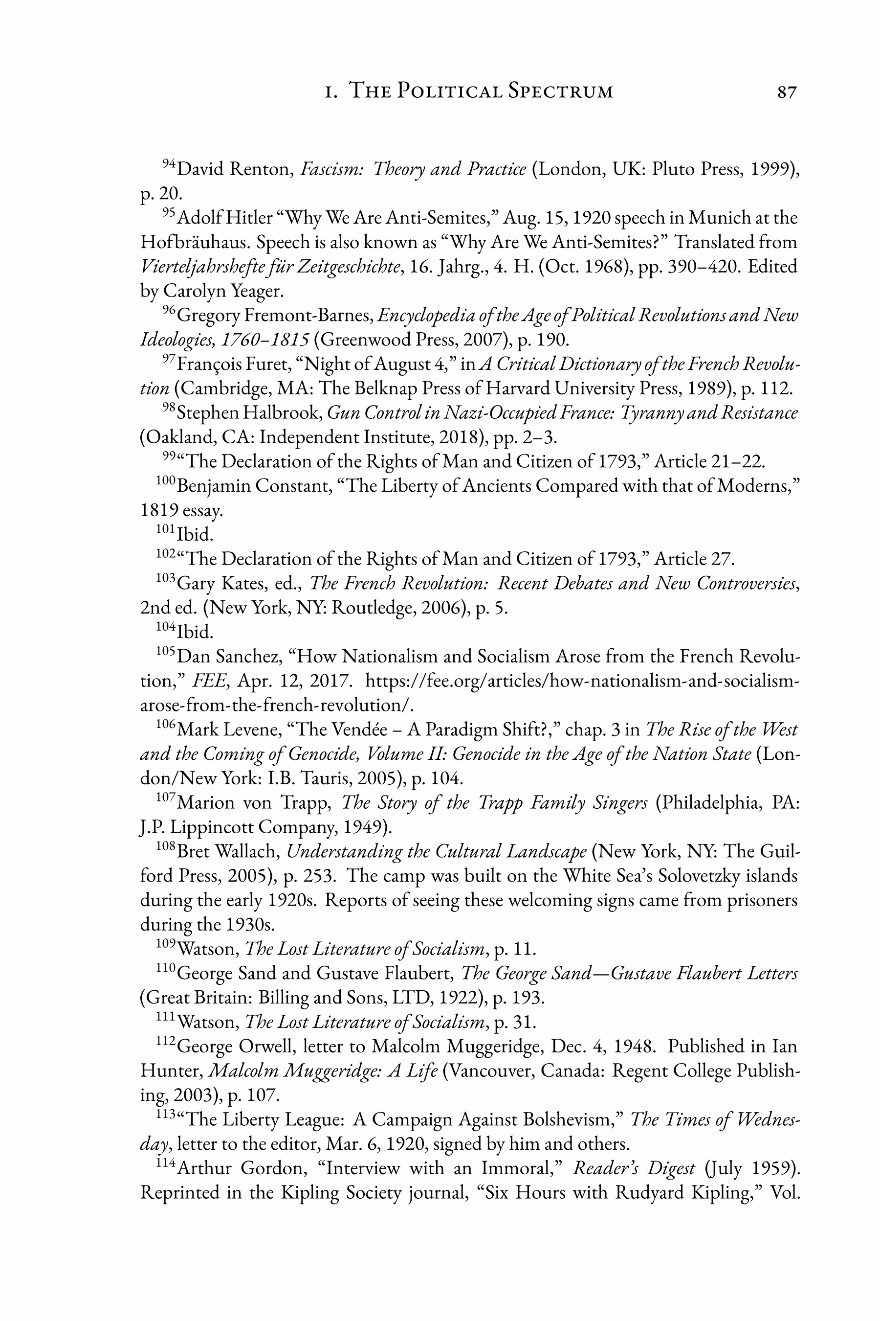

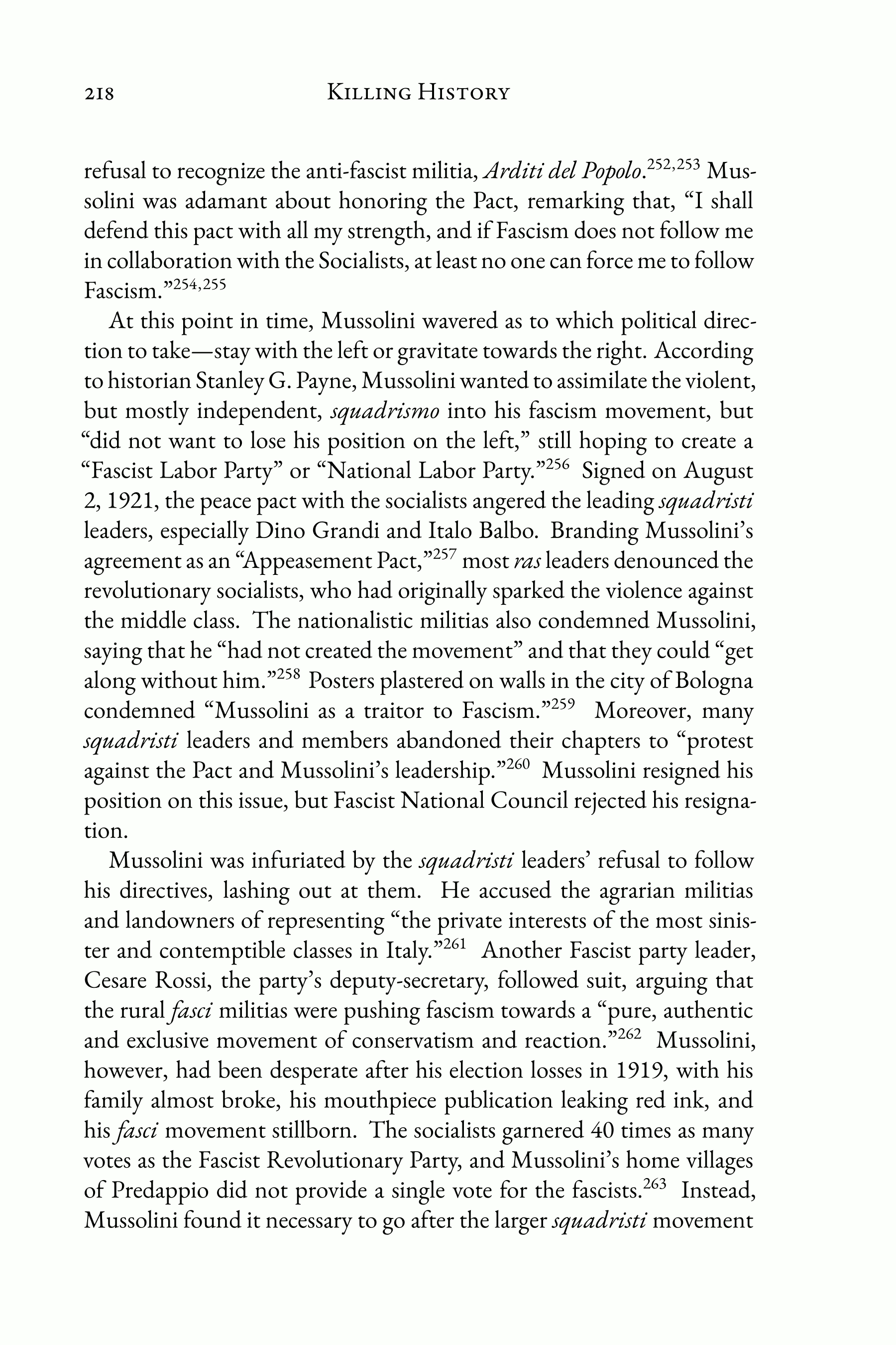

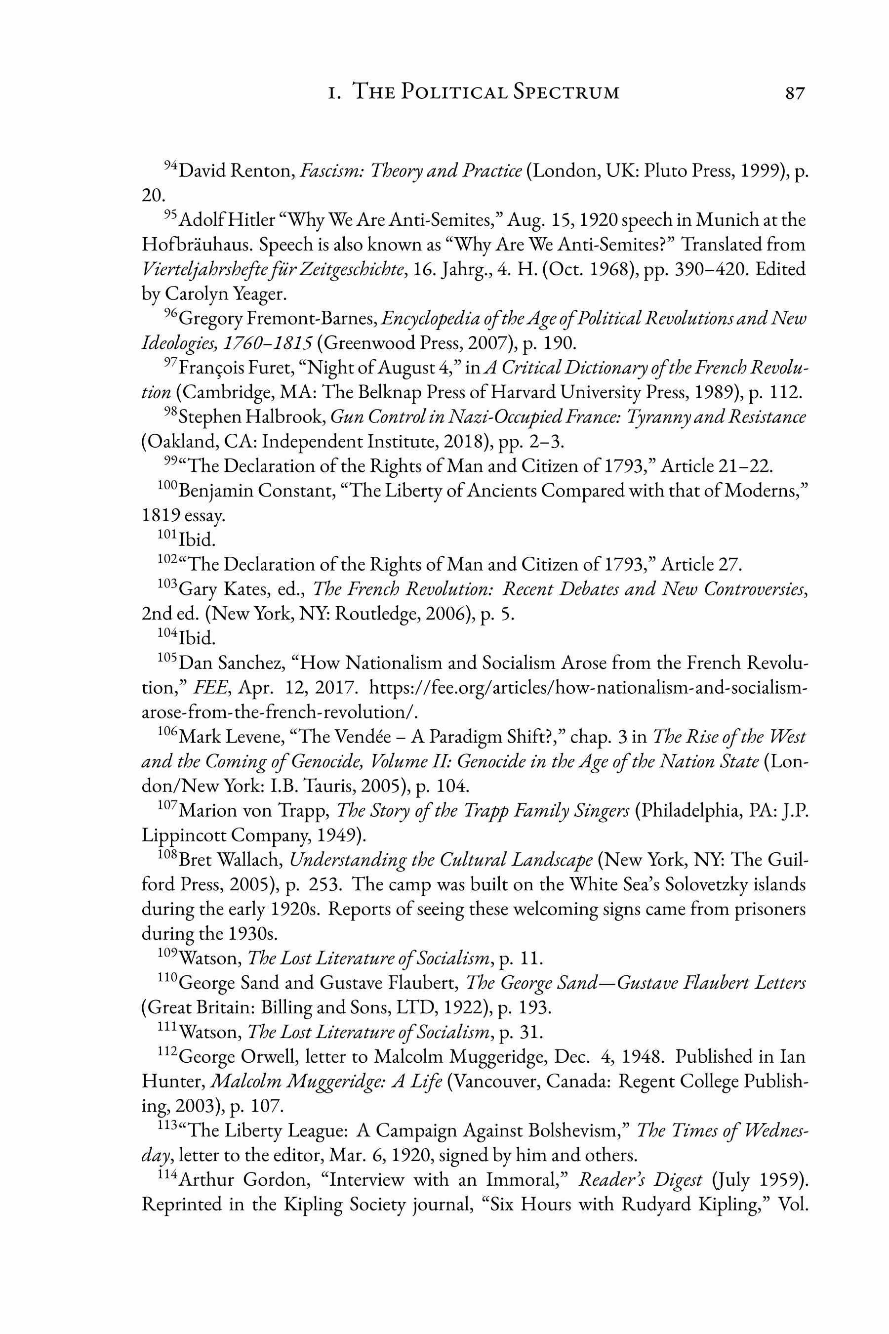

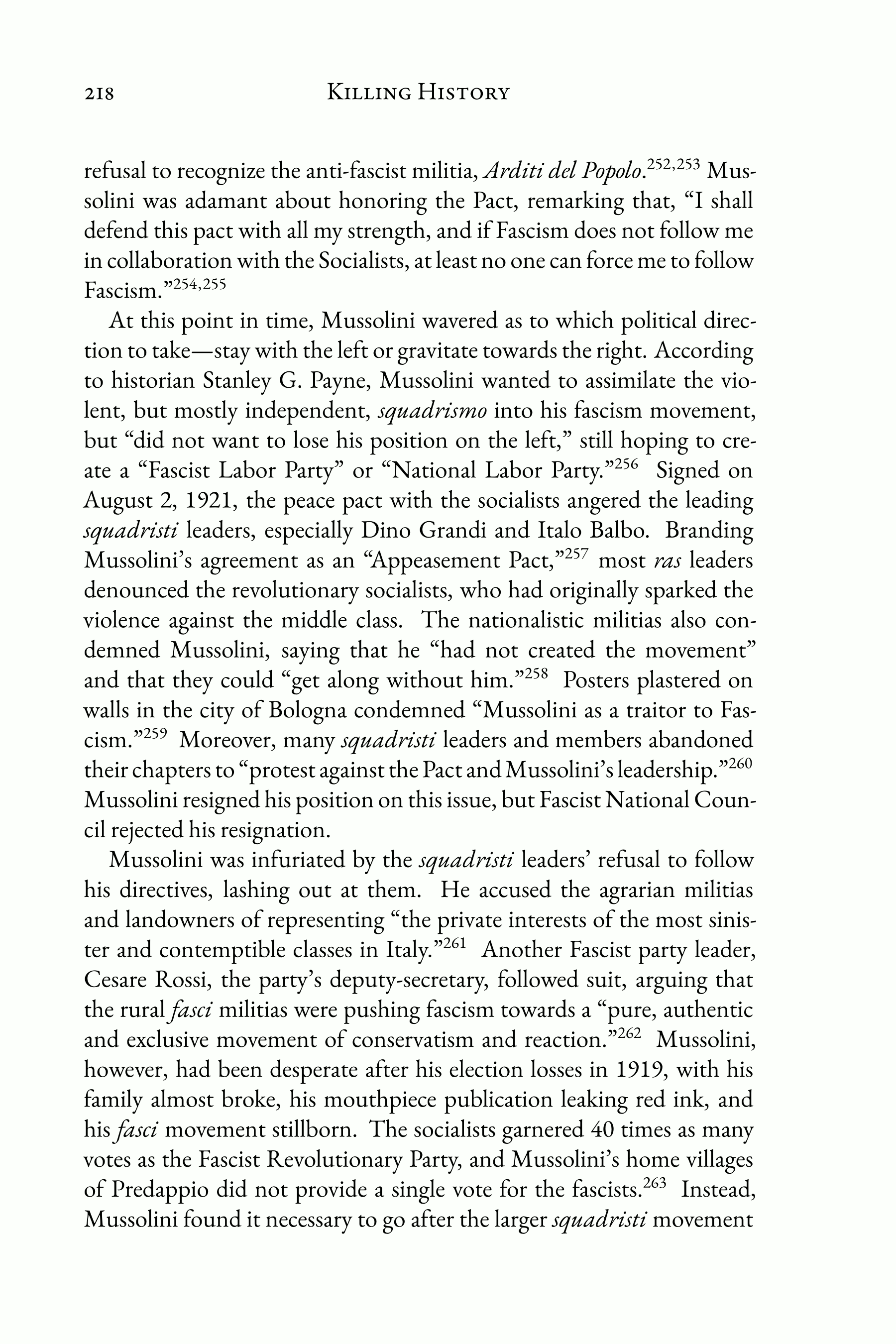

So, here's a real-life example from a history book I typeset last year (189k words, 595 pages).
Left = Normal Spaces throughout
Right = No-Break Spaces
1 "p." + 1 "F.M. Last":
ID:	186284Click image for larger version
1 "p." + 1 "pp.":
ID:	186288Click image for larger version
1 "No.":
ID:	186290Click image for larger version
And see if you can spot the no-break space here:
ID:	186286Click image for larger version
There were ~6000 no-break spaces added throughout the book:
  • Most land in the middle of text, barely perceptible nudging.
  • Only a small % of those actually ever land at the end of a line.
And as you can see in the 218 example above, paragraph-level justification + hyphenation automagically takes care of the vast majority of THOSE, so you see even LESS spacing/line-breaking problems. (A percentage of a percentage.)
Side Note: I searched the book for "p." + "pp.":
  • 1425 total.
  • 21 fell at the end of a line.
~1.5%.
The % is probably similar for all the other categories I listed earlier too.
So out of 6000 cases, ~90 might've made a readable difference.
(There was actually 1 case of "Sen." ending a page. Now that was an egregious issue.)
