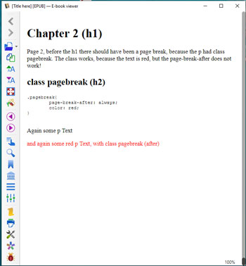

Your sample works for me in the calibre viewer.

Make sure that the calibre viewer is not in flow mode.
AHH! Sorry, that it is. Yes, then, calibre works then too
Sorry.
Flow mode is it.
