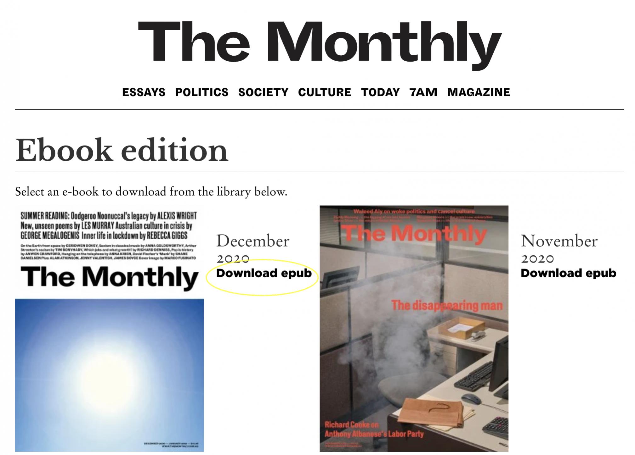

Can someone point me in the right direction of setting up a scheduled download for a file which is already an *.epub?
This is the website: https://www.themonthly.com.au/ebook
You need to login to get behind the paywall, but then you can see the epub files ready to download. I have been manually downloading & emailing via calibre.
I would like to create a recipe similar to those for RSS feeds, to auto download this file & email to my Kindle. Can anyone point me in the right direction?
Many thanks

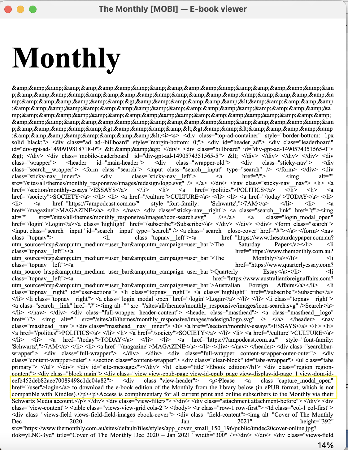

I think my highlight on the below shows I'm close to getting it to work, but the code is falling over somewhere, the output is as shown - a bunch of HTML, it doesn't seem to be logging in / finding the epub file.
Any tips? Many thanks
