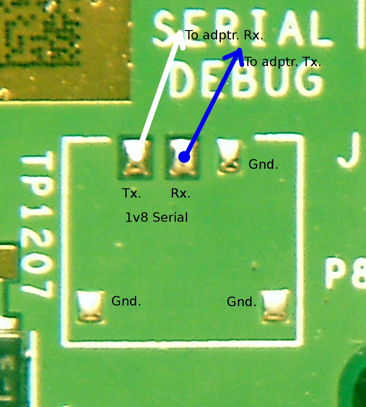

Couple days ago I had success with serial port communication on same device, but my success was only partial. Don't worry serial communication worked but I was not able to stop boot process by pressing a button.
You'll need to solder only three wires to use serial communication: GND (left), RX (middle), TX (right).

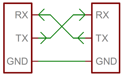

Do not get confused RX on source device is connected to TX on destination device and reverse.

Best luck. I am really curries to see will you succeed to prevent boot by pressing a button.
