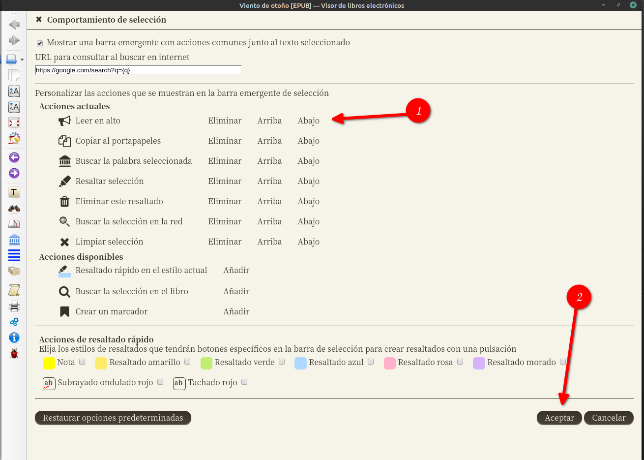

I just discovered that I cant add the Icon to the viewer toolbar. Please...
The same thing happens to me, that's why I thought it was not compatible with linux Mint 20
The icon does not go in the toolbar, but when you select the text.
There is two ways to read the text aloud:
1) You can select some text and click on Read Aloud on the popup bar. This will read only the selected text.
2) If you bring the Viewer controls, there is a Read Aloud button (shortcut is Ctrl+S). This option will read aloud the whole book, starting at the current page.
thiago.eec is offline   Reply With Quote
