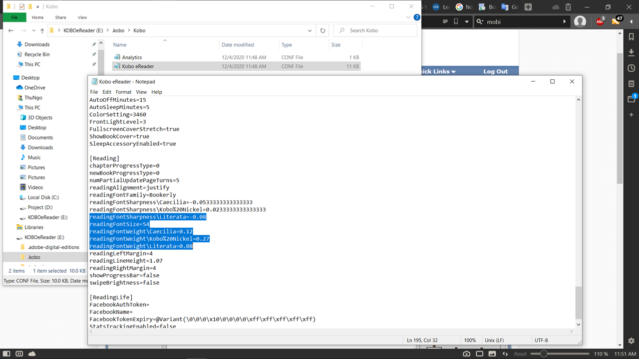

I copy some customized fonts (.ttf) into "fonts" folder, adjust the conf. file in ".Kobo" folder as GeoffR's guidance for Freedom to Advanced font control by adding readingFontWeight and readingFontSharpnes to the [Reading] section in Device .conf file as attached photo.
However while reading my kepub ebook, it's still no show Advanced option. I've tried all Fonts family in here
https://drive.google.c o m/drive/folders/1w_801KjW1ga5ASR4VxZy1_Uj5JCjkb34?usp=sharing
but seems nothing happens.
Could you please help with any solution/fix besides patching the Kobo Clara?

The entries in the .conf file are a way of manually changing the weight but the key word there is manual, they do not enable the Advanced font controls. The only way I am aware of to enable the Advanced font controls for all fonts is to patch the firmware.
