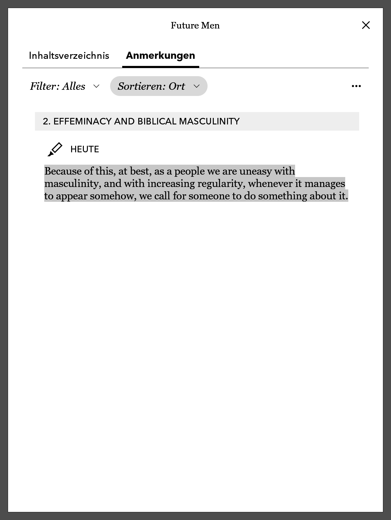

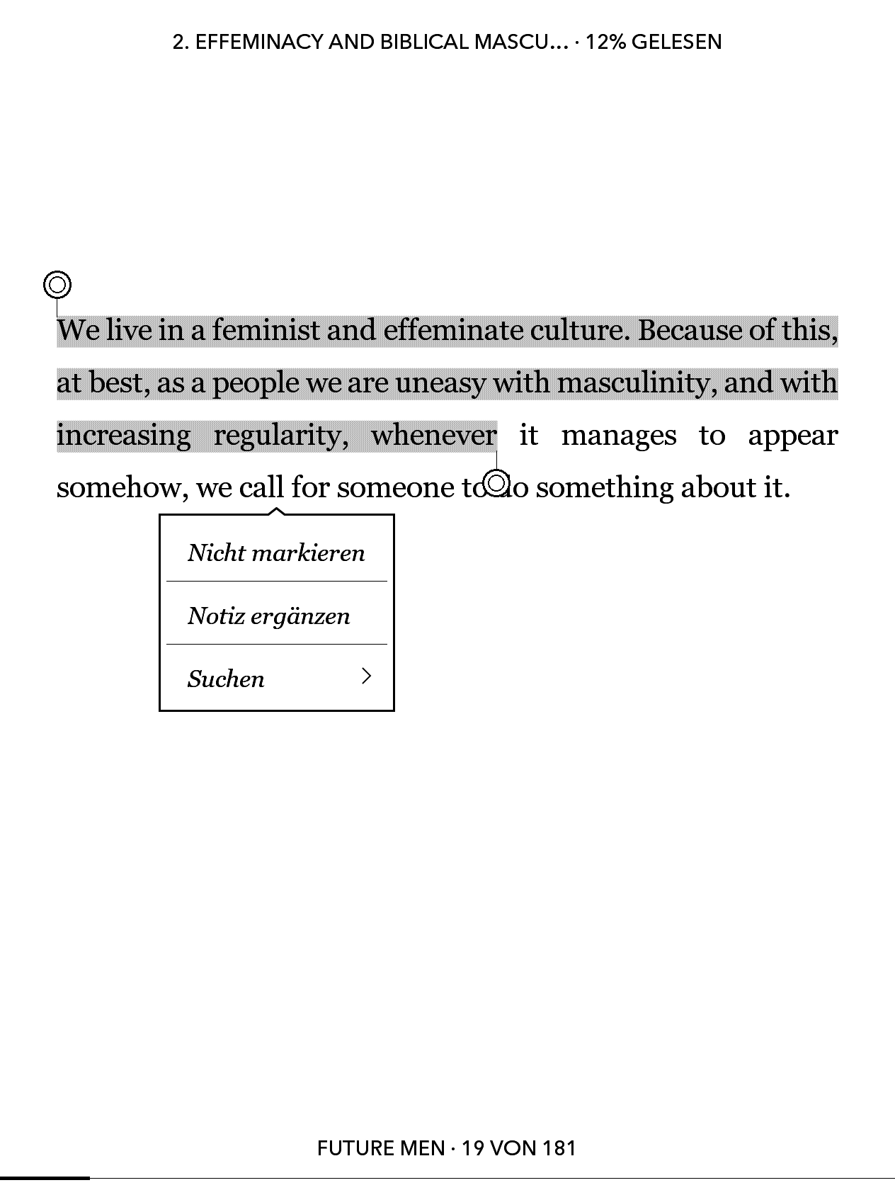

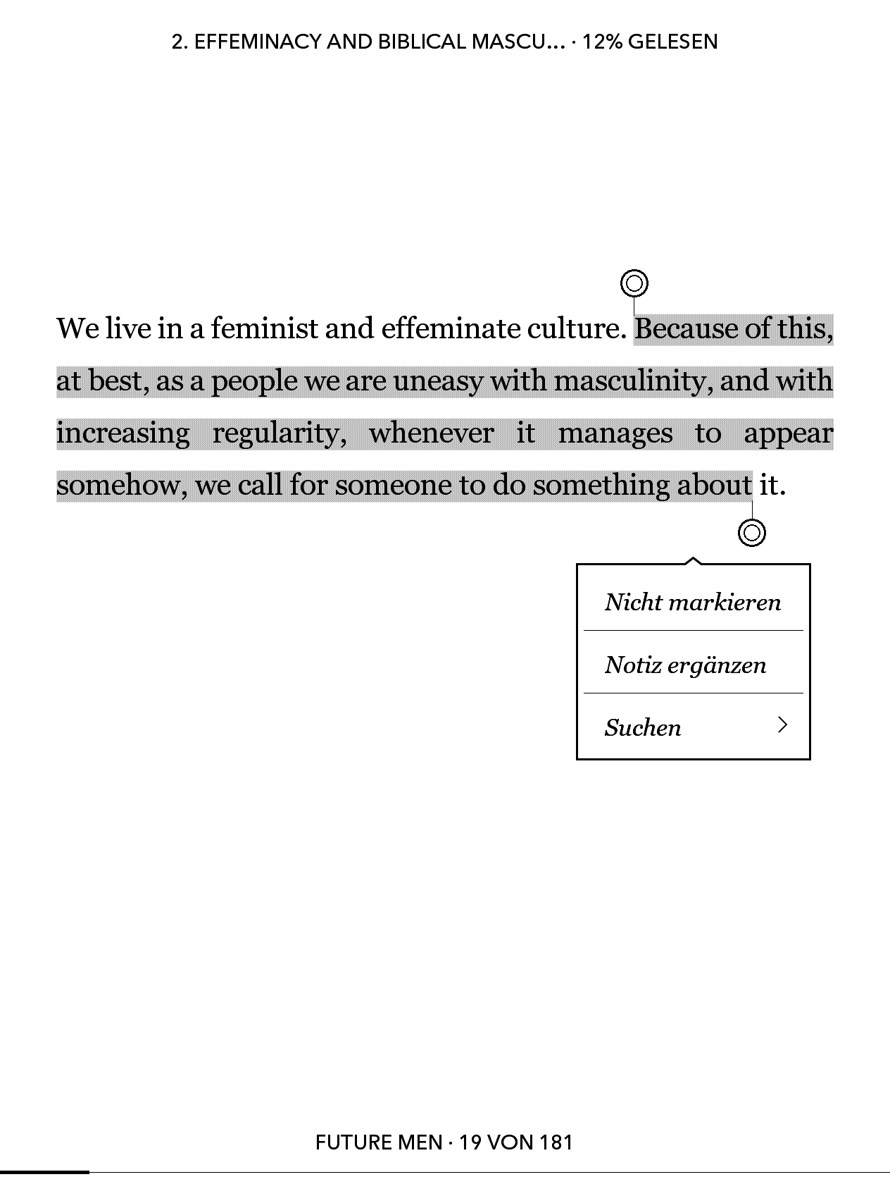

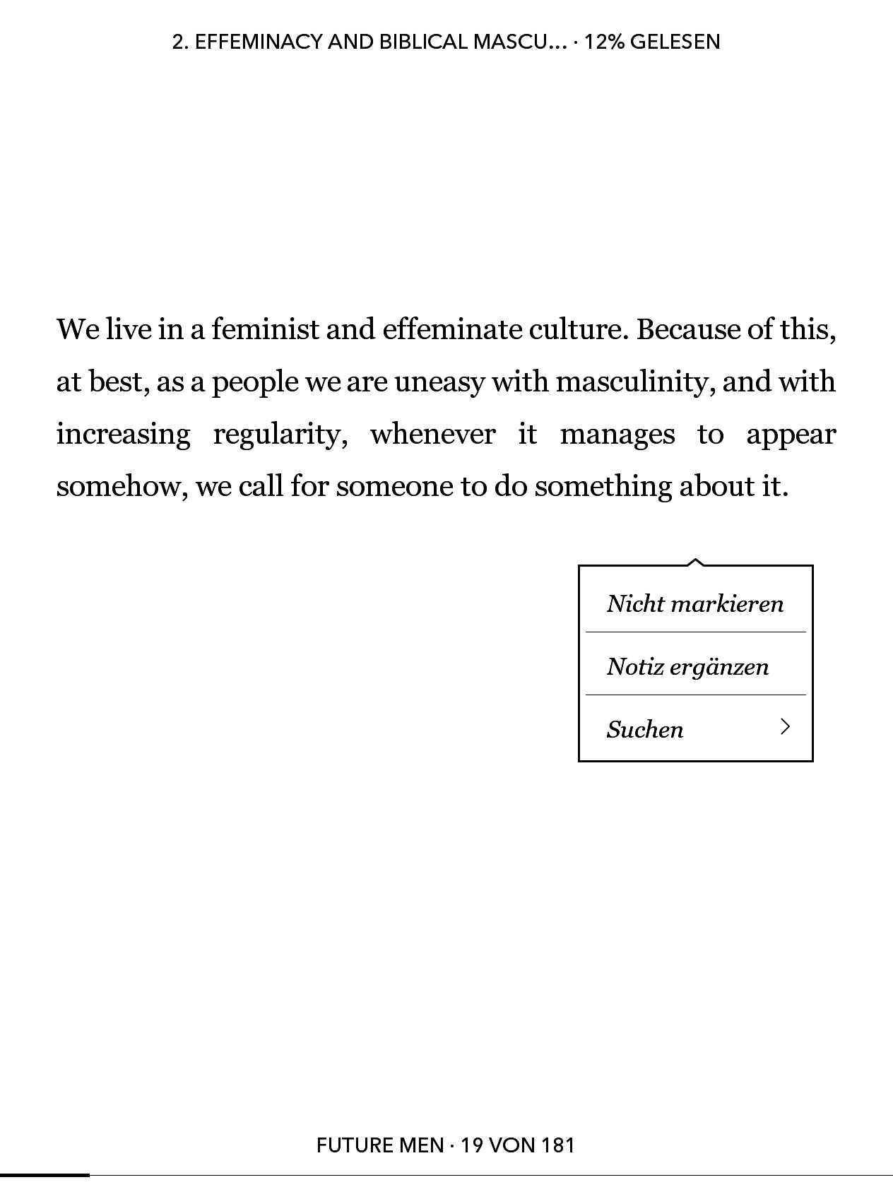

1. invisible marks: whenever I mark a sentence up to the end of a page, the marked part is no longer highlighted as such. Still the pop-up menu confirms that the marking has been done. And the notebook does the same. But why can't I see it?
Because there is a bug. And, I think a known long-standing bug. It isn't obvious from your test case, but, I think think that is a paragraph that is continued from the previous page. If so, the is a long-standing bug when the the last word in a paragraph that continues from the previous page, and there is only one punctuation mark, is involved in a selection. If you try to select that word itself, whatever action would happen if you had tapped that word will happen. It will page backwards or forwards, or show the menu, depending on exactly where the word is on the page. And for an selection that ends on this word it won't display.
It is a bug. If you want it fixed, report it to Kobo and tell them how important it is to you. Personally, I don't think it is very important as I don't hit it that often, and can work around it easily enough. And while I would like to see it fixed, I can think of other things I'd prefer them to do.

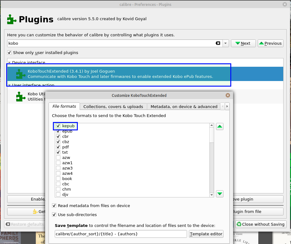

Thanks a lot for the help. I've just installed the 'KoboTouchExtended' plugin on Calibre which provides the EPUB to KEPUB.EPUB conversion on the fly while sending to Kobo device.
Now the highlighting support meets my expectations:
  • I can now highlight over page boundaries. Highlighting to Lower-Right corner will flip the page and I can continue my long highlight there.
  • Highlighting basically works faster and more responsive. Especially in larger books. In smaller books it seems equally fast with normal EPUBs.
Some other side effects were also fixed by this format change:
  • book covers are better rendered by default: all the thumbnail images of my book covers have now a good default size (before some were rendered way too small)
  • reading stats are available in the reader
