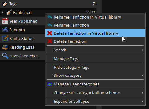

Name:	2020-11-23 22_05_47-calibre - __ My Books __ Fanfiction __.png
Oh no, my finger slipped and I accidentally clicked "Delete Fanfiction" instead of "Delete Fanfiction in virtual library!"

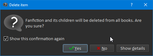

Name:	2020-11-23 22_04_30-Delete item.png
Never mind.

Originally Posted by Rellwood View Post
Are the VL so "solid" that I can make chages in the Tag manager and they will only affect the books in that libary, but not in the other ones?
Also, are the user catagories virtual libaries?
As long as you can put it into a search query, you can turn it into a virtual library.

Attachment 183552
Attachment 183551
Never mind.
Took me a minute to figure out what you were trying to tell me.
Now I understand what that "delete tag" and "delete tag in VL" means. LOL!
