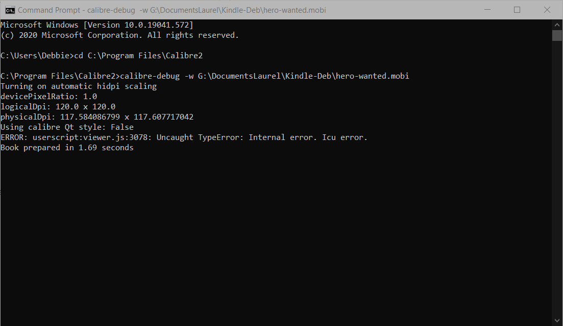

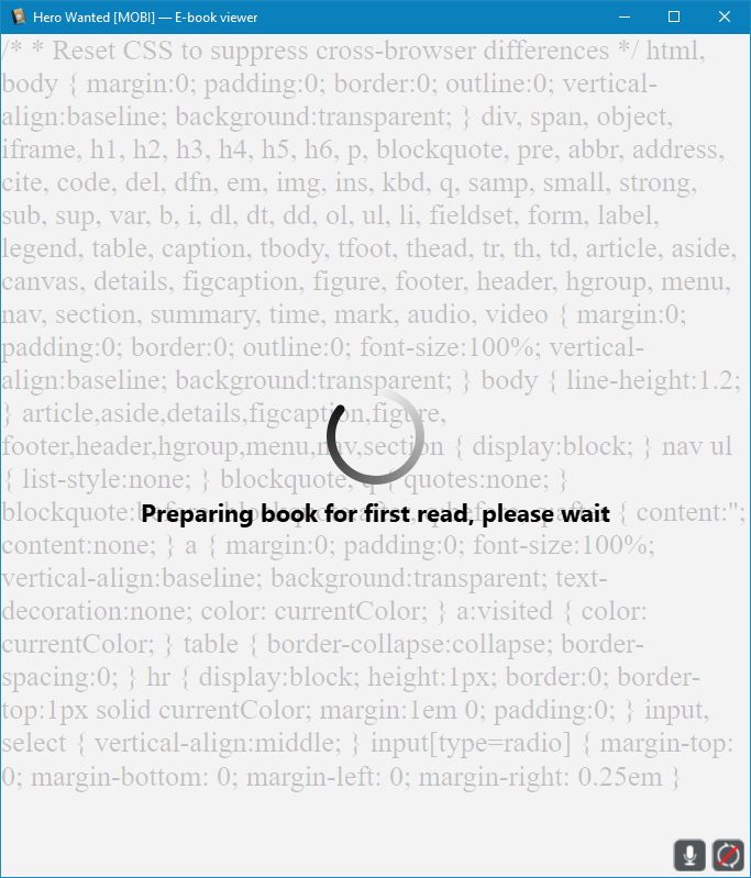

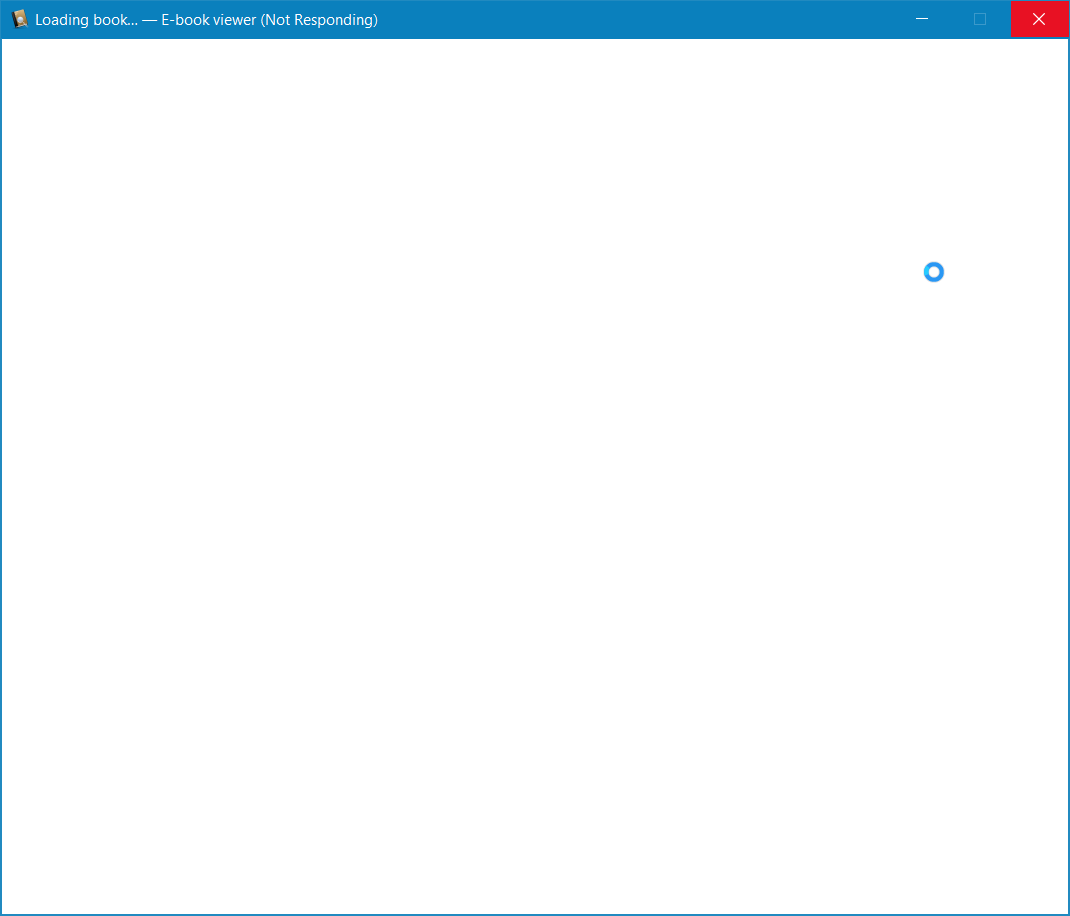

Recently my e-book viewer stopped working. I was running Calibre 5.4.2 and when I double click on a book, all I get is the window frame from the e-book viewer which says Loading book and Not Responding. After searching this forum, I tried running calibre from the command line
calibre-debug -w filename
I've attached screen shots of what I got.
Meanwhile, I discovered that Apprentice Alf plugin was not compatible with Calibre 5 so I switched back to 4.23. Tried the same experiments and got the same result.
I'm running Windows 10 Pro version 10.0.19041.
I use Bitdefender Total Security AV and I did look through all the logs to ensure that it wasn't blocking any calibre processes. I saw no evidence of that.
I'm not sure what to try next.

reboot in safe mode, check if it works there. If it does its your antivirus. The log you provided already tells me its a corrupted install (see th eline about the internal ICU error). If re-installing did not fix it it most likely means something on your computer is deleting/quarantining a file from the calibre isntallation folder.

I have 2 monitors. Using Windows built in "identify" feature, the one on the left is the primary (i.e. 1). The one on the right is secondary (i.e. 2).
If the Calibre window is on the secondary monitor, the ebook viewer will not open when I double click a book. If the Calibre window is on the primary (left) monitor, the viewer opens successfully.

i had the same issue and found that it depended on the setup of the second monitor.
if it was in 1920 x 1080 it worked fine.
if it was in 4k it refused to open.
this is with the --disable-gpu environtment variable set.
