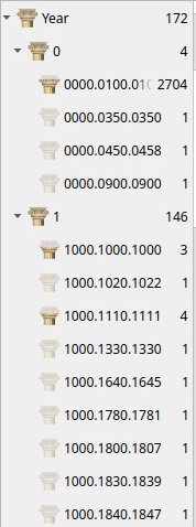

I found this fancier version grouped by decades:
{pubdate:'test($,
strcat(substr(format_date($,'yyyy'), 0, 1), '000.',substr(format_date($,'yyyy'), 0, 3), '0.',format_date($,'yyyy')),
'Unknown')'}
Tip: don't forget you can click twice on a node to see all that decade, century

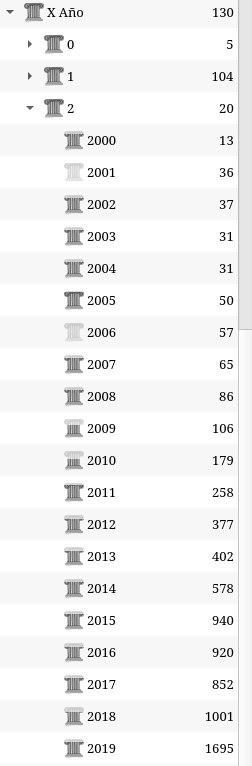

I do not have it so complete but it gives me the same result. We go to Preferences / Add Custom columns and create a column generated from another column and in the template add the formula described in the image. We accept and restart Calibre.
ID:	182458   Click image for larger version

Thanks for the suggestions , but so far, I can't get them to work .
uli's suggestion gives these weird "1000.1000.1000" sets? They seem to be grouped correctly, but the format is odd.
dunhill's suggestion gives me "Unknown Function".
I have version 5.0.1 running on the latest Ubuntu. Maybe there've been some changes?

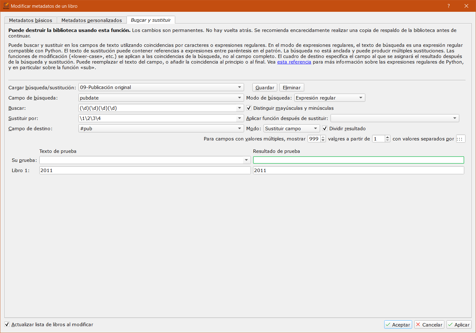

I have created a text column to have the year of the original publication.
In principle I fill it with the pubdate date, and then I correct it if necessary in cases like these:
Dates before our era: -150

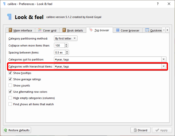

Forgot you need to set it to hierarchical, also I think you might need to remove partitions for that category.

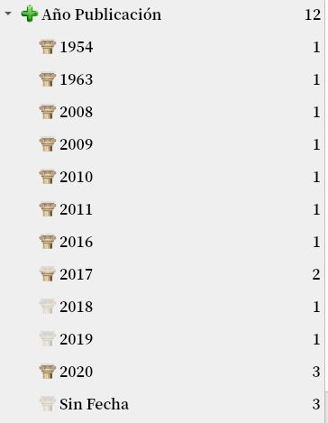

I have modified the syntax to my liking being like this.
{pubdate:'test($,
strcat(format_date($,'yyyy')),
'Dateless')'}

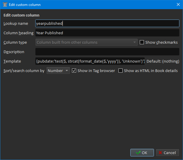

{pubdate:'test($,
'Dateless')'}
I liked the idea of years in the tag browser so I added this one as a custom column (though with 'unknown' instead of 'dateless').
Name:	2020-10-07 19_55_36-Edit custom column.png
However searching for #yearpublished:"=Unknown" just results in the search bar turning red even though there's 145 books. Did I make mistake?
Attachment 182538
Try #yearpublished:false
I think unknown is just a visual representation for a 'not set' field value
