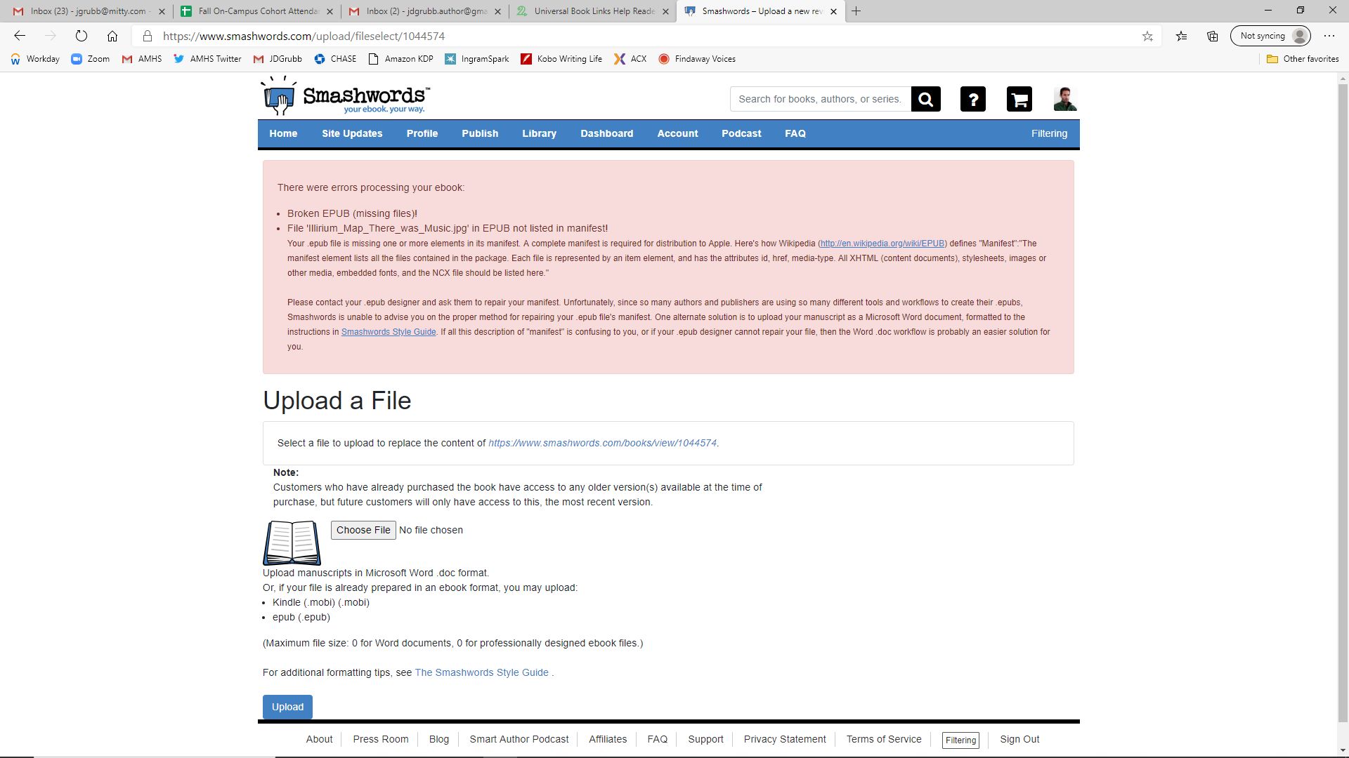

I keep getting an error message when I try to upload my EPUB file on Smashwords:
"File 'Illirium_Map_There_was_Music.jpg' in EPUB not listed in manifest! Your .epub file is missing one or more elements in its manifest. . . ."

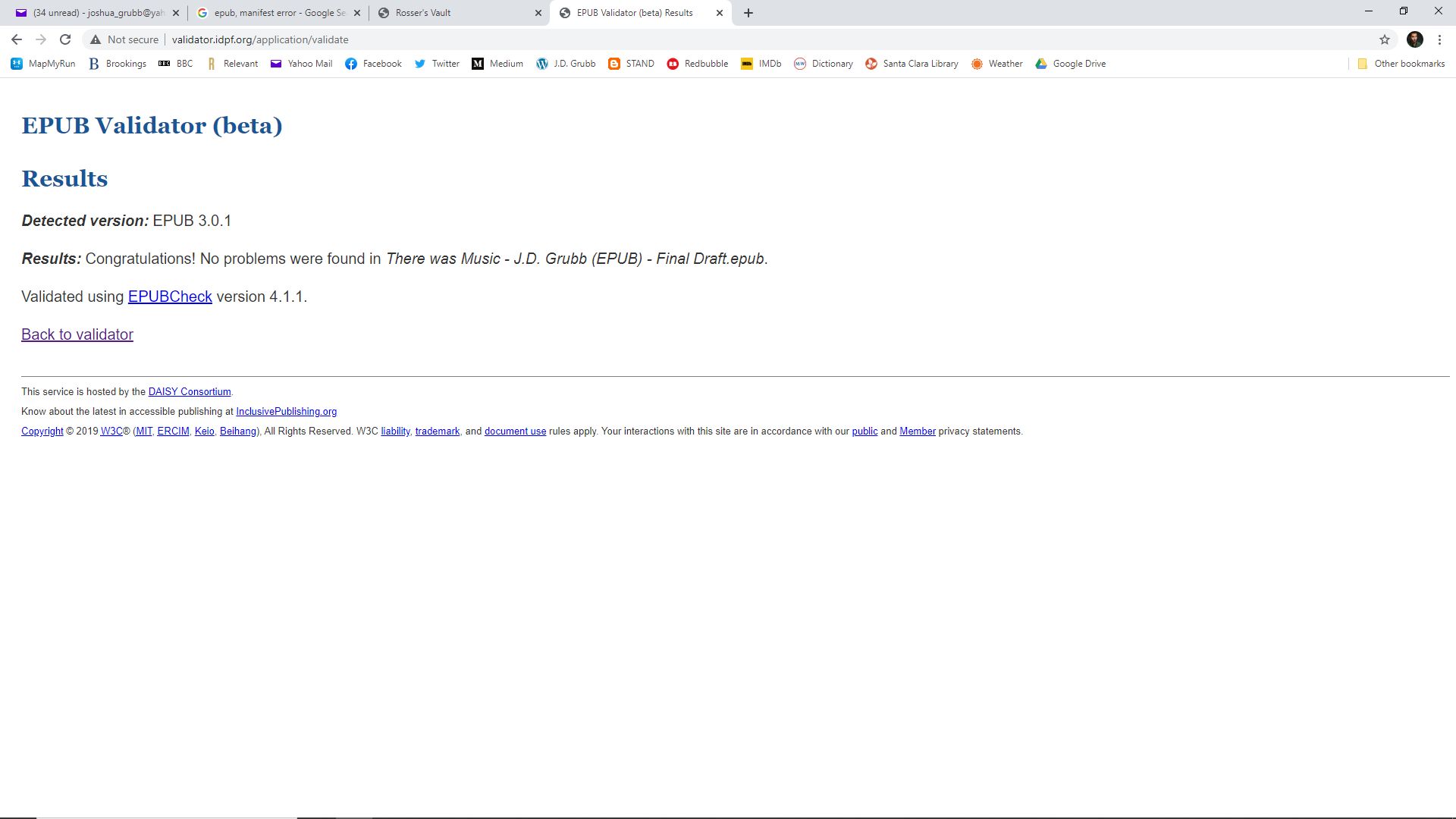

After extensive review, and scouring the internet for troubleshooting solutions, I cannot figure out how to resolve this. I have run the EPUB through another EPUB Validator, which finds no errors (see attached screenshot), and reviewed the manifest manually using Calibre (via the content.opf listing - see attached screenshot), which shows the image in question as part of the manifest - with consistent naming. Moreover, the files are clearly listed in the directory, and no other aggregator site has raised this problem with the exact same EPUB file.

I contacted the Smashword Service Team, and using my actual EPUB file, a member reviewed it with their tech team. He responded:
"I had our techies take a look at the EPUB and they suspect it's due to the formatting of the underlying HTML for that particular file in your EPUB manifest. Specifically, they suspect it's due to the "../" in the HTML for the file in question:
<item id="id1" href="../Illirium_Map_There_was_Music.jpg" media-type="image/jpeg"/>
By contrast, your other elements include the exact directories, e.g.:
<item id="image_cover" href="Images/d84614660b3bc605c904b4cb49ac72bc55c6934e_smallRaw. jpg" media-type="image/jpeg"/>
<item id="content_8_part-2-wilderness" href="Text/8_part-2-wilderness.xhtml" media-type="application/xhtml+xml"/>
Updating the href attribute to explicitly include the entire directory will likely fix the issue.

Inquiring further about this, the representative responded:
You'll need to move the image out of the root directory into the oebps directory, and update the link to the image everywhere it's used through out the book as well as the manifest.

If EPUBCheck didn't report any problems, it's definitely a SmashWords problem.

Thank you for your feedback. This was definitely the simplest approach (and worked). I suppose this suggests some quirk with Calibre; though, again, I had no problems with all the other aggregators (Amazon KDP, B&N, Kobo, etc.) using the ePUB file mildly edited using Calbre that had been flagged by Smashwords. Anyway, point to Sigil for helping this problem.
