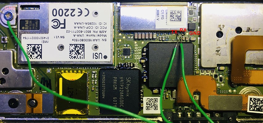

Step 2: R̶i̶p̶ ̶y̶o̶u̶r̶ ̶d̶e̶v̶i̶c̶e̶ ̶a̶p̶a̶r̶t̶ Open the back cover to access to the mainboard.
If you look closely in the lower right of the display connection port, you'll see 3 tiny round copper connectors which are Tx, Rx and GND. But wait, you need to disconnect the battery first.
Now wire these connectors with any USB TTL adapter that you have.
Kindle Tx --- Rx
Kindle Rx --- Tx
Kindle GND --- GND (you can also connect with the screw as I do)

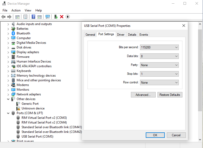

Step 3: Prepare the software
Connect to USB TTL adapter to computer.
Open Device Manager and set up variable like below

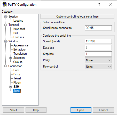

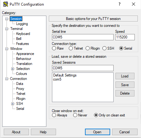

Open PuTYY and setup like this

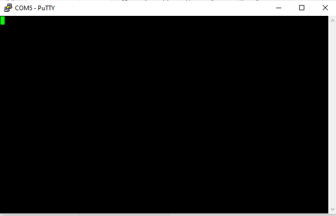

Then press Open, leave the blank window as it is

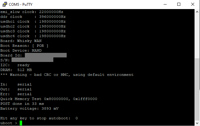

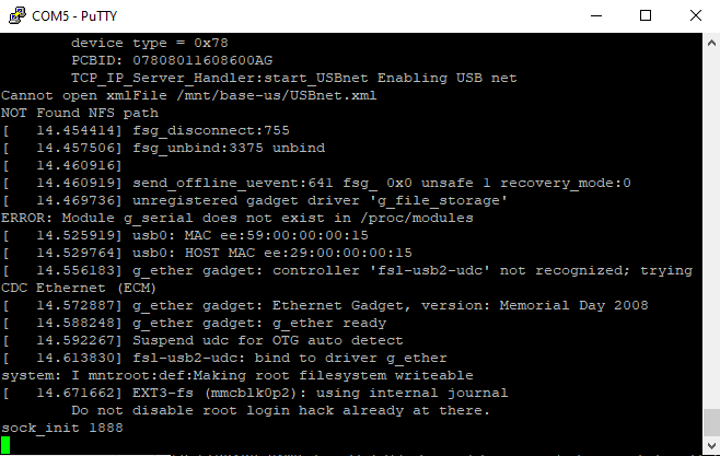

Step 4: Jailbreaking!
OK. This is important. As soon as you reconnect the battery, the blank PuTYY window above will begin to display some text. Please press any key quickly to interupt the normal boot and to access uboot.

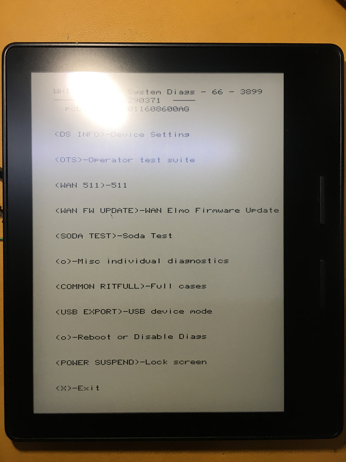

Now, input below code. It's quite different from original K5 instruction:
run bootcmd_FB
bootm 0xE41000

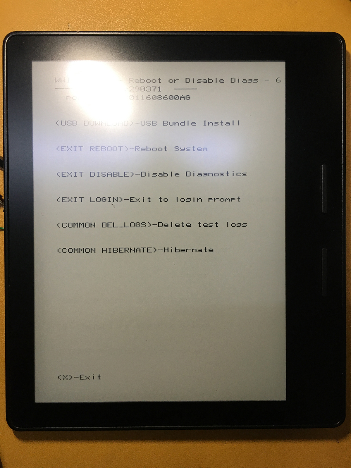

You're now access to the system diags:

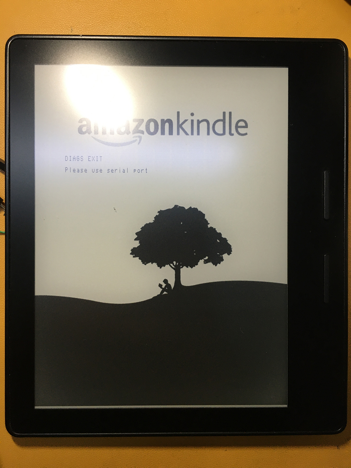

Back to your kindle screen.
Choose Reboot or Disable Diags
then
Exit to login prompt
On PuTYY screen, input username and password

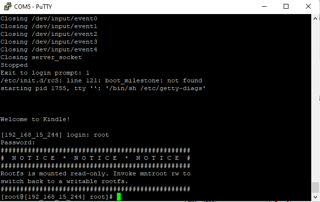

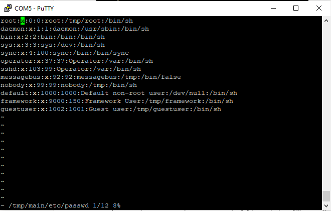

Edit the password file, input below code:
mkdir /tmp/main
mount /dev/mmcblk0p1 /tmp/main
vi /tmp/main/etc/passwd
on vi editor, use your arrow buttons to move the hightlight cursor to the character "x"
Press X to delete the x character
Input :w to save
Input :q! to quit vi editor
Input reboot to reboot kindle.

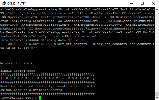

Let's the kindle fully boot to your familiar home screen.
On PuTTY windows, press Enter and login with root.
Input below commands to jailbreak:
cd /mnt/us
sh jb.sh
If you find the text ****JAILBREAK**** on your kindle screen,
Congratulation!

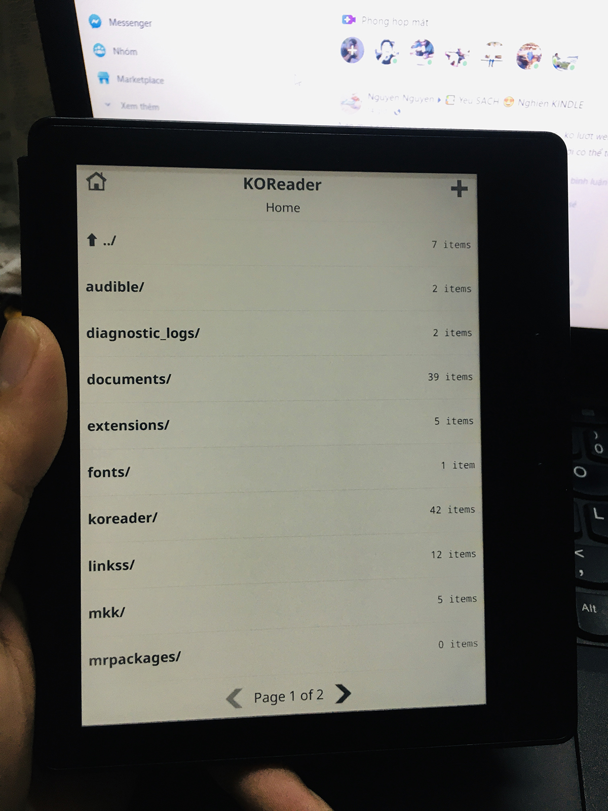

have you installed KoReader? if so how it performs?
It runs flawlessly

Show us some pictures please! Since you the first one maybe you just make fun of us because they say nobody found them and you just opened the back and boom
Bro, I don't ask you to follow my guide. You could do it, or not. That's up to you. You never know if you don't try, right?
Anyway, that's lucky for me that I have some pictures of the process to prove to this guy.
ID:	181454   Click image for larger version
ID:	181455   Click image for larger version
ID:	181456   Click image for larger version
