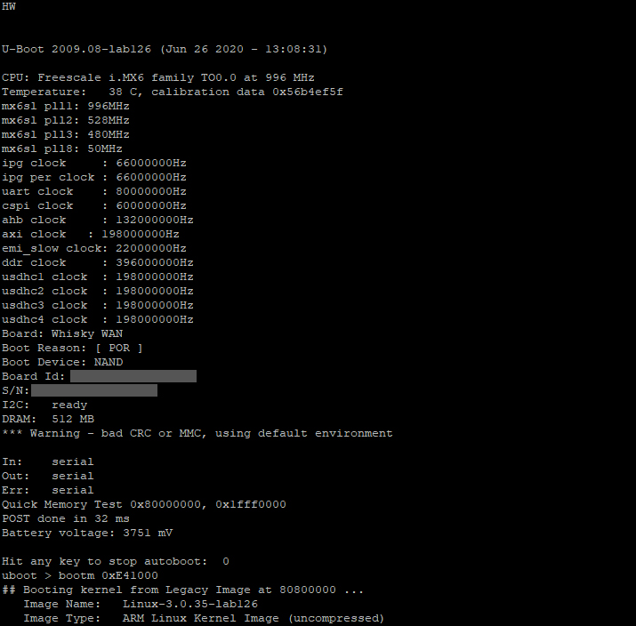

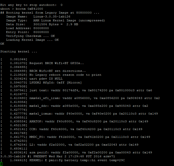

Question Serial Jailbreak Kindle Oasis 1 - Need help
Hi! After some experiments, I finally find out the serial port of Kindle Oasis 1 (Tx, Rx, and GND) as in the picture.
[IMG=853,400]https://www.mobileread.com/forums/attachment.php?attachmentid=181269&stc=1&d=1597236 967[/IMG]
I successfully access to uboot by connect with USB to TTL adapter.
But when I enter the code
bootm 0xE41000
to access diag mode, it stucks somewhere in loading kernel.
Could anyone have any idea?

Congratulations! You are the FIRST to locate the serial port on an Oasis model!
I would suggest you start looking at this thread for some guidance:
https://www.mobileread.com/forums/sh...d.php?t=267541
Hopefully it is applicable to your model as well. I have not had to do a serial jailbreak myself, so I have no personal experience to fall back on.

that's almost exactly what I did. The only difference was that instead of
bootm 0xE41000
I needed a different address (which I found by running getenv or something like that.
If you can't enter uboot check your tty settings (esp. flow contral and local echo and such)..
Good luck
