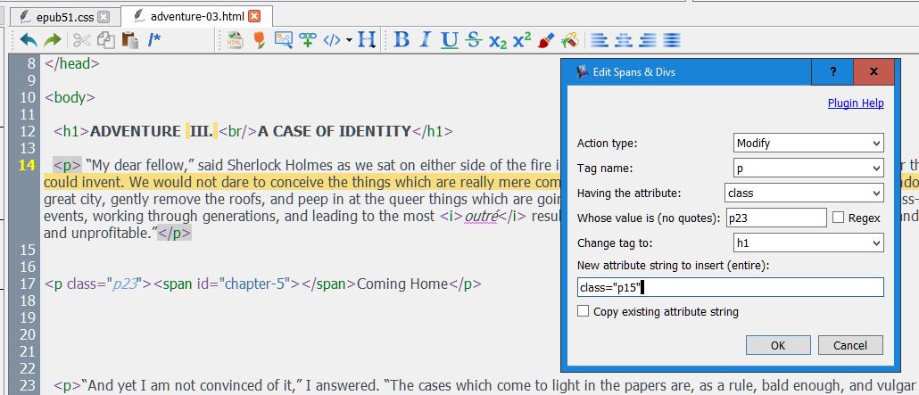

Originally Posted by AlwaysNew View Post
I've tried Diaps Plugin but it's a bit beyond me. Any help sincerely appreciated!
Thanks.
IMHO it's well worthwhile to learn Diaps PI -- I use it all the time and it's a lot easier that debugging some complicated RegEx
It's configurable so you can add additional tags
This does what you asked, but it you want to key off of the id="chapter.." it's a little more complicated
Result is
<h1 class="p15"><span id="chapter-5"></span>Coming Home</h1>

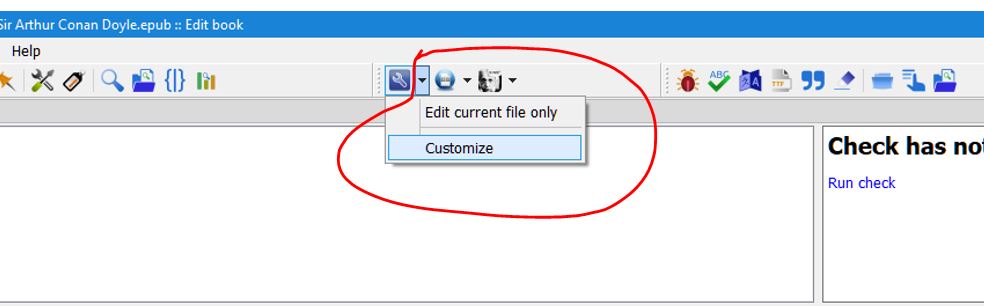

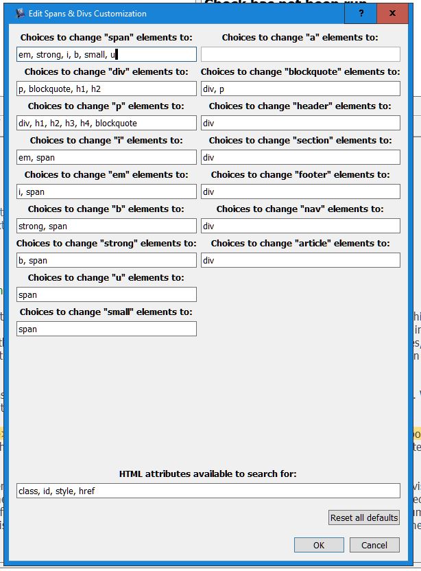

I appear to be missing something, How do you "configure" the plug-in. There is no option to do so and "Help" says it isn't configurable. Not only that back in the mists of time (2015) DiapDealer said he didn't want the PI to be able to swap tags in this way.
Does this involve some arcane tweaking of a file somewhere ?
I have long tried to use the plug-in to achieve the task of converting a classed "p" tag to a "h" tag and have always had to do it by regex. As I see it the only thing you can change a "p" to is a "div".
BobC

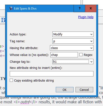

I normally just use the parameters screen to add additional tags, but IIRC I did have to one time tweak (VERY carefully) the file:
C:\Users\......\AppData\Roaming\calibre\plugins\diaps_editing_toolba
g_SpanDivEdit_settings.json
Don't recall exactly why, but I THINK it was because I wanted to modify a tag that wasn't in the original distribution
Been awhile since, once I had everything set, there hasn't been any reason to change
