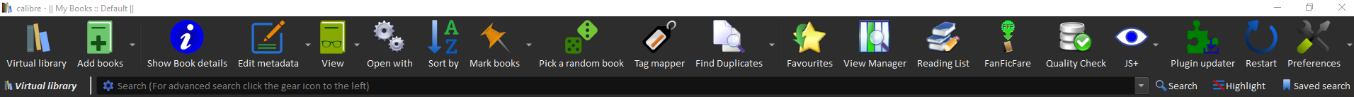

I have "Plugin Updater" as a button on my main toolbar:
Name:	2020-06-30 15_35_17-calibre - __ My Books __ Default __.png
Normally all the toolbar buttons fit on-screen. But when one of my plugins needs updating (the icon turns to an exclamation point when this happens), the Preferences button at the end of the toolbar gets pushed off-screen. (Sadly, I didn't think to take a screenshot.)
Why does this happen?

Two questions: 1) are you certain it's the Plugin Updater icon change that makes it happen, or is it perhaps when a device is attached and another icon appears? 2) Does it actually push the Preferences button "off screen" where you can't access it at all, or is it the standard toolbar overflow situation happening (where a chevron appears to allow you to access the buttons that won't fit in space allotted)?

I used to use the two-line text, but then that left a lot of empty space in the toolbar so I switched it back to single-line.
I didn't have a device attached. The Preferences button got pushed down into the overflow area.

Then it must be a matter of the exclamation point icon being marginally wider than the normal Plugin Updater icon. Which is then just enough to trigger the overflow. Either that or the text of the Plugin Updater button also changes (when there's an update) and triggers the same situation.
Yep. The text changes from "Plugin updates" to "Plugin updates*" The extra character is probably just enough to shift things far enough to overflow.

That would make sense. I never noticed the asterisk.
