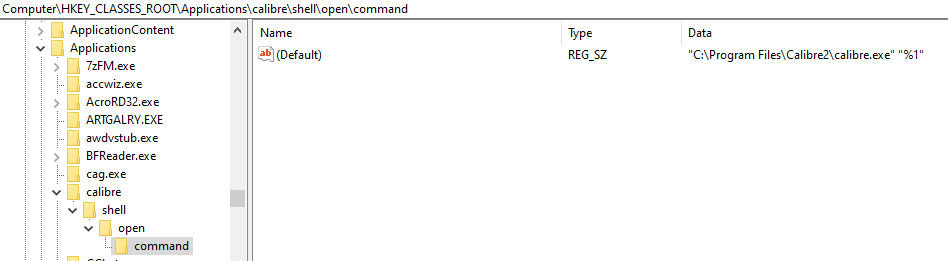

One possibility is that in your registry the calibre entry in HKCR\Applications is not correct. If you open regedit and look in HKCR\Applications, is there a calibre entry? If so does it have shell => open =>command under it? In command, is the default set to "C:\Program Files (x86)\Calibre2\calibre.exe\" "%1" (I added the (X86) for a 32 bit program on a 64 bit system).
Windows Registry Editor Version 5.00
[HKEY_CLASSES_ROOT\Applications\calibre]
[HKEY_CLASSES_ROOT\Applications\calibre\shell]
[HKEY_CLASSES_ROOT\Applications\calibre\shell\open]
[HKEY_CLASSES_ROOT\Applications\calibre\shell\open\command]
@="\"C:\\Program Files (x86)\\Calibre2\\calibre.exe\" \"%1\""
I've attached an image of what that entry looks like on my computer. If you save the text in the code box to a .reg file (calibre_app.reg, for instance) and double click on it, it should add the needed bits to the registry for you.

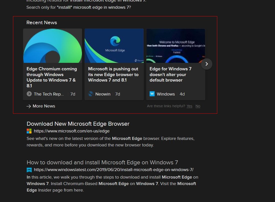

Name:	Annotation 2020-06-27 103559.jpg
I've been assuming the things at the top were ads, I just told DDG to get rid of the images
IMO pushing non security items to EOL'd versions is a moral breach of contract, if I was still running 7 I'd turn Windows Update off and use a 3rd party AV or none.
If it was the EdgeHTML based version - the one the handled epubs rather nicely - It might be worth having Edge on Win 7, otherwise why would anyone want the Chromium Edge, might as well have Chrome.
