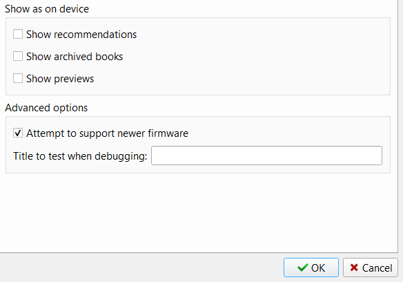

I'd recommend that you update your version of calibre. 4.19.0 is the current version. If you don't want to update calibre, you should follow the instructions in the message you quoted and check the Attempt to support newer firmware box on the Metadata, on device &advanced tab in the KoboTouch driver configuration. See attached image.

i updated the kobo glo back to the latest version. web browser works again.
i enabled 'attempt to support newer firmware,' and it can now send .epub's to the device.
thanks!
