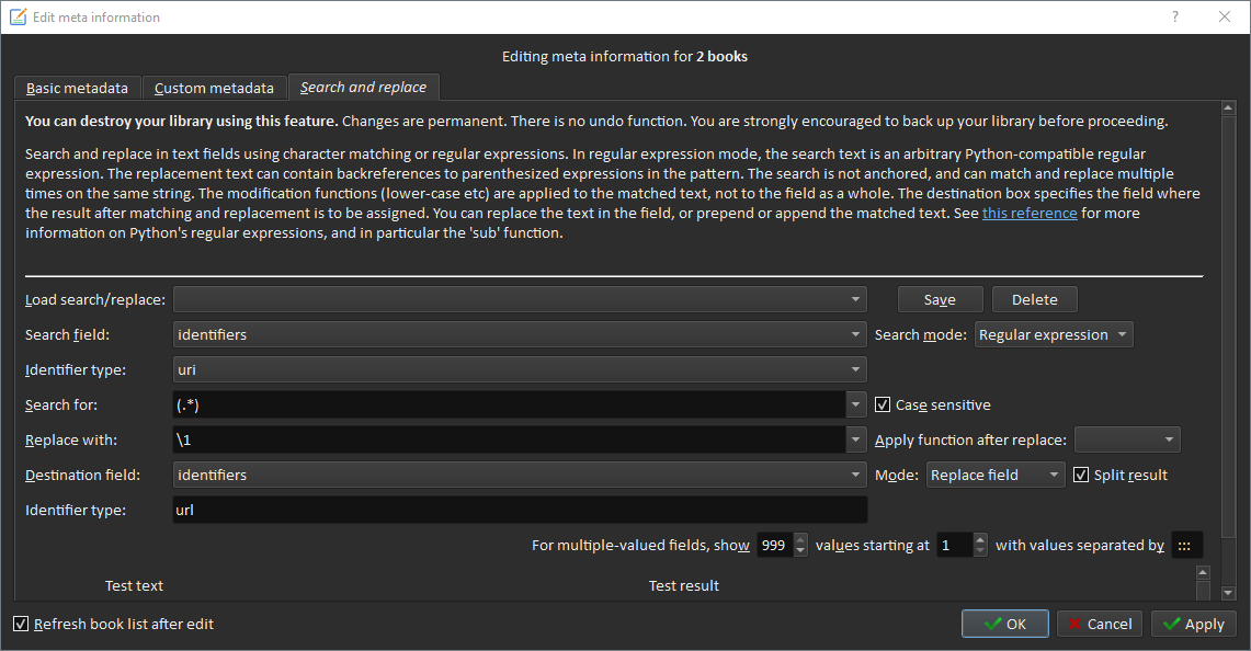

In case there was a mistake of how I inserted the fields, here's a screenshot my attempt to do it on a few duplicated test books.

Your example works for me. What problem are you having?
Note that the process you used will copy the URI identifier to a URL identifier. It does not delete the URI one. You end up with both.

I got it working now. The identifier window is a little small (I use "all-on-1-tab" view) so I didn't see the new url appended to the end.

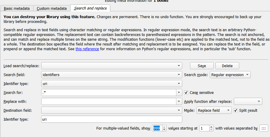

If you want to delete the URI identifiers, use this.
Name:	Annotation 2020-06-17 191509.png
