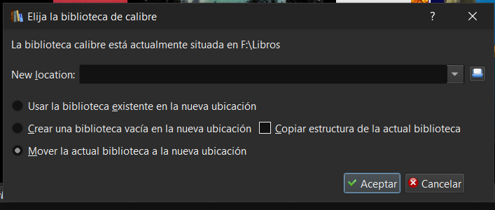

In the library icon options:
Move the current library to the new location.
That would have been the best option

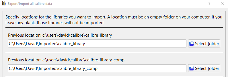

From what the OP has in the first post, it sounds as if the calibre import/export library tool was used. From the sound of it, parts 25, 26 and 31 of the export file set are corrupted. I don't know if there is any tool that can recover whatever data is recoverable from those spanned archives.
When I did a test export/import, I got a popup asking where I should store each of the imported libraries. I had to create the base folder and the folders where the individual libaries would be stored before I could select them using the Select folder tool.
