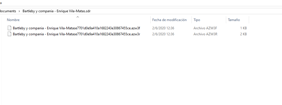

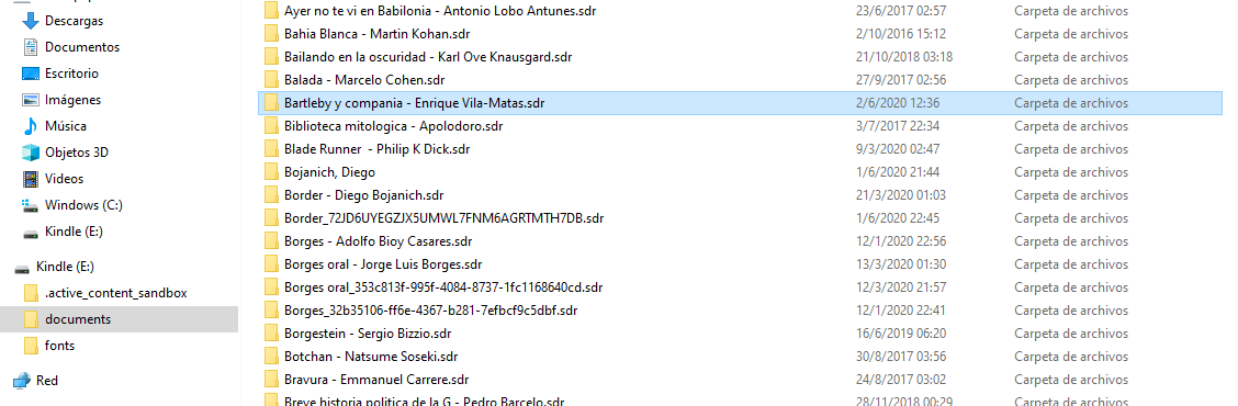

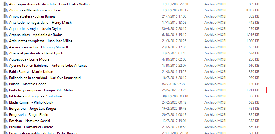

One thing I've just noticed about those files I downloaded as .mobi and show both covers *and* custom fonts, it's that they somehow generated two .azw3r and .azw3f (sic) files inside their own folder.
Let me see if I can show you...

Originally Posted by NoRightNoWrong View Post
Hi!
I've tried transfering files through Calibre, but the result is the same: cover photos go blank within seconds.
Then other possibility is that your ebooks have an ASIN in the metadata, and so the kindle is trying to pull the cover image from Amazon's servers. If the ASIN isn't valid, that might exaplain the blank cover.
(The fonts thing is simple - original MOBI format and they won't work, AZW3 (also known as KF8) or the dual format and they will work.)
