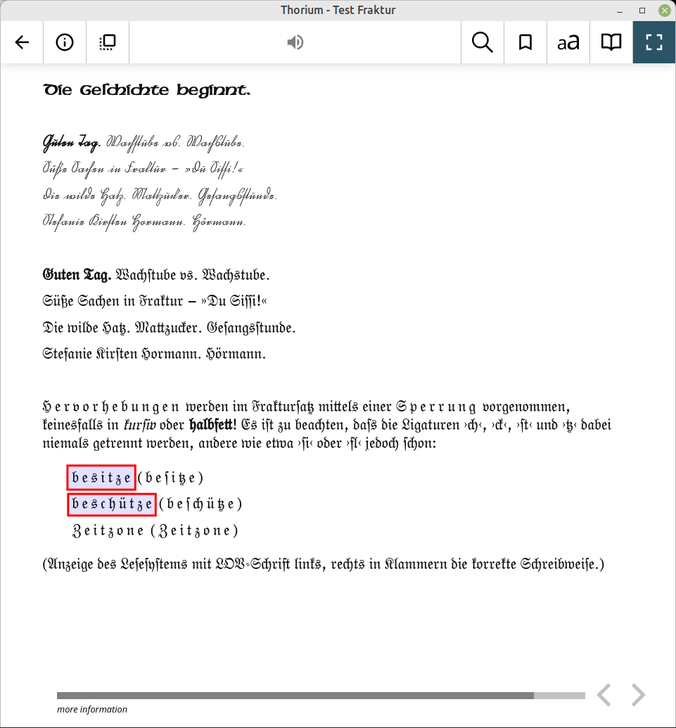

Cheers for the reminder, totally forgot about that page. Playing around, I promptly found a bug (I suppose it is with the LOV fonts, but not 100% sure): The "automatic" doesn’t cope with spacing correctly (check marked words, correct typesetting in parenthesis).
Tested this using Calibre Reader 5.34, Thorium 1.8.0, Foliate 2.6.4.
Test EPUB included, just in case someone wants to try. (Needs "publisher’s settings" or at least "publisher font" to render correctly.) See also my post in the E-Reader Forum (German).
