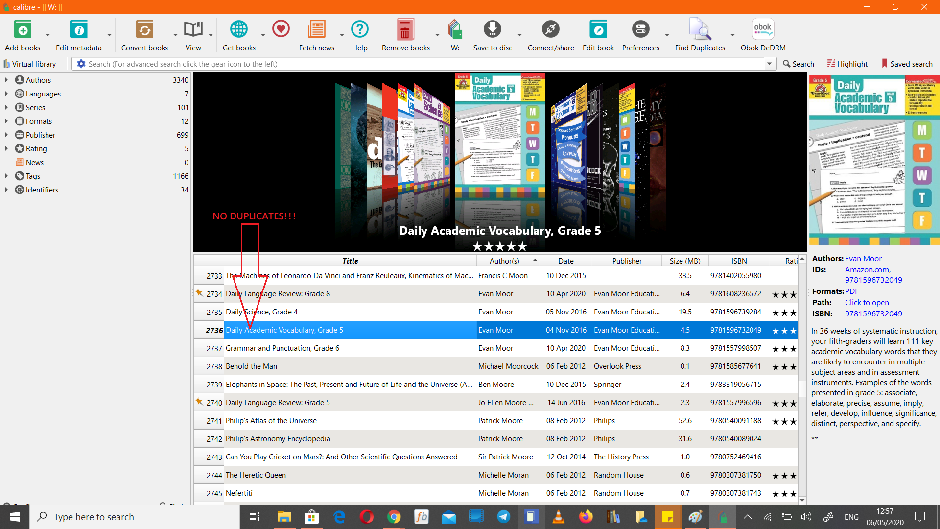

Hi
I have a home network set-up wherein I have a windows PC serving as a media/ document server, which I connect through with my laptop etc. On the media server, I host my Calibre Library, which has in total 5060 books (some with multiple formats; making the actual file count to around 6000; collected over a 9 year period, some of which are rare books). I do not run a document server, but rather connect to the calibre library remotely (always ONLY a single instance running) on my laptop; and add books manually through the calibre interface.
The issue I am facing is this- that for EVERY single book in my library, even after removing duplicates from the Calibre UI; I have got a duplicate directory with all the 3 files- cover.jpg; .opf and the ebook itself.
I can't fathom how to correct this; and more importantly, ensure that the problem doesn't recur in future.
Any help towards this would be a great help, people.
many thanks in advance
regards
C

with screenshots attached
have attached the screens for better reference to the problem.

yup, I know it.. unfortunately the constraint that I have got is this (am unsure if it is really a constraint) - my desktop media server is located in a basement multimedia room with all other stuff like Sky tv, xbox, av receiver etc.) and I rarely actually use it to upload/add books into Calibre.. My search and addition of books happen on the laptop; and so does my reading (on phone or Kindle; where I download it through the laptop-based instance of Calibre) . . I am not sure if I could do that on the content server set-up (not an expert).. I did, however, I know that as long as I am not running two calibre instances off the same library, it wouldn't cause issues.
The thing is, all seemed/worked well for last 8+ years- on the investigation of the modified dates of these duplicated, I can see the problem began happening only from Jan 2020.
Net net- is there a straightforward way for me to resolve this situation? Would the Move/Create New Library help here? And does that actually move the files on a different place on the HDD? or just "tags" the files with a new calibre metadata file?
regards
