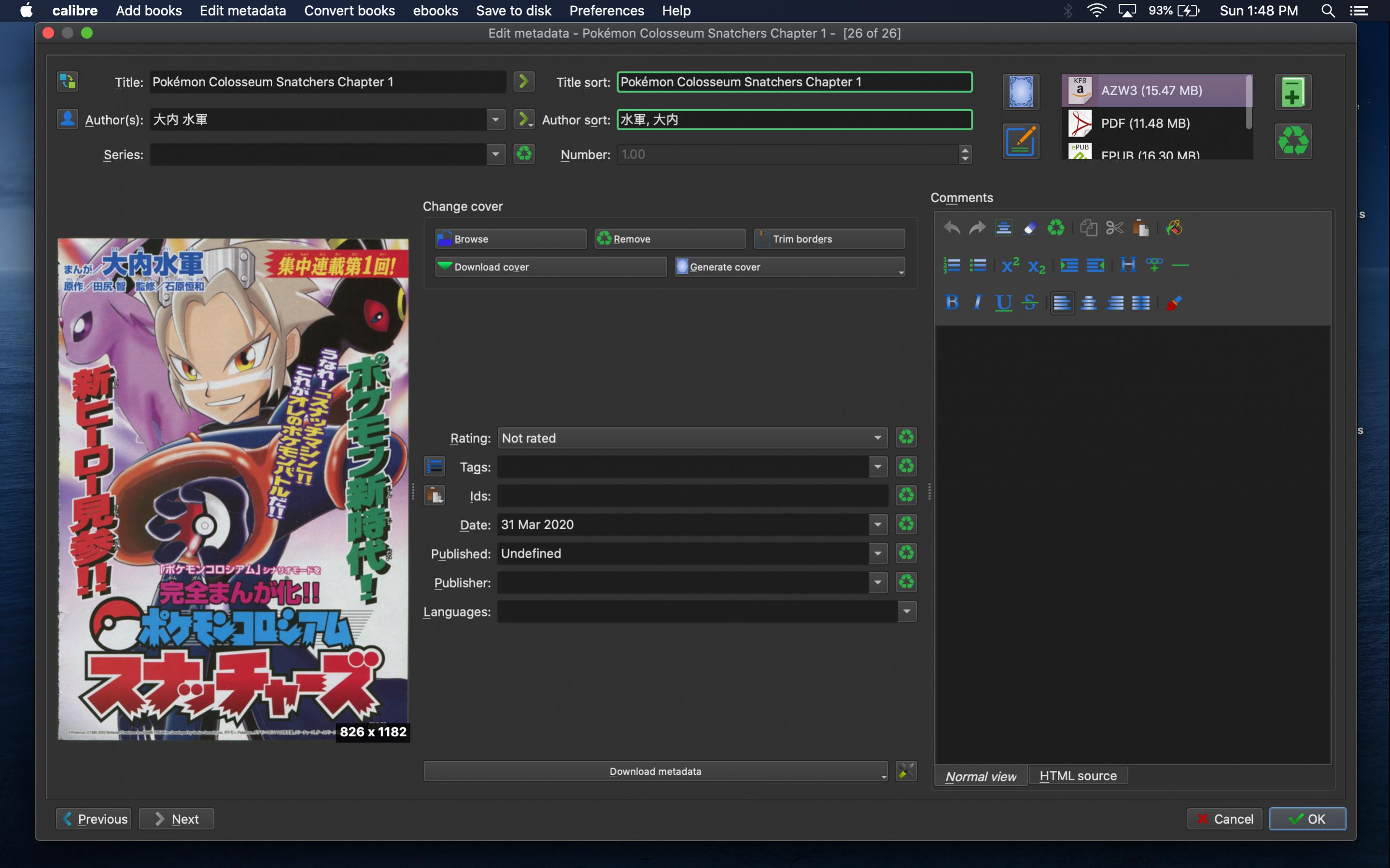

Thank you for taking the time to respond! When I open the metadata edit screen, this is what I am greeted with:
Where do I go to add this line?
Thank you again.

Originally Posted by GarbageGhost View Post
Please help point out my error?
Your image shows the primary-writing mode being set to horizontal-lr. It needs to be horizontal-rl instead. ("rl" means right-to-left in this case.)
Shoot, that is my bad. I attached the wrong screenshot. This should be the correct one. It still reads from left to right with the following line. Thank you for your continued patience.

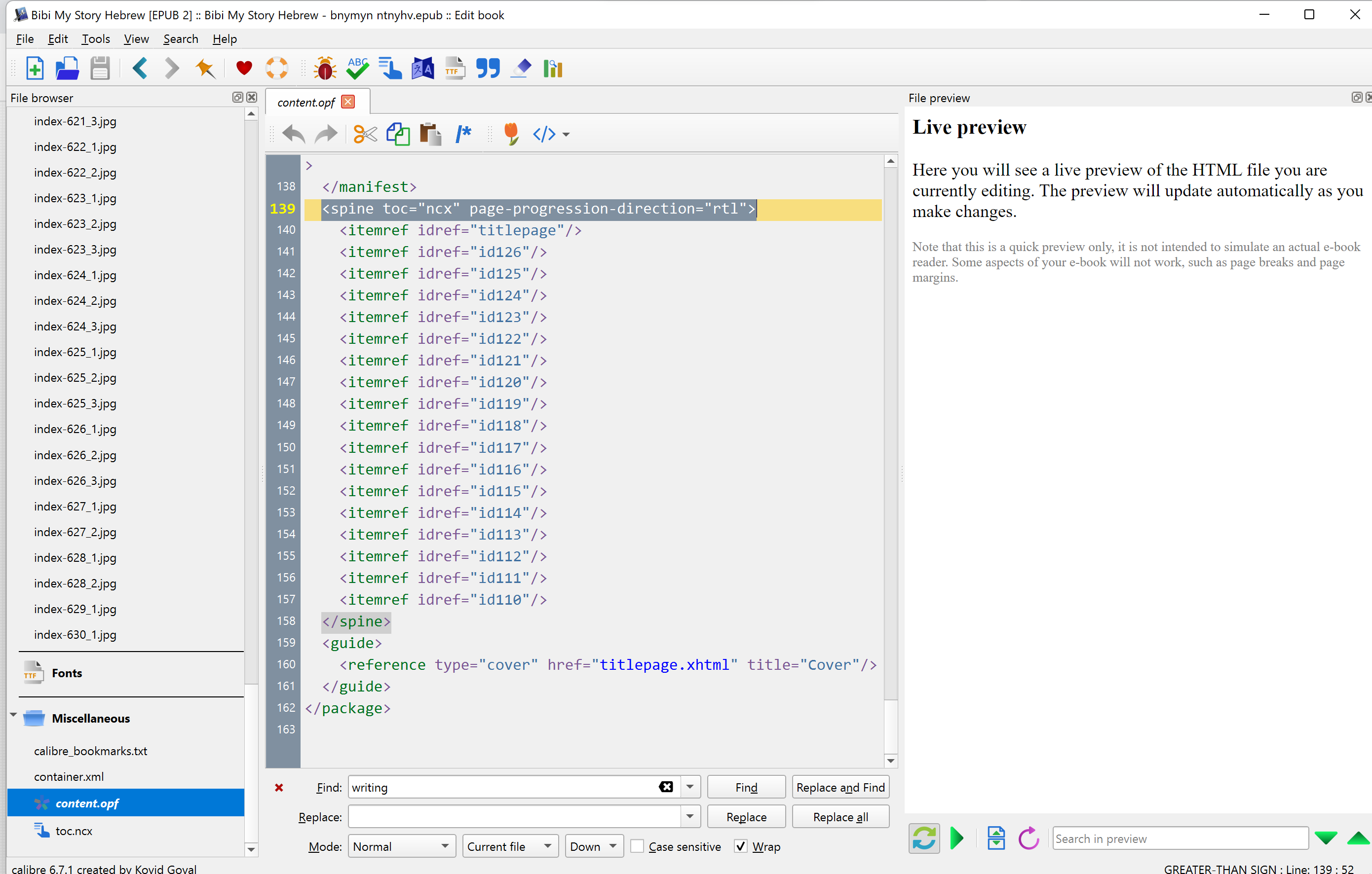

Hi, Thanks for helping here.
im trying to work with a hebrew text which goes from right to left.
i followed the instructions on the thread and in the OPF file i changed the following:
<spine toc="ncx" page-progression-direction="rtl">
it didnt seem to work for me.
please see screenshot below.
Thank you!
  1. What exactly is your problem?
  2. Do all <html> or <body> tags have dir="rtl" attributes?
    For example: <html dir="rtl" lang="he">

Im trying to have the text to show from right to left.
In addition the text is revesible, Every single word is spelled backwards.
is there a way to change it?
