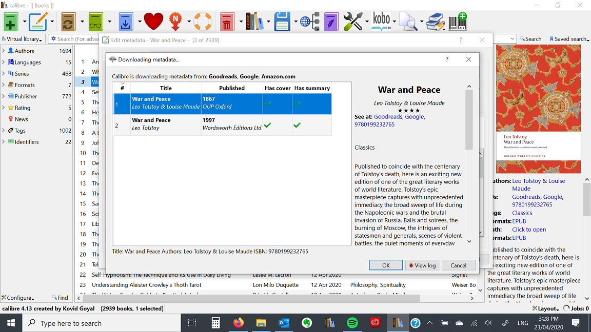

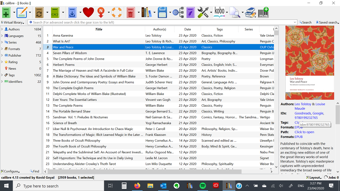

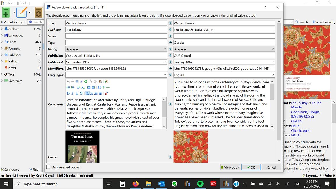

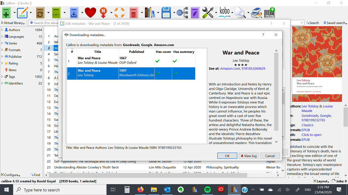

I noticed the (CTRL + D) match is the second ISBN match from the manual search. Here are some screens...
ID:	178633   Click image for larger version
ID:	178634   Click image for larger version
ID:	178635   Click image for larger version
ID:	178636   Click image for larger version

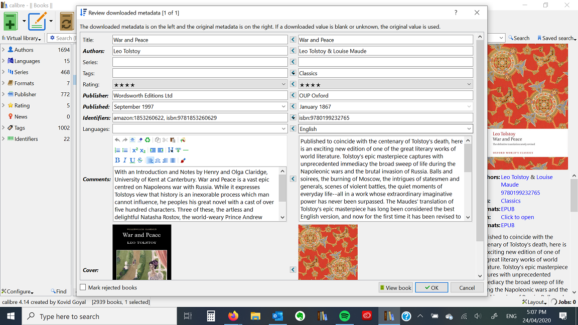

removed non-ISBN IDs before search... still same incorrect result
