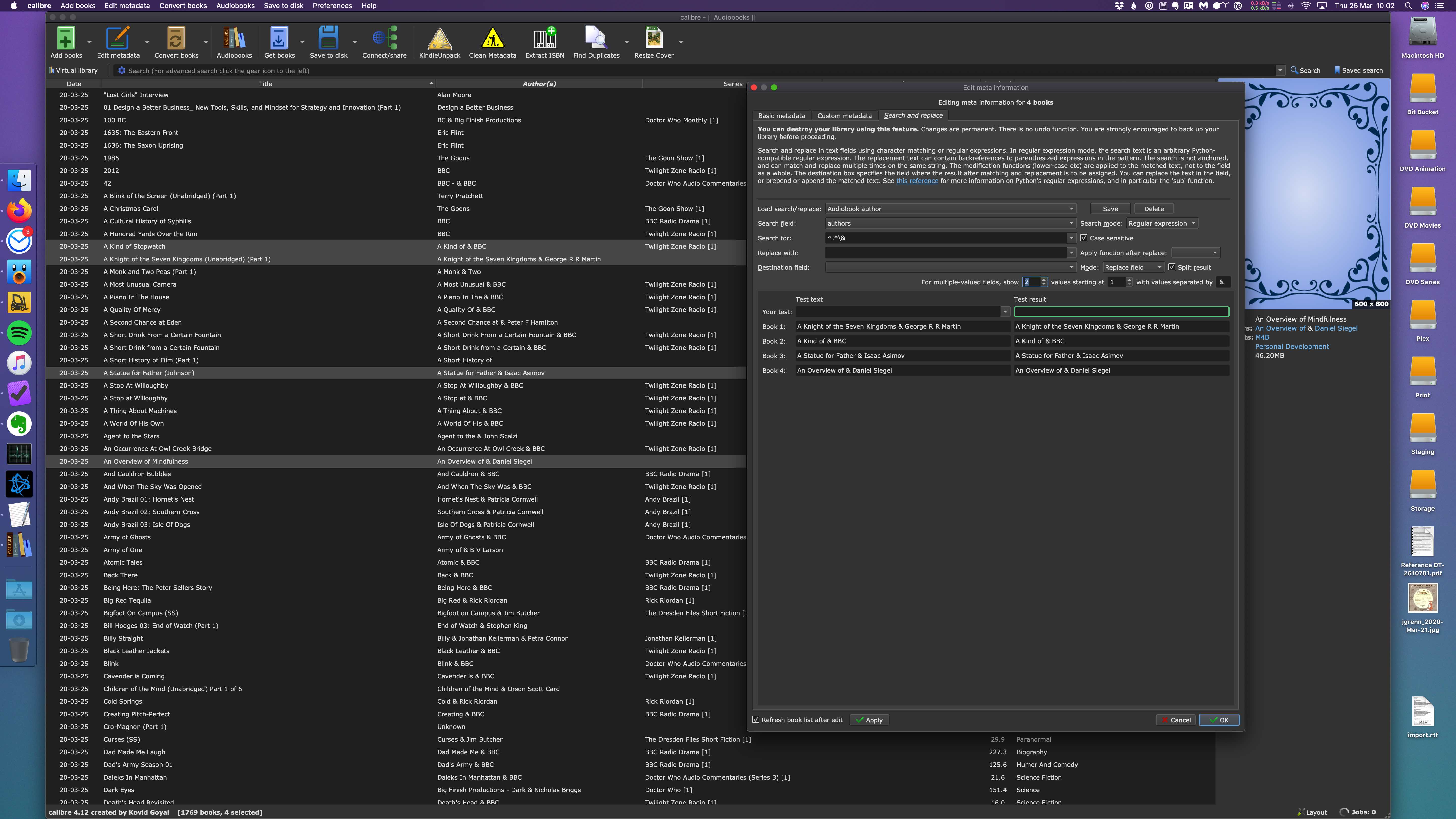

Here's a screenshot of where I stand, showing the situation on the main screen, with what I get on the Search & Replace. I can isolate either the correct value or the incorrect value from the authors field and have it show up in the right-hand column of the Test Result section, but it doesn't seem to write correctly.
I suspect that's because there's nothing in the Replace With dialogue field.
What I would like is to have the incorrect value show up on the left (I can achieve that) and nothing on the right, meaning that the icorrect value would be replaced with NULL. (YEs, I tried a space but that didn't work either.)
I guess what I'm asking, in a nutshell, is how do I delete a numbered member of a multi-value field?

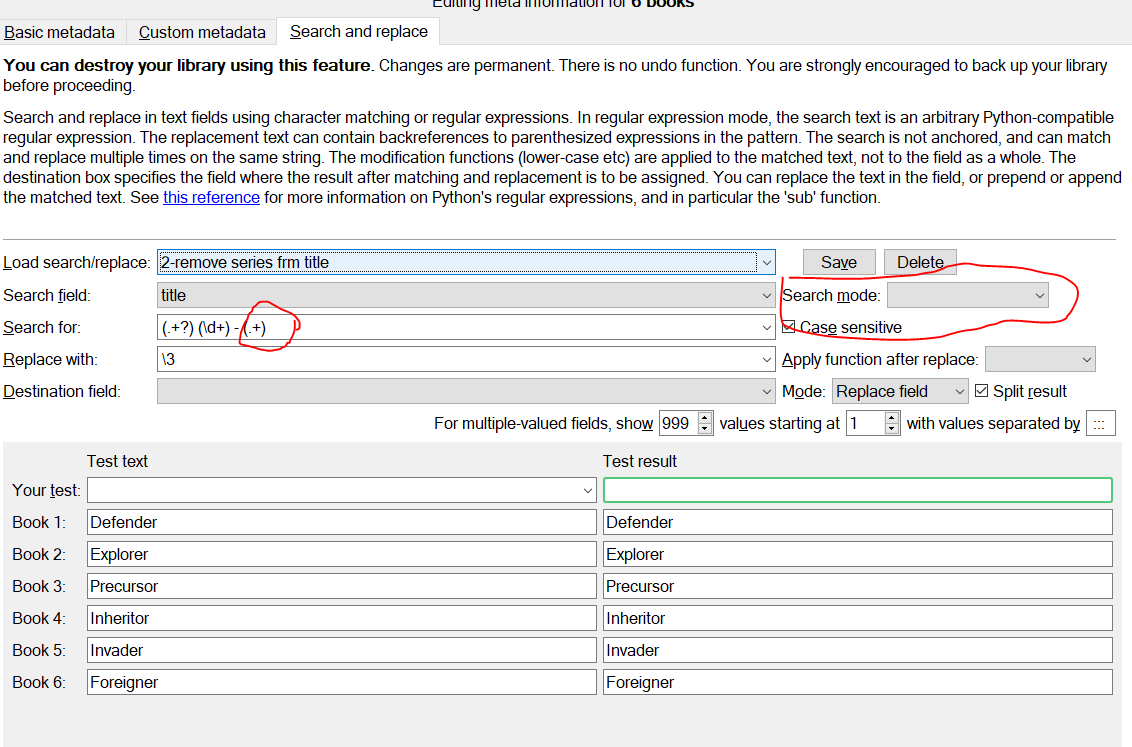

You need to a capture portion
I use REGEX mode (the saved search in my Example, did not have it set)
The original was: TheSeries 1 - title
There are 3 sets of captures (this one is for Title portion Only)
DO the Source field (Title) LAST as that replace deletes the other field values
Title is the 3rd capture, thus the \3
If you were populating Series, the destination would be Series and the value \1
then you populate the Series Index and the replace value is \2
I never could get Series to work as a single step
Does this help get you going?
