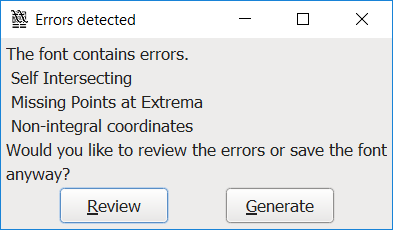

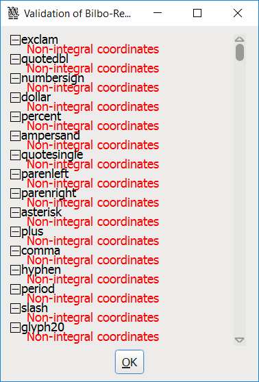

I did try just the straight-forward Element->Style->Change Weight, and then Generate Font. I got error/warning messages (see attached pics).
If I set the weight too heavy, I would get message that the generation Failed. When I cut down to setting of 25 or less, it still gave the warnings, but DID generate finally.
My question now is, will there be any problems using this font even though it has those errors?

Originally Posted by GrannyGrump View Post
Thank you, Jon --- have some chocolate-chip cookies! Or would you rather gingersnaps?
I will have to do some fiddling with that. Maybe I will get better results than with FF by itself.
If I set the weight too heavy, I would get message that the generation Failed. When I cut down to setting of 25 or less, it still gave the warnings, but DID generate finally. My question now is, will there be any problems using this font even though it has those errors?
I was playing around with Font Forge not too long ago and would often get those errors in your first screen capture. My memory was that the fonts still appeared to work. I don't remember exactly what I was doing but it was probably converting between different font file formats.

@hobnail -- good to know. I will take a chance on embedding this font (only for chapter heads, anyway, so no huge hit if it falls back to the user's choice).

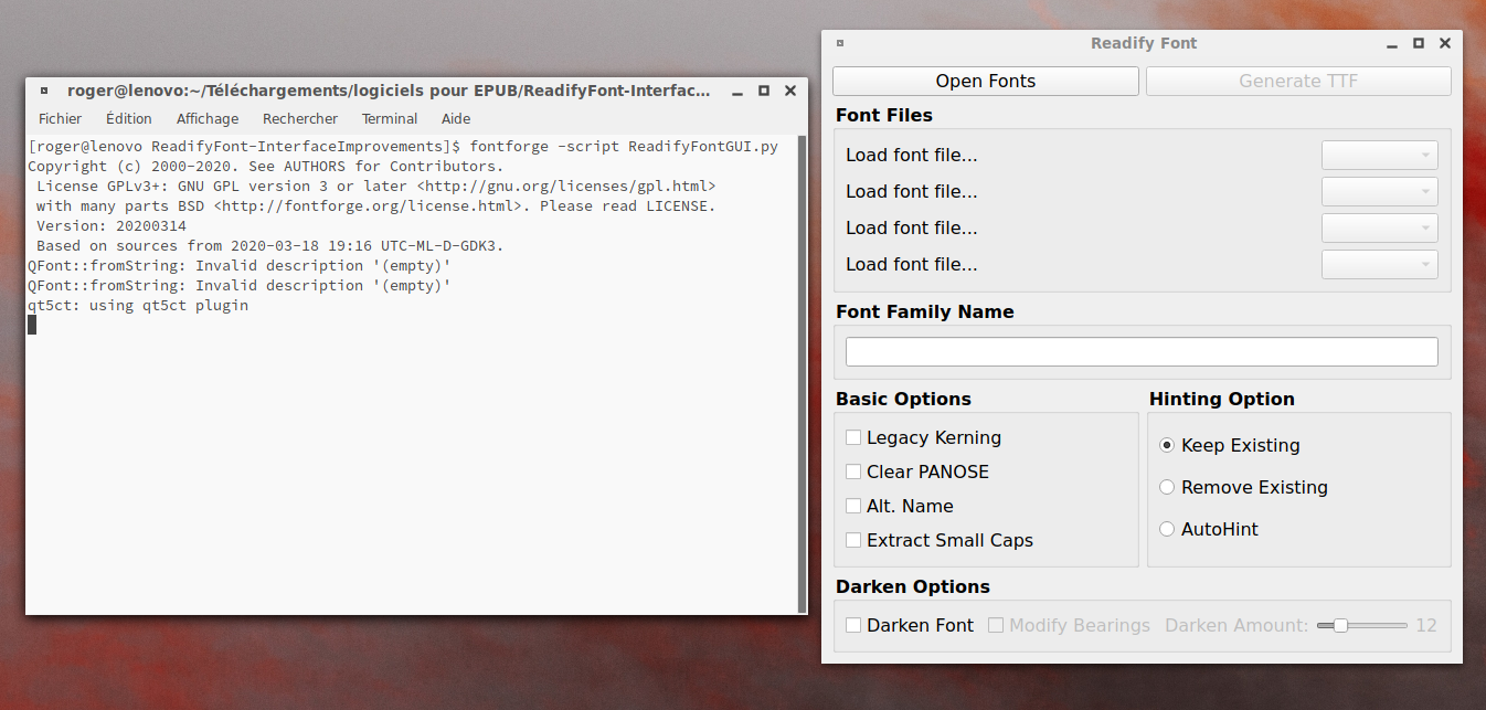

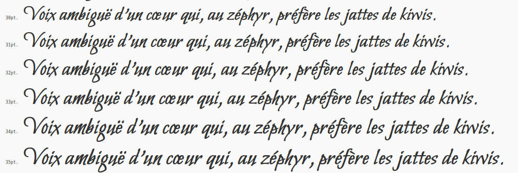

hi
This is what I obtained in three minutes to darken (value 25) the Bilbo swash using fontforge and the script ReadifyGUI.py
I renamed the darkened font adding a g to its original name
Old 03-24-2020, 09:54 PM   #13
GrannyGrump
Obsessively Dedicated...
GrannyGrump's Avatar
Posts: 3,239
Karma: 35158061
Join Date: May 2011
@roger -- Whee! Thank you!! It looks very good in my font manager. I will have to try it out by embedding -- I know it will look great.
I am thinking now of all the fonts I passed by in the past, because they were too thin and light for e-reading. I will absolutely have to get familiar with that script you posted about.
Thank you again!
Old 03-24-2020, 10:47 PM   #14
roger64
Posts: 2,625
Karma: 3120635
Device: Kindle PW3 (wifi)
You're welcome.
I need a single command to launch the GUI. (see screenshot)
fontforge -script ReadifyFontGUI.py
I have fontforge (obviously), python, Qt5 installed. I do not remember if I am missing some other thing.
