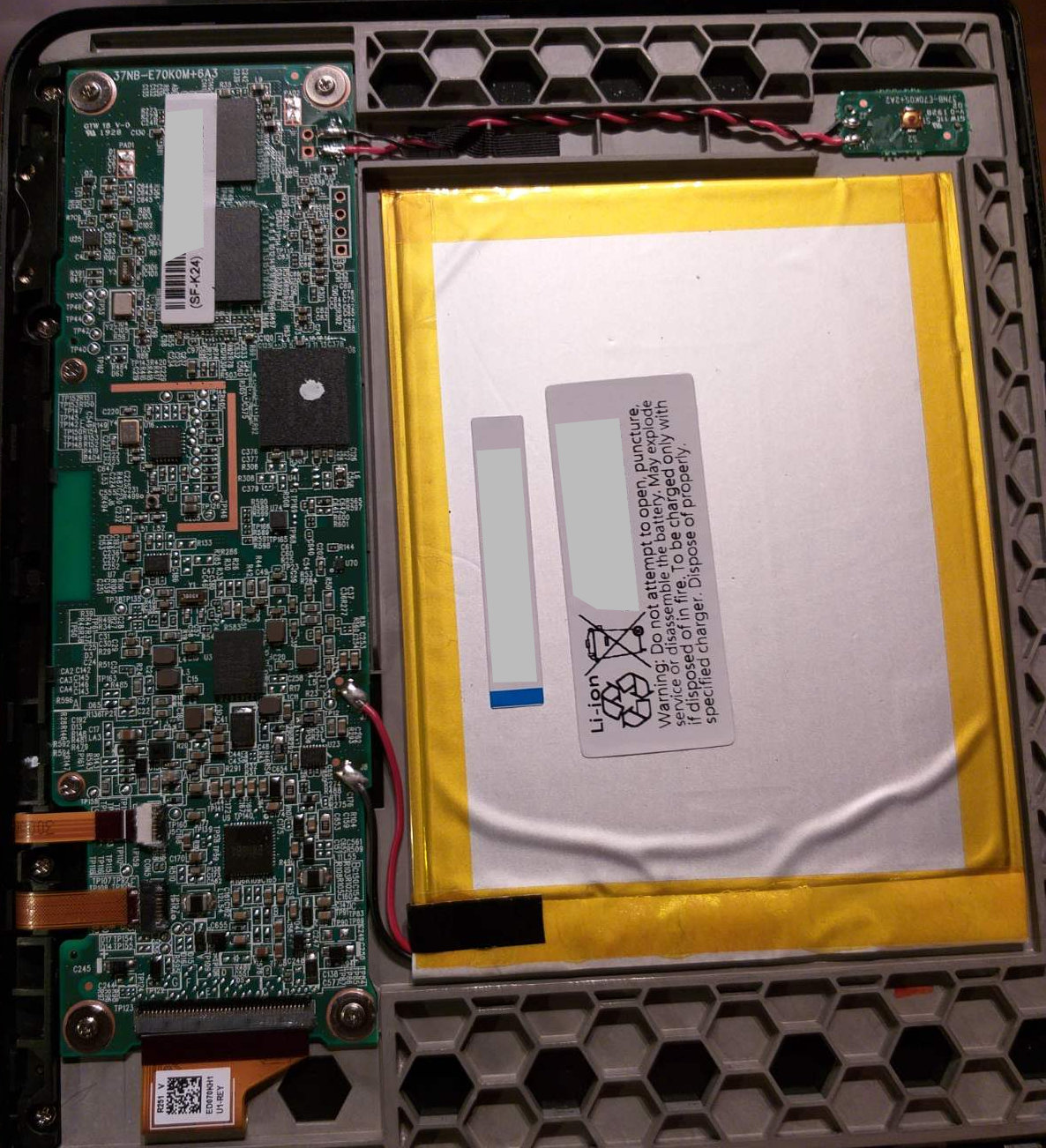

Innards
Pops open easily.
finger / thumbnail / plastic plectrum at bottom corner / long edge diagonally opposite from the power button.
A connector near on/off cable for either JTAG or low voltage serial. Obviously the biggest cost saving change would be to have the power button on the main PCB, either to top or bottom.
It's not a real waterproof design, the HZO coating will just ensure it survives accidental dunking.
Serial numbers blanked out.

I'm glad the power button is nowhere near the wide bezel with the page turn buttons. I'm sure I'd be constantly turning it off if it was.
