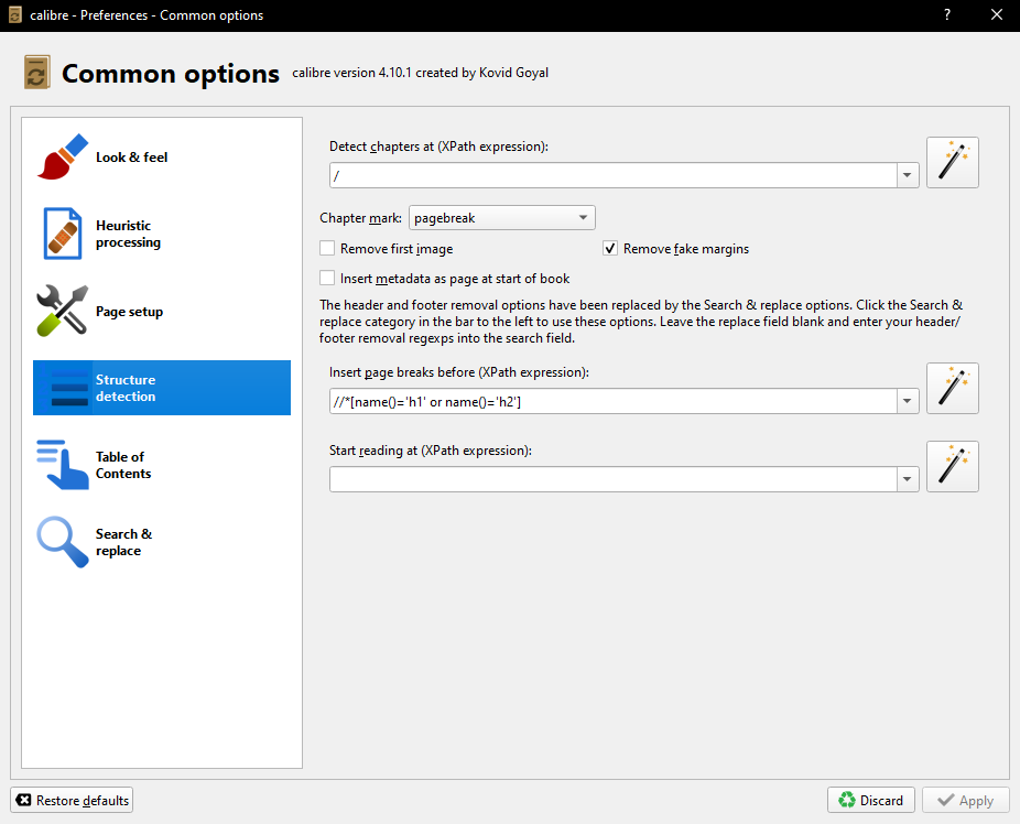

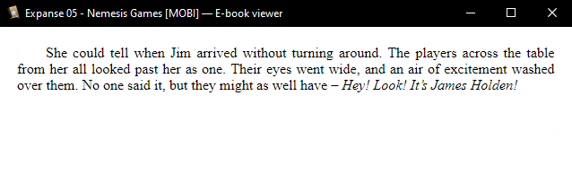

It will be vecause it has class="chapter" on all its paragraphs.
Ah, yes, it definitely does!
Change the page break detection setting in the conversion dialog under structure detection to / and you will be fine.
That didn't seem to fix it. Not sure if I'm doing something wrong. Added a couple screenshots showing the setting and result is still chapter-per-page.

Posts: 46,638
Karma: 29634066
You need to change the options in the conversion dialog of that book.

Allreader
Allreader began at the beginning.
Posts: 5
Join Date: Oct 2019
Ahhh, I didn't realize Calibre saved conversion settings per book. That's great. And that worked, thank you!
