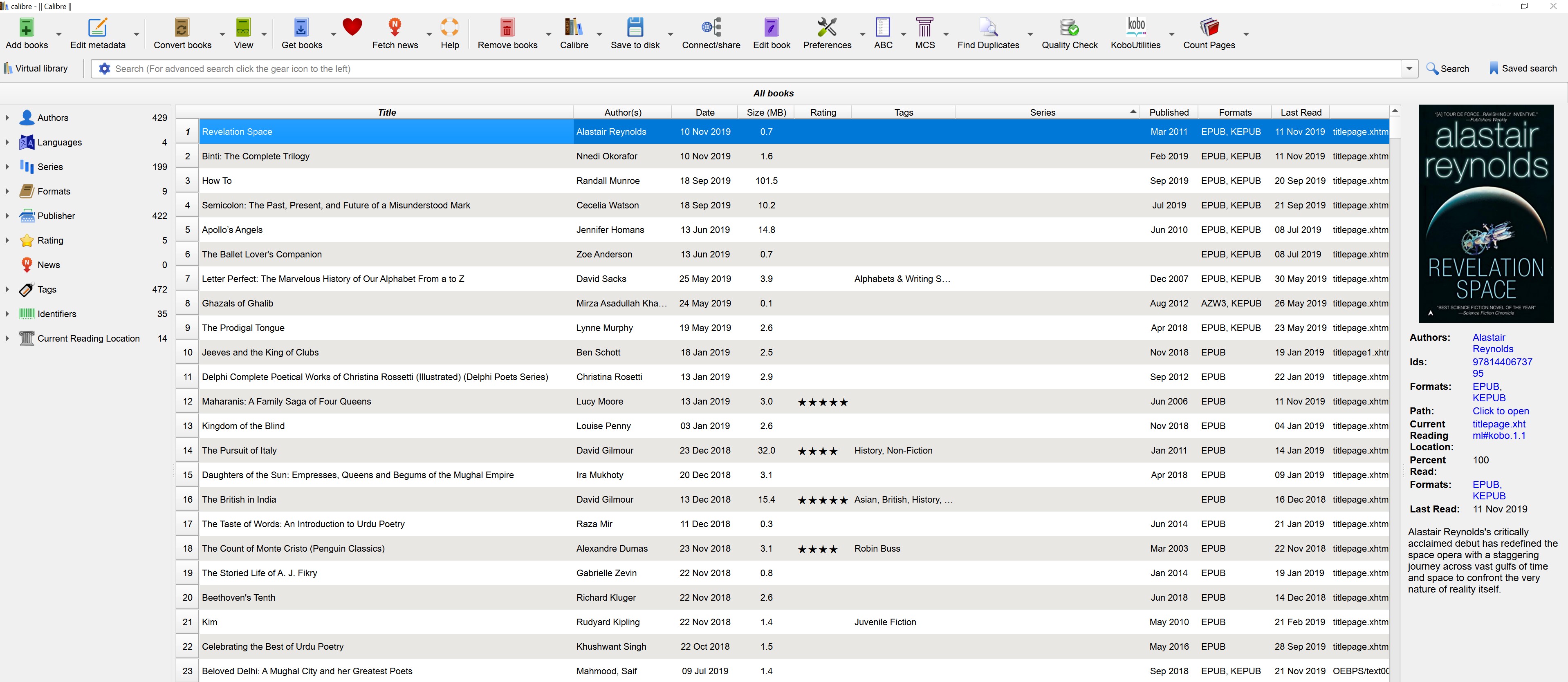

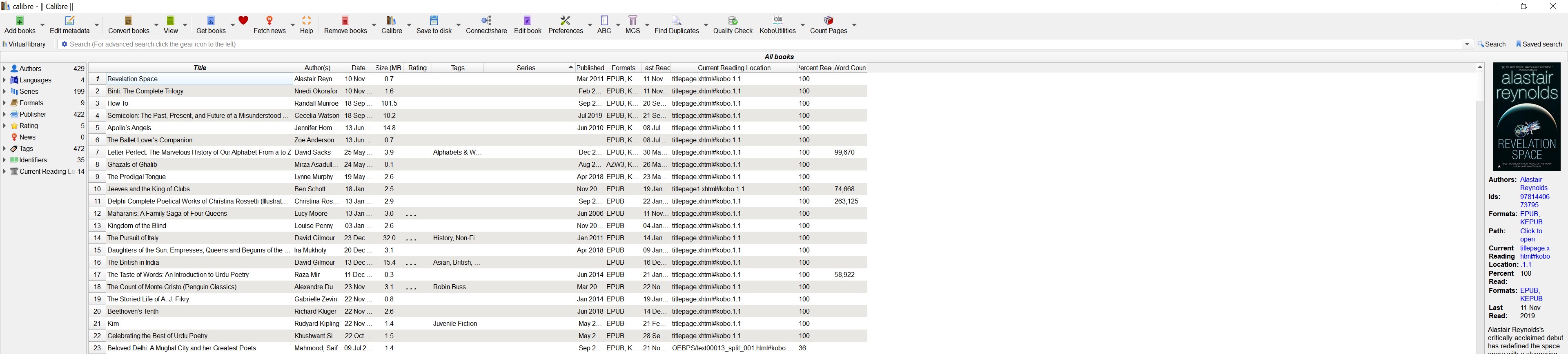

The Qt update, most likely it is turning on high DPI for your screen. You can turn it off again via Preferences->Look & feel->Adjust for high resolution screens

Thank you for the VERY prompt reply Kovid. I have attached a screenshot showing what my Calibre looks like with the High DPI adjustment set to "on" and "automatic" (automatic was the previous setting), and one showing what it looks like set it "off". Is there any way to get the happy medium I had, with slightly smaller text and icons but still using the whole screen?

The only other knobs you have available are font size and extra sacing between row, both on the same look & feel screen.
