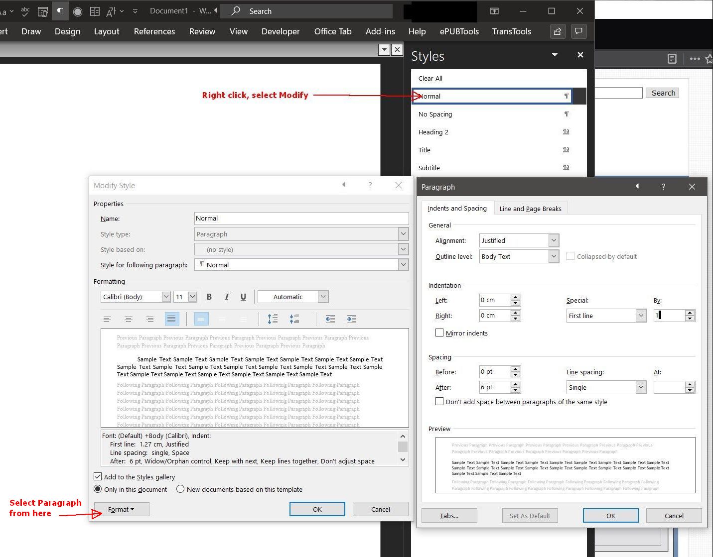

@BlindRobertBrown - you probably only need to change Word's Normal style paragraph settings to something like :
Name:	Annotation 2020-02-01 202730.jpg
