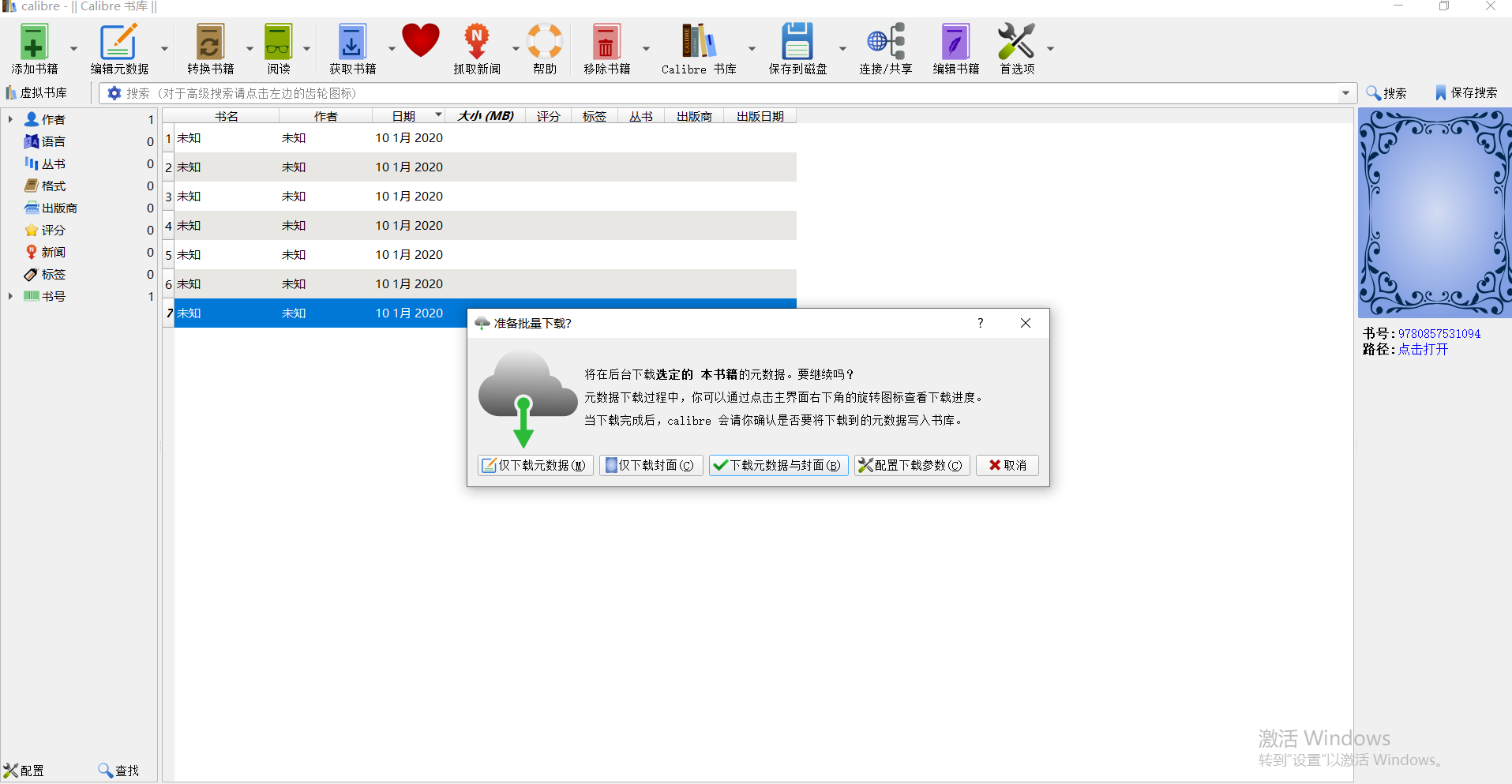

can you the screenshots of my steps?

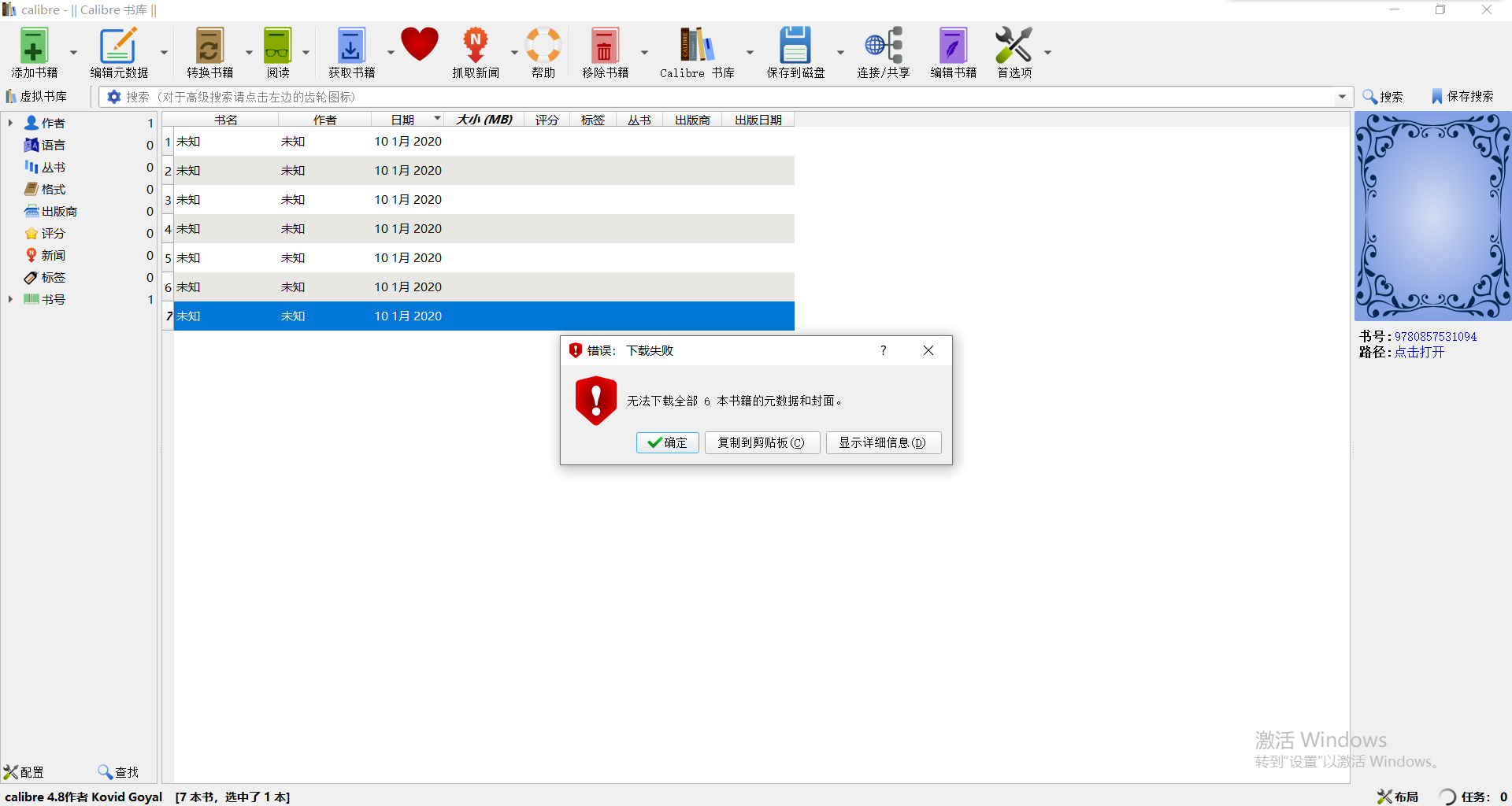

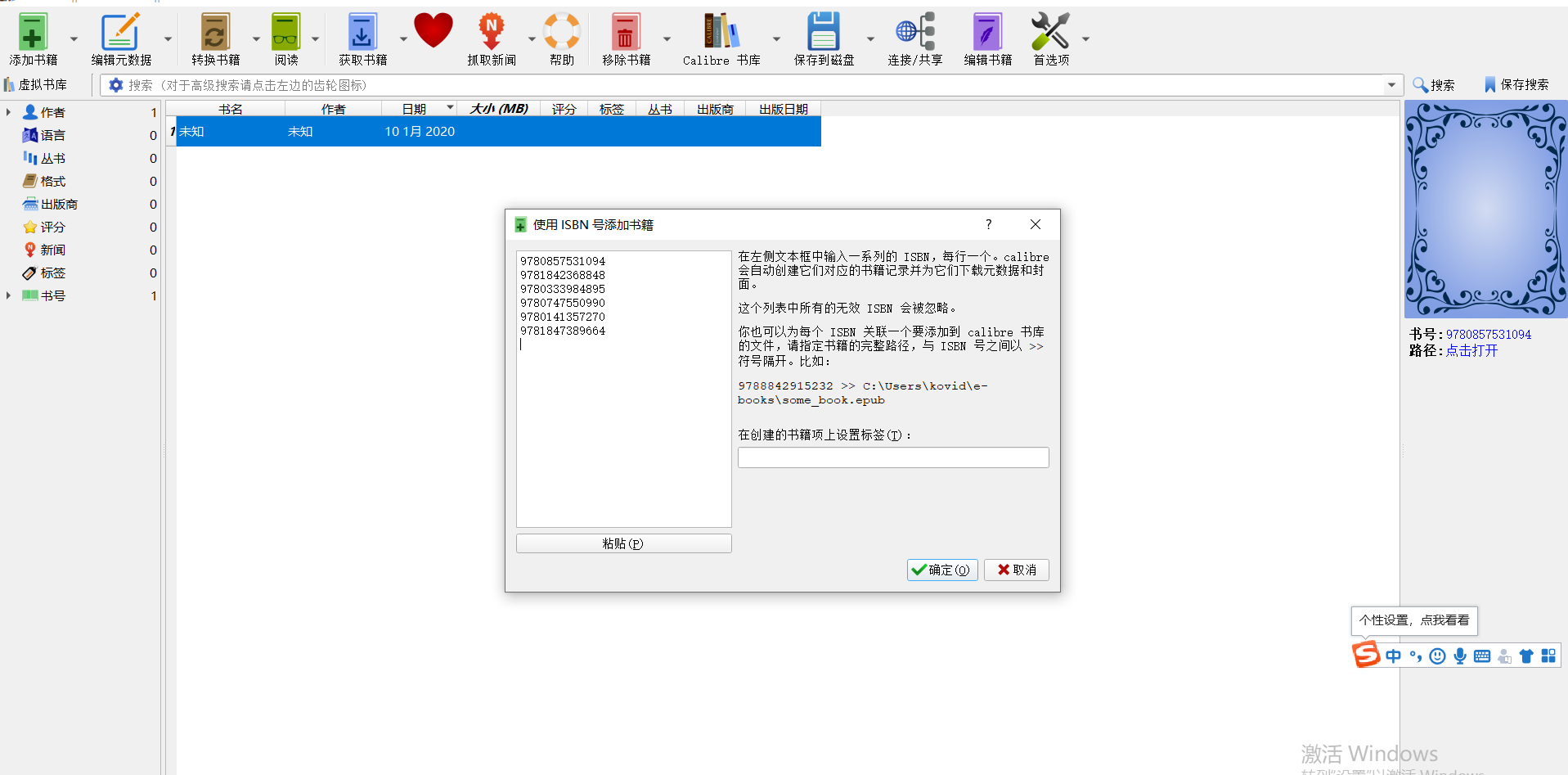

Here is the screenshots of my steps to import isbns. Calibre has the choice of adding from isbns, so i did this.

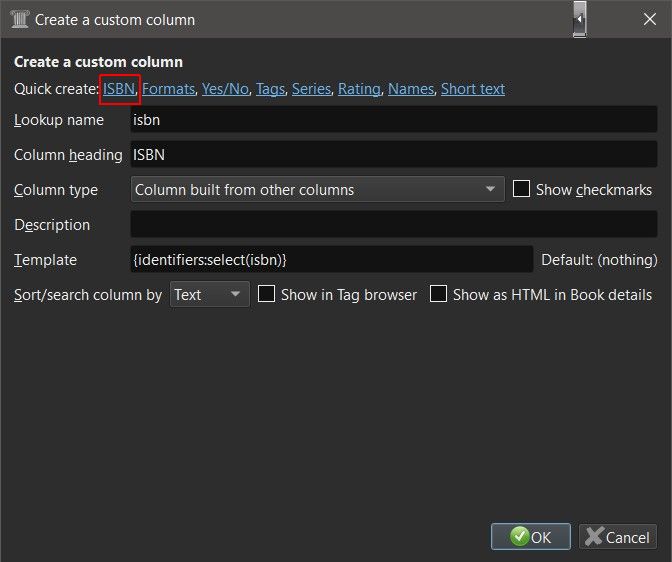

Create a custom column to display the ISBN:
Name:	Annotation 2020-01-10 204335.jpg
And then post a screen shot of the book list with that column.
Maybe the Add from ISBN didn't work.

Attachment 176296
In the last screen shot, one of those buttons is to display the details of the attempt to download the metadata. Clicking it will show the log of what was done. And any errors. One of the other buttons is to copy the log into the clipboard. Then you can post that for us.
But, trying just the first on in the list, I was able to get a match. The matches came from Google and Goodreads. Google is one of the built-in plugins. Goodreads is one you need to install.
Which gets us to @thiago.eec's post. You need to install or configure the metadata source plugins to do the searches. And look at the results in the log to see more about what happened.

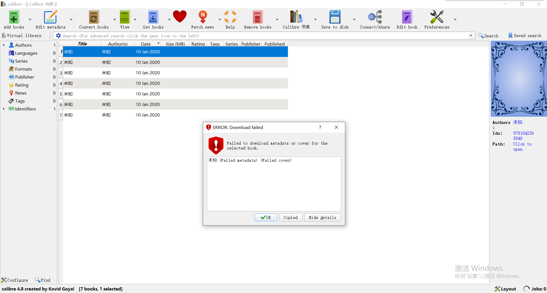

calibre, version 4.8.0
ERROR: Download failed: Failed to download metadata or cover for the selected book.
未知 (Failed metadata) (Failed cover)

My bad, some of those have English ISBN's
But the title is not ASCII (and to my untrained eye, the same. which can not be for a lookup) So, I think you created a 'perfect storm' by translating the title but using English ISBN
all those books are english books and have english isbns
