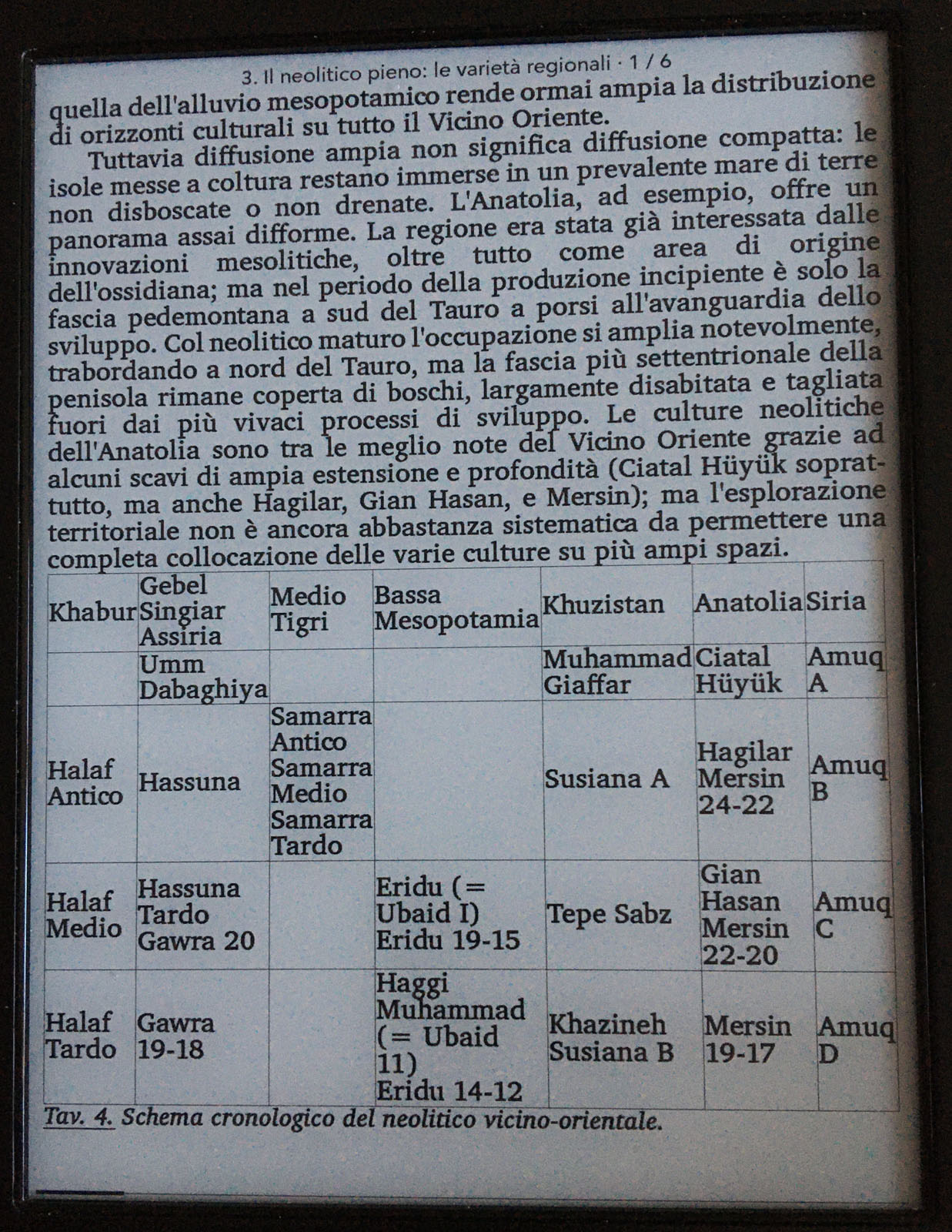

Is it OK if I post a screen shot (with cellphone camera) of one of the tables? It does work no problem sort of. If the text if made large enough, it won't look good. But at whatever size it is in the photo, it looks good. It's the table from Tav. 4.
Oh and one more thing, I added a text-align: left to the table CSS as it looks better that way then the text trying to full justify.

Originally Posted by 1v4n0 View Post
Wait, "Tav. 3" is actually an image. Tell me about the other ones, like "Tav. 4"
Here is the photo of Tav. 4.
It looks good.

There is going to be an issue on Kindles as they have wide left/right margins. On the Kobo, I have a rather narrow margin as you can see. And given that the table just fits, it may not fit on a Kindle screen.
For the table you asked me to look at in PM, make the headers muliti-line by adding a hyphen and then make those columns smaller. Do that for every table you can and you'll have a better chance of the table fitting with a larger font size.
One other thing, my Kobo is an H2O and that uses a 6.8" screen.
