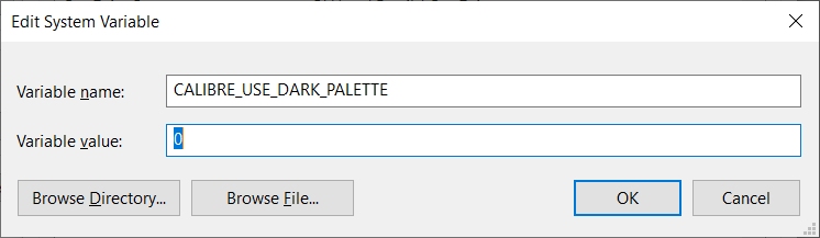

I also had to go back to 4.5 because I couldn't figure out a way to turn off "dark" theme. I like it for windows 10, but don't want to read white on black. There should be an option to disable dark theme even if opsys is set to it.
I think if you move away from using System default you should be able to avoid dark theme. Go Calibre Peferences - Interface - Look & feel - User interface style - change setting from System default to calibre style (see attached.) Then restart calibre.
Kovid provided the following to turn off dark mode in calibre:
The link in the manual Kovid pointed to does a good job of explaining how to set the variables. I attached my variables as a general example. The system variables don't have to be duplicated in the user section and vice-a-versa.
Name:	Environment Variables.jpg
ID:	175656   Click image for larger version
Name:	New Variable.jpg
