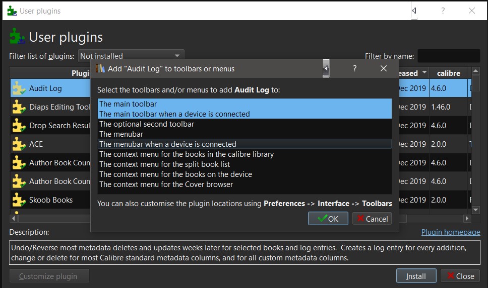

Most (all ???) GUI plugins give the user the choice of defining the toolbars and menus where the tool is to be shown - it's a multiple choice list, viz:
Name:	Annotation 2019-12-21 092331.jpg
Added: you might only get that when a plugin is first installed, not when updating an existing plugin.
Attachment 175768
Hmmm, i am still on the development environment, where the plugin is installed using the command line, perhaps that is why it did not showed the option to add it to the interface... I will look into it again latter, when the plugin should be nearly ready for packaging and end-user tests.
<snip>
That's probably it, a brain cell is telling me that the "Add xxx to toolbars and menus" dialogue also doesn't pop when you add a plugin from a file.
