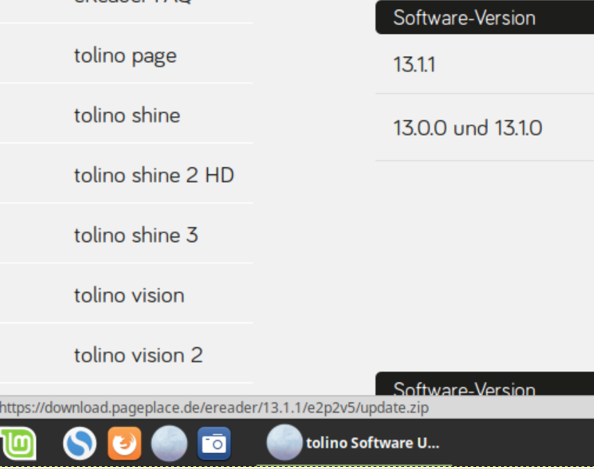

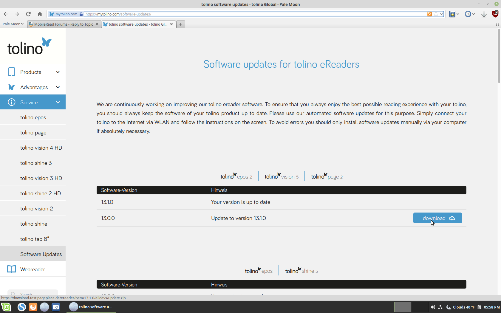

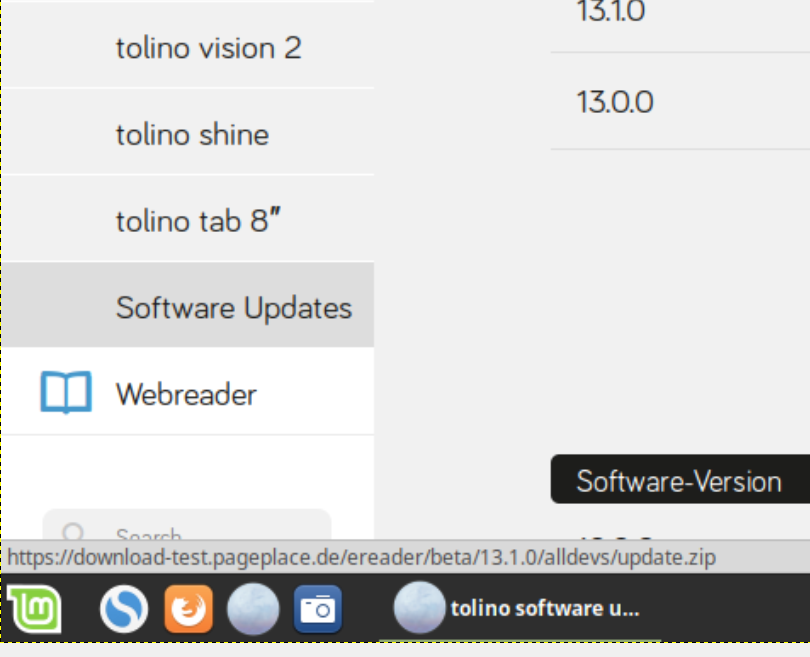

What's really odd is that the English website only has 13.1.0 available and, if you hover over the link, it shows a beta download. The German website, on the other hand, goes to a completely different download directory. I don't have a problem using the German site (because I've done it in the past) but it's weird that they don't get the English site updated.
The difference between 13.1.0 and 13.1.1 is in handling of CARE DRM for Onleihe books
