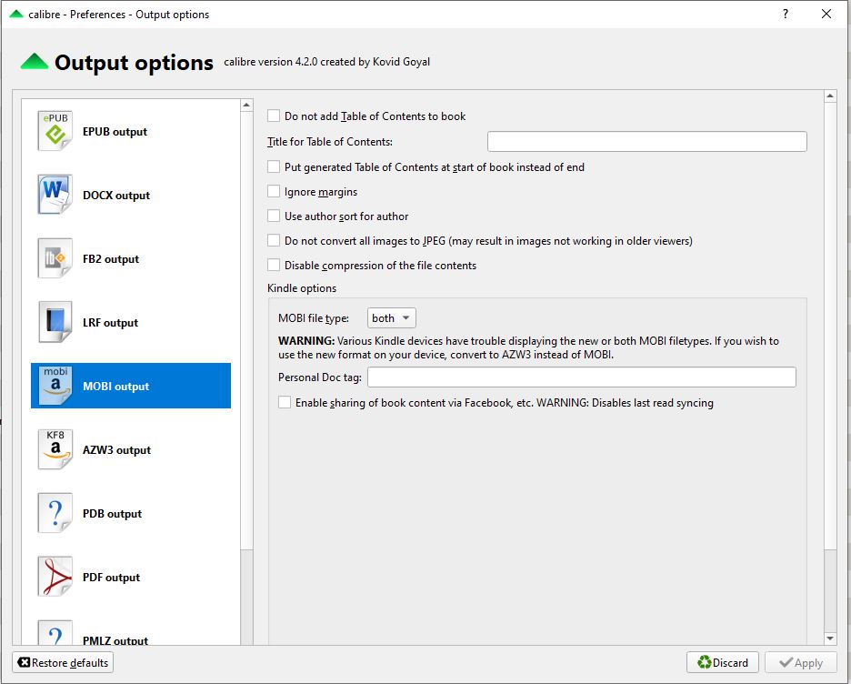

My method is to convert the eBook to MOBI with the setting shown in the attached screenshot.

The screenshot of the MOBI setting didn't make it, so here goes the 2nd try.

Okay, I did the experiment and got a very positive outcome.
Changed the output of MOBI file type to new, deleted the old one from Calibre, Kindle, Android and Amazon.
Then - of course - converted it to the new MOBI and send it via mail to my Kindle.
Whispersync worked without any manual intervention.

... Wait, let me see if you understood you correctly:
I create (or take if already at hand) the ePub version of the book in question.
Then I change the extension to ".png" (an image format?) or ".txt" and send it via eMail to the address of my Kindle.
That does the trick for you, to make whispersyn work more reliable
Yes.
KindleGen is Amazon's mobi creation software. It converts epub (and other formats) into a mobi file that contains an azw3/KF8 component and an old mobi format component. This is similar to Calibre's mobi-both.
I found that while Calibre mobi-both files usually work, occasionally they fail to sync or have other problems. When that happens, running the epub through KindleGen always fixed the problem for me, so I switched to KindleGen.
You can run KindleGen in a variety of ways:
Send to Kindle is the easiest. Officially, Send to Kindle does not accept epub files, but if you change the file extension to .txt or .png (yes, an image format), Send to Kindle thinks it's .txt or .png rather than .epub and will accept it, run it through KindleGen, and voila, you get a dual-mobi file in your Kindle Personal Documents library that syncs. iOS (and Android??) will receive old mobi format, so the cover works, but eink Kindles get azw3/KF8, so no cover.
Using the Send to Kindle desktop app is preferable to email because then you can input the title and author. If you Send to Kindle via email, the title will be the filename and the author will be the email address.
odamizu is offline   Reply With Quote

Originally Posted by BionicGecko View Post
Basically, if you consider those three things:
  1. Syncing of last page read across devices
  2. Book covers
  3. Advanced text formatting
Unless your Kindle is still on a fairly old version of the firmware (i.e. lower than 5.8.5), it is not possible to have all three. You can have:
  • 1 and 2 (but not 3) by using the "Old" MOBI format
  • 1 and 3 (but not 2) by using "Both" as the MOBI format, or converting to AZW3
  • 2 and 3 (but not 1) by sideloading your books via USB
What I noticed is, that if I change the MOBI Output setting from "both" to either "old" or "new", the sync between my Android phone and Kindle worked like a charm!
But with the setting on "both" it was back at the lottery.
The cover did never show up on my Kindle, though, no matter the setting.
Indeed when using "Both" you get a file that contains two versions of the book, one in the old MOBI format, and one in AZW3. When you send the file to amazon, their servers keep both versions. If you request your book from an older Kindle, then you will get the MOBI version, because those kindles don't support AZW3. If your Kindle does support it, then the AZW3 version will be downloaded to your Kindle.
This does sound like an optimal solution, but - for me at least - proofs very fragile in comparison to how reliable whispersync works on "new" or "old" setting for MOBI.
As far as I know there is no "New" option, because "New" would be a plain AZW3 file, so you would convert directly to AZW3 in Calibre instead.
There is a "new" setting, actually. I took a screenshot of it.
So, in essence it should be the same as having the MOBI Output set to "both"? Because here the sync does not really work as expected.
Or is there something fundamentally different when pushing the file through KindleGen locally and not automatically like when sending the book via mail?
I gotta say, I never noticed that either the title or the author got screwed up when sending the book via mail to my Kindle. Neither on the phone nor the eBook reader itself.
You mean when e.g. "clicking" and holding on the book cover to get to the detailed info of the book, right?
Last edited by tirion; 10-30-2019 at 08:24 AM. Reason: Forgot the mentioned screenshot

Actually, why not using AZW3 directly instead of creating a MOBI with "both"?
There are differences in a MOBI fle produced using the "both" option of calibre and a Master MOBI created using kindlegen either by running it yourself or as the result of emailing a source file to Amazon. One difference is that calibre's MOBI "both" lacks a DATP record which contains the data needed for proper synchronization of reading position between formats.
Amazon will not accept an AZW3 file via email so you can't add it to your account and it will not sync between devices.

Sync seems to work best for me if I convert files to old mobi before sending to Kindle with Calibre. I get covers too.
... Because here the sync does not really work as expected.
Please elaborate on exactly what's happening that is not as expected.
You are using the .txt/.png trick to email an epub and it's not syncing?
The "screw up" is only if you use the .txt/.png trick to email the book.
If you email a .mobi, it's fine (it gets the author/title from the opf).
