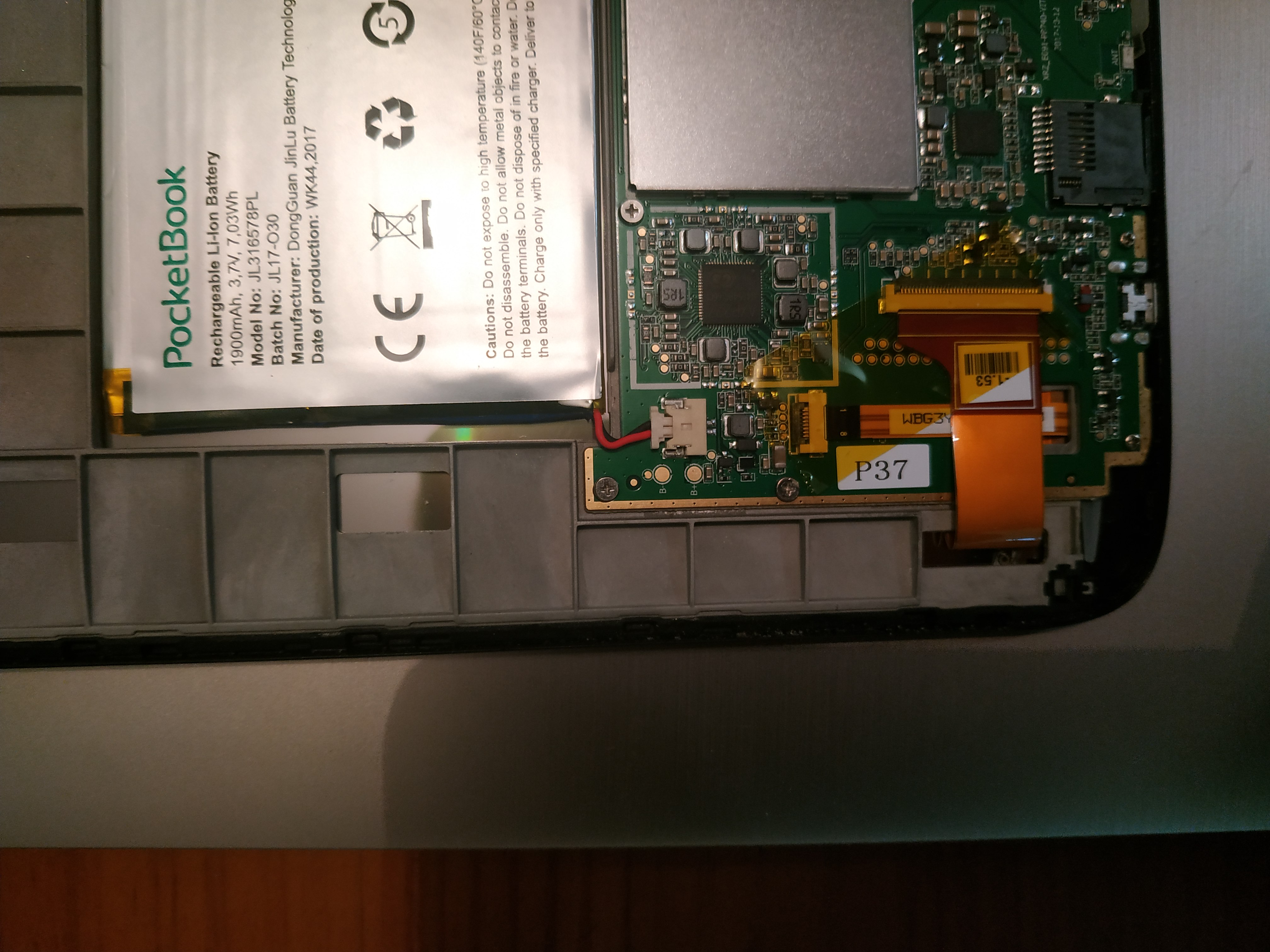

Hello, how did you open your Inkpad? Do you have a hint doing this without breaking all in pieces? Thanks much! Any photo would help too...

The InkPad 3 can be opened with your fingernail. No special tools are required. Then all you have to do is disconnect the battery tab.
