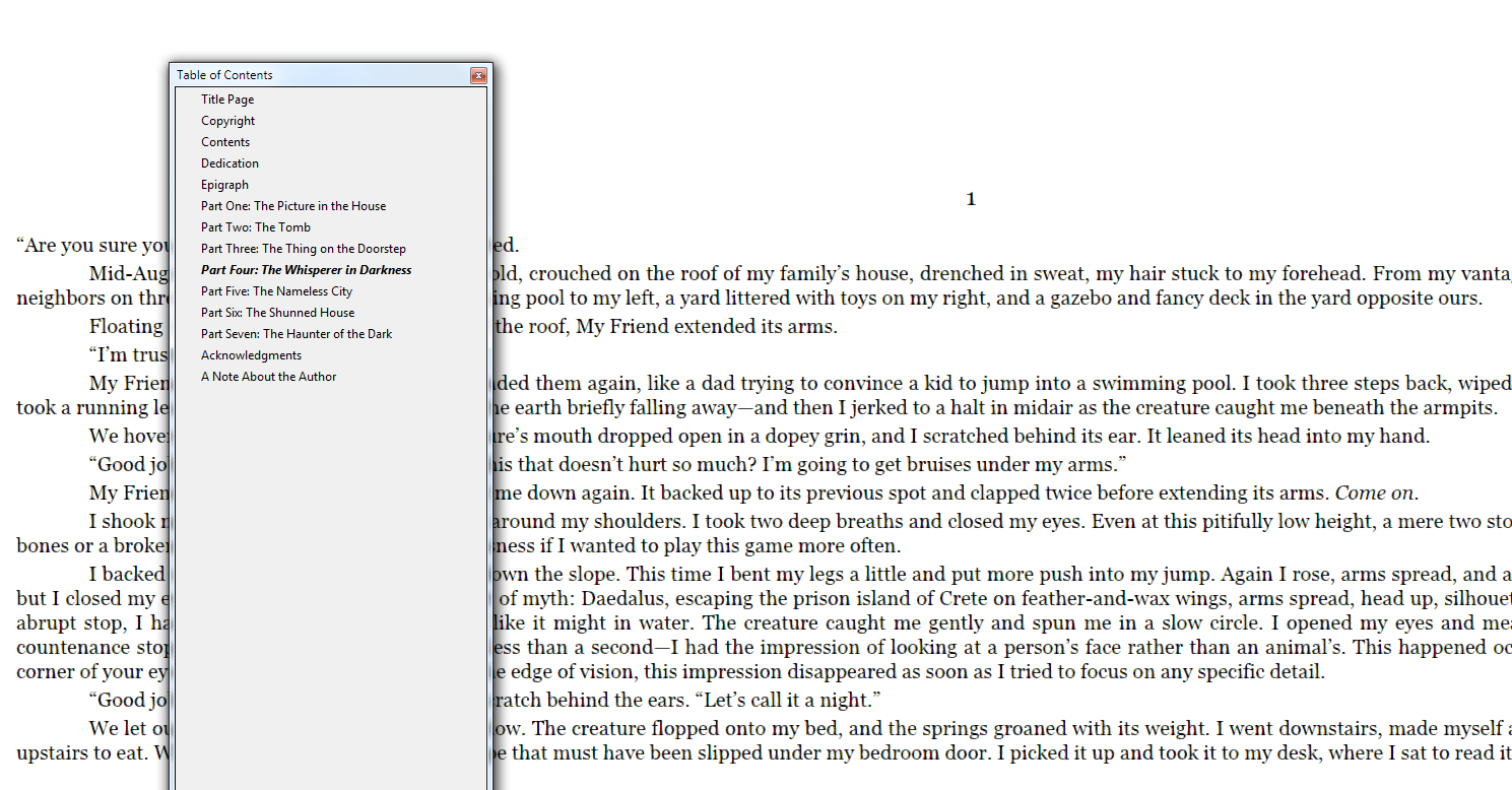

I installed the new Calibre 4.0 and noticed that the settings and the text in the e-book are all blurry now in the new reader. See the image in the attachment.
Do you have any idea how to solve this issue?

It's Windows 7, latest build. Choosing other fonts and/or changing font size doesn't help. The main program is crispy sharp as before. It's just the new viewer that somehow changes distorts the clear text.
And are there DPI/Zooming/Accessibility shenanigans going on in your system?
No, nothing. Every other program (including up to Calibre 4) is running perfectly.

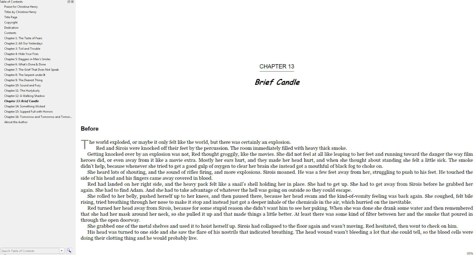

I just tried restoring down the table of contents window: it seems to restore the sharp text in the table of contents, but the main text remains blurry. See the attachment.
Hmm. I guess that it's kind of a font or windows scaling issue?
