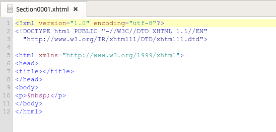

Thanks Dion. That's a brilliant suggestion with the template and I'm definitely doing it. What I run into trouble sometimes (and I suppose I would with the template too) is I copy and paste the contents from the previous epub what was in the About the Author, CopyrightPage, etc. So let's say I do your template.epub and I delete everything in the content of say the AboutTheAuthor page. Then I copy and paste everything from the previous AboutTheAuthor page, but then the stuff at the top (screenshot) sometimes is different and it causes problems.
I think I figured that out. Just take whatever is in the <body> tags and add it to just under </head> tag.
Then the only thing I would need to be concerned about would be if the stuff at the top changed. Or would Sigil automatically update that stuff every time I opened the template?
I just set up a template.epub. One more question--I don't have to do anything with as you say the default content.opf. It's just there, right?
And how do I open the original html file into the epub template?
Thanks again!

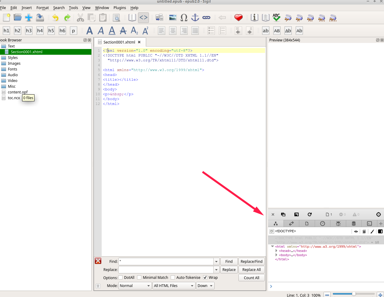

Thanks ducks. This is what I meant by the corner panel.

Ahhh... the inspector portion of the Preview Window. I get it now. A lot of people drag the splitter bar between Preview and the Inspector all the way down so the Inspector is entirely hidden.
Somebody (or something) probably manually/accidentally edited the xhtml that links in the stylesheet. So the Inspector (nor Preview) could find/load it with that particular name. Removing the link tag from the head:
<link href="../Styles/Style0001.css" type="text/css" rel="stylesheet"/>
And re-linking the stylesheet you want would take care of it as well.
If you remove a zero from the link tag above (in Code View) with the Inspector widget open, you'll likely see the same error. Then put the zero back and the error will go away.

The 'Inspector' (Mine is very tiny most of the time and I only resort to that when my eyeball cant spot what code I really messed up. The Inspector is great for tracking Inheritance issues. )
