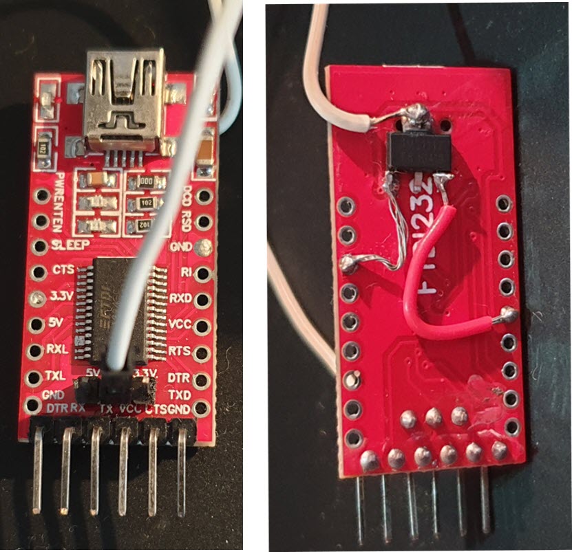

Looking for my kindle board i stumbled upon this image and now i'm not sure about the connections, TX,RX,GND but what is the 4th?
I'm taking about the red wire in this img:
https://www.mobileread.com/forums/attachment.php?attachmentid=145410&d=1452450964[/IMG]
Regarding your setup i'm wondering why you didn't just make a hole in the case for the jumpers thus avoiding opening the kindle every time? Also curios you used a female to male jumper wire to bridge the soldered cables and the serial board?
Lastly i should have said so but my kindle was never hooked to an AP so it never had any connection and was only used offline so no OTA was possible, no idea how it got messed up on it's but obviously not ruling out HW failure so you're right about taking it slow.
Just to be clear tho, you are saying that while using serial it's impossible to ruing the device with a bad\improper image?

Attachment 173601
You mean the AMS1117 LDO regulator. Never used it myself, nor I ever saw it being used on this forum. Theoretically, it would work, but how is it different to using a simple resistor?
And since you're buying parts, wouldn't it be better to just buy a new serial cable that provides 1.8 volts out of the box with no modifications?
As for the picture, it's definitely odd. In my setup, I never touched the jumper pins, except to set the jumper to 3.3 volts. I guess that the owner of the picture used the jumper pins as a 3.3v source either out of ignorance of the jumper's use, or deliberately, possibly because they had lost the actual jumper itself. But there's no need for a 3.3v source. The 3.3v are provided over Tx and Rx.
Edit: After having re-read the article, he's using that to supply the 1.8 volts to the Tx and Rx pins. That 1.8v comes out of that black box, the LDO regulator, on the backside of the board.
Again, why not buy something that provides 1.8v out of the box?
To recap, you only need three cables going out of that board:
1. Board Rx -> Kindle Tx
2. Board Tx -> Kindle Rx
3. Board Ground -> Ground.
Not a single cable is needed on top of that.
Whatever that extra cable is, it definitely isn't connected to the Kindle's serial port pad. It seems to be going to a screw on the Kindle's board, probably taped over the screw instead of wrapping it round the screw the way it's supposed to be done. If that's what happened, it would be another ground cable, but there's already another ground cable soldered to the RF shields (the metallic boxes on the board).
I'd rather open up my Kindle every time (and how many times is that going to be?) rather than permanently disfigure it with a hole to the outside. I thought of sticking the cables out as a compromise, but even that is ugly.
With serial, you are going to flash the individual partitions. Even if you flash your Kindle with the wrong partitions, it's not going to do the Kindle any harm, because you can always flash them again with the correct image via fastboot.
A word of caution though: Modifying the bootloader (U-Boot), which is located outside of user-accessible flash storage, is risky. But IIRC, an Amazon stock update package won't touch that.

I'm still wondering whether i should take the chance or not, it would save me the time waiting for parts...
Originally Posted by WaseemAlkurdi View Post
Why order parts? Why not simply solder in the resistors as per the level-shifter circuit? It's literally two resistors and a diode. Beats waiting for parts.
That's the thing, where am i supposed to get the resistors and diode, whichever way i take i need parts, i got nothing at the moment as i don't do this often.
I just googled regulator vs resistor that's how much i know about this stuff lol , i guess a resistor does makes more send at the point but the price for a regulator is a very small margin and it's 1 part instead of 2 resistors right?
Regarding the serial cable:
1. those are expensive
2. i honestly like to improve my skills and this job fits perfectly for this as there is low risk to mess something up
i would if it was cheap
Why would anyone need 2 ground connections?
I can relate to this but opening every time can also be bad and annoying i guess it really does depend on how often it happens to justify.
I've seen some people erase all and then could not recover from it , i thought i'd ask
On the one hand, fixed Kindle ...
But on the other hand, fried Kindle. Your call.
Local mobile phone and general electronics repair stores have a good supply of these parts.
It's about whatever you find easier to get. If you (locally shopping around) find somebody who has a regulator in stock, then by all means get one.
What? They are around $2 - $4 in price.
From eBay: https://www.ebay.com/itm/TXD-1-8v-PL...e/142006114032
Ah, that's a good point.
I can't think of any other explanation given the point where the cable seems to run to, a point in which a screw is there on my own Kindle.
If I were to use the Kindle primarily as a small ARM board, then I'd leave them sticking out of the bezel or charging port. A compromise.
But since I'm getting the Kindle as a purposely distraction-free study aid for my failing eyesight, and to hack around when I have free time, I decided that leaving the cable in there would turn of that "urge to hack"
Can you point me to such an instance? It's pretty much impossible to do.
I initially thought that said people have been wiping /dev/mmcblk0 completely, perhaps by a wrong dd command where of=/dev/mmcblk0.
But if you (1) do a complete image of the eMMC, using this dd command:
# dd if=/dev/mmcblk0 of=/path/to/image.bin bs=4096
then a second image with @knc1's image backup script, and
(2) stick to the Kindle's partitions when flashing!!
then you're safe. Nothing can then go wrong.
After second thoughts however, look at this tutorial:
https://www.mobileread.com/forums/sh...d.php?t=271750
It starts out with a blank eMMC and from there, writes the bootloader and all.
So really, it's virtually impossible to brick a Kindle by wiping it when you have serial port access.

But i would need to strip the jumpers and solder the cables to the board right?
I think this thread
https://www.mobileread.com/forums/sh...d.php?t=267541
Shows what is the 4th conenction

I decided to try and solder what i have to the kindle, very tiny points it was a mess....
Eventually i think i succeeded since i checked the voltage with the multimeter.
For some reason the USB\TTL adapter didn't light up on TX but RX and GND were fine.
GND was wrapped around a screw so that is sold while TX and RX were soldered so it's strange.
I checked the voltages and TX was getting 0.9 while RX got 3.3 so i guess based on experiments if its less than 1 it doesn't light up
Also on the dmesg it showed as follows:
[    0.850853] 00:05: ttyS0 at I/O 0x3f8 (irq = 4, base_baud = 115200) is a 16550A
But after disconnecting it still shows that so it's not related to the adapter
Does this mean i need 1.8?
Also i found this if it relevant
Yeah, it is indeed messy. But look at my setup ... don't solder stuff directly to the Kindle. Solder a cable like I did, then solder stuff to the cable as not disfigure the Kindle itself.
At which point did you check the voltages? At the adapter or at the Kindle?
Why are you expecting that dmesg entry to disappear? dmesg is a log ... plug events don't disappear from there when unplugged. Try with a USB drive and see the entries for yourself.
By the way, the adapter is usually ttyUSB0.
If Tx were to read 1.8 volts, then yeah, but reading 0.8 volts is strange. Unless you weren't reading from the Kindle, or you have something causing an inaccuracy.
Attachment 173667
These are good. I'm not an electrician, but I do remember Ohm's Law being useful for these. Not sure of the exact calculation needed.
