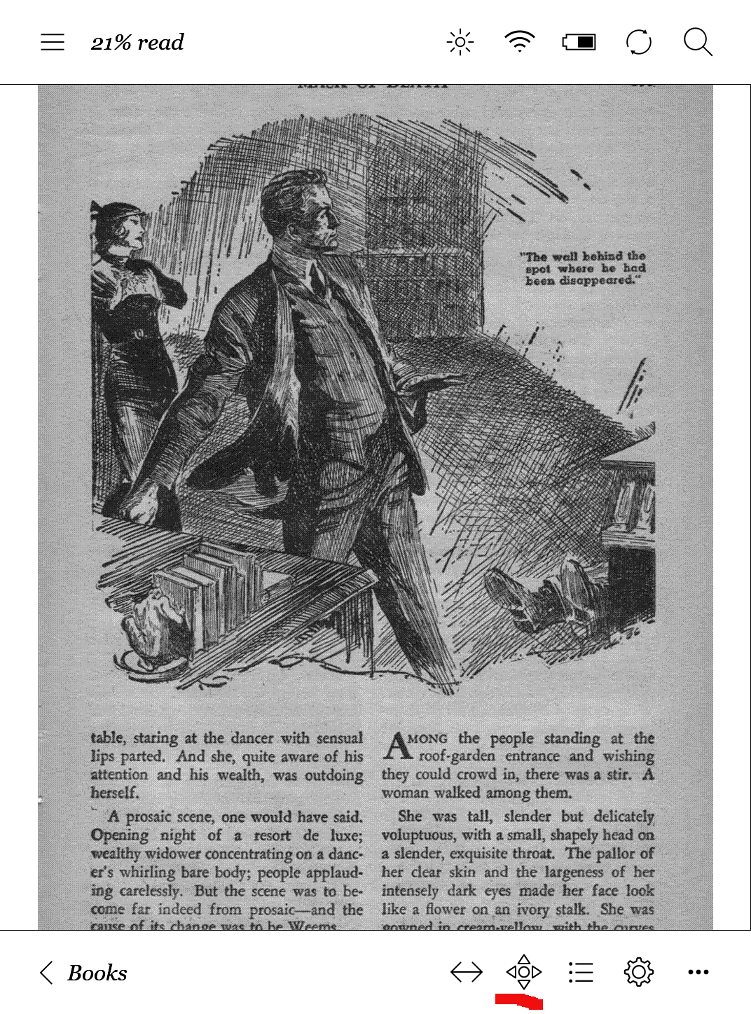

Which means you are not reading an epub or kepub. The icons will only be displayed if you can use them. You cannot change the font for PDF or comic books. So, the font icon won't be changed. The zoom icon will be displayed. This allows you to zoom in and out on the page, and pan around it when zoomed in.
The font icon will be displayed for book formats that allow you to change the font. This includes epubs, kepubs, text and MOBI. For a kepub, the first page, and pages that only have an image, they will probably only show the zoom icon.

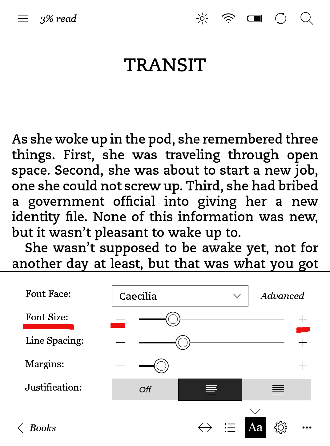

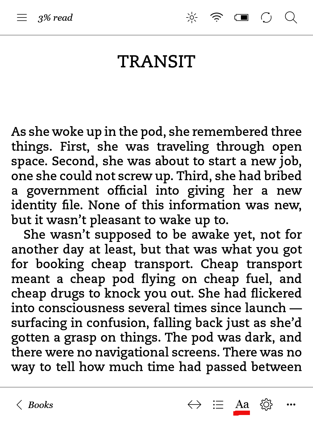

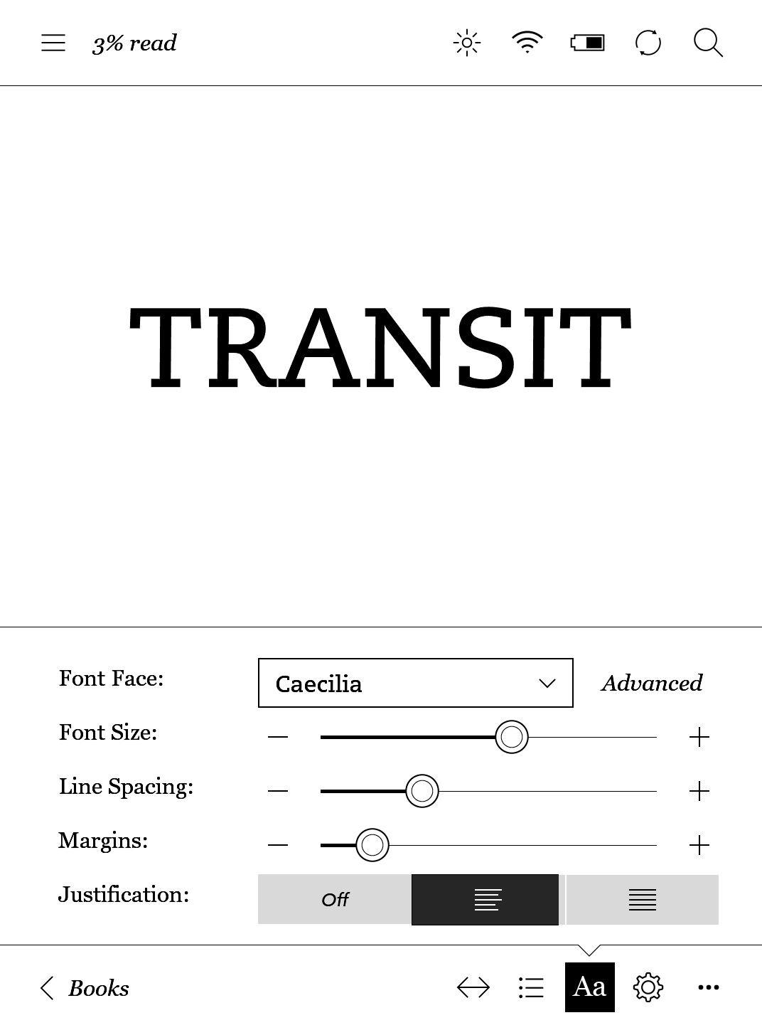

Sounds like you're reading a PDF and you can't increase the font for those. It's a limitation of the format not the firmware.*
In case you're actually not reading a PDF, just struggling with the menus (happens to the best of us) see attached for a couple of screenshots that may help. The first is what you should see when you tap the centre of the screen.
The last one is what happens with a PDF. Note the "compass" zoom in icon instead of "Aa" font one.
(*actually it may theoretically be possible with some types of PDF but I've never heard of an ereader or app that supports it)
