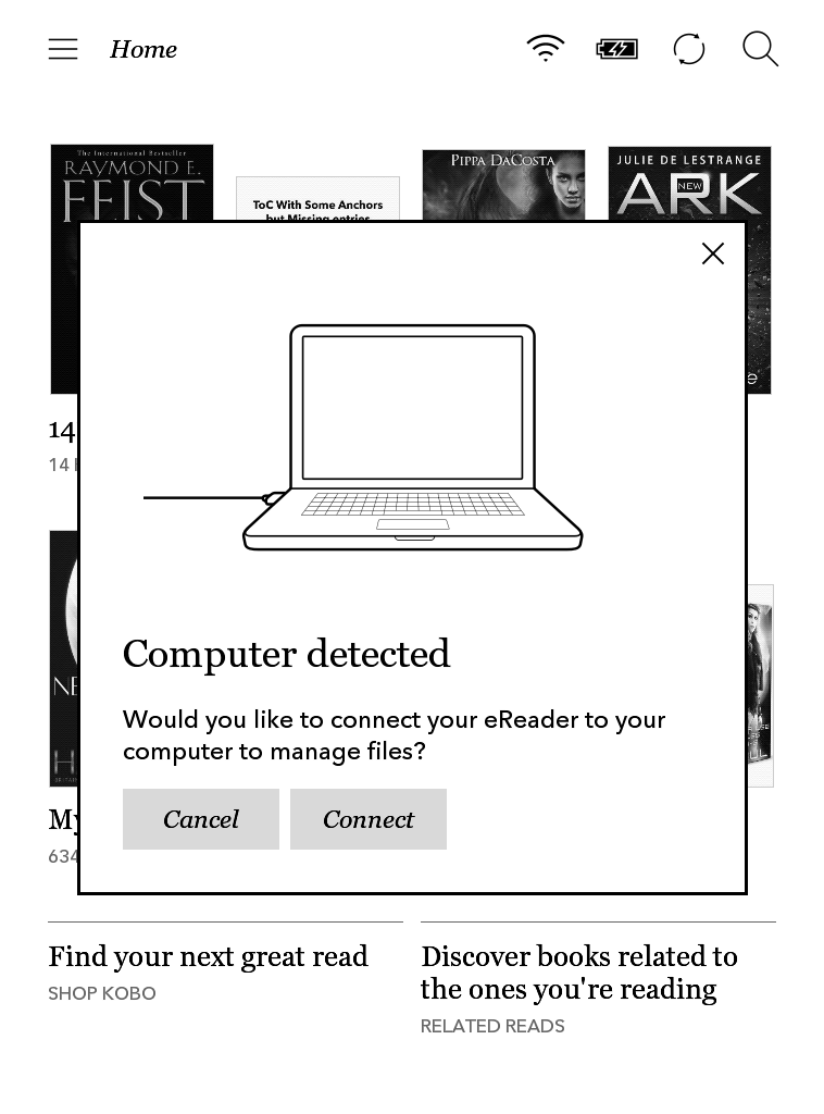

From everything you have posted, the device is working except for the screen. If you can find the connect button, it should connect to the PC. The exact spot is different on different firmware. But it tends to be a little bit left of centre, and two-thirds to three-quarters of the way down. If you plug in, wait for the screen change and then start tapping from the centre and move downwards, you will probably find it.
If I could find a ruler, I'd measure where the button was on my Glo. Here's a screenshot to give you an idea. The Glo has the same screen size and resolution as the Aura, so the locations should be roughly the same.
I was messing around and based on images online, I got the language changed to English. Now when I connect to the PC, I can see the changes and either its blank in the bottom (perhaps thats when there is a popup, based on your image), or it goes dark in the bottom with a msg to "download kobo desktop from ..... " When I get that msg, the light does not come on, leading me to believe it turns off.
I am away from the device at the moment, but will try to hit the connect button based on your image once I get home. Thank you for this. No need to measure, the screenshot is more than enough to help me.

Hmm, I have not been able to connect the device yet. But I wonder if the reason might be because I reset it? I tap around and only one of two things happen: either it turns off with a msg saying "download kobo desktop" or it ends up throwing the keyboard at me asking for wifi password. Perhaps its in the "initial setup" now and so I am not getting the Connect button?
If you did a factory reset, then the screen will be different to what I posted. The initial setup screens have changed a few times. The first screen is either asking for the language or whether to setup over WiFi or PC. The language screen is a drop-down of languages but defaults to English. You need to tap the button under that. Tapping from the bottom up in the middle should find it. If you do, it will take you to do the setup over WiFi or PC. Again, the button you want is the lower button in the middle. If you find the screen should go mainly black and the PC should detect it.
That's all from memory. Someone might correct me to where it is. But, it won't surprise me if I end up doing a factory reset of my Glo on the weekend to see if I'm right.
