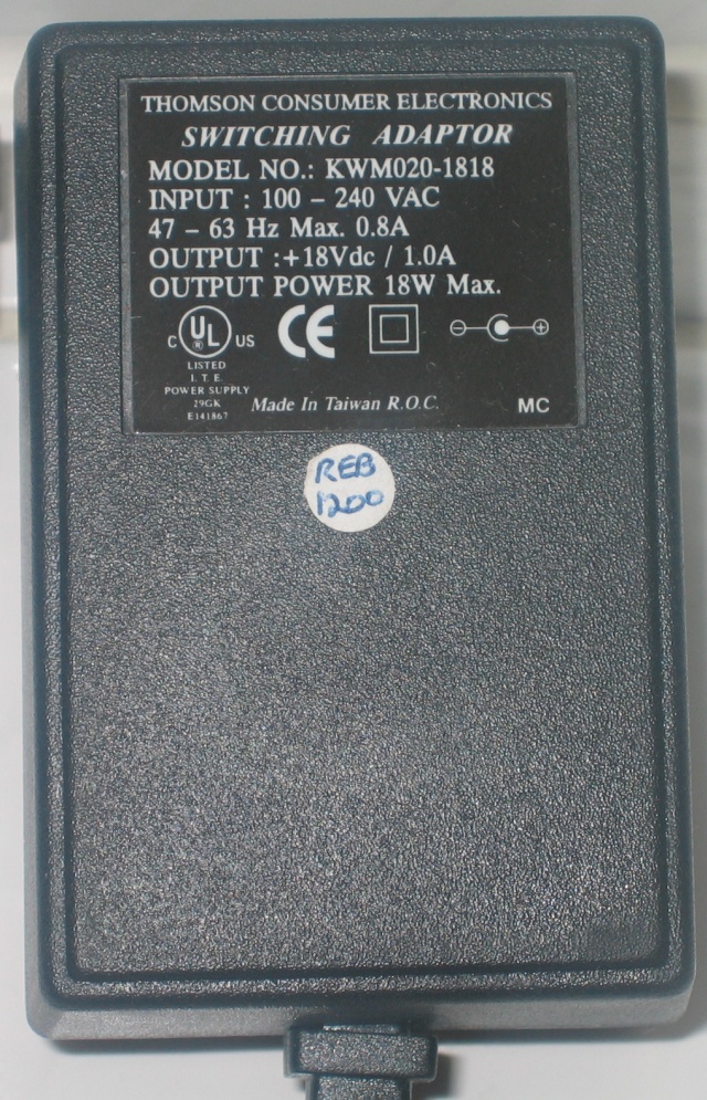

From the REB 1200 for Dummies - FAQ website:
What AC adapter charger/power supply is needed for the REB1200?
Original AC adapter:
Thomson Consumer Electronics
Switching Adaptor
Model No: KWM020-1818
Input : 100-240-VAC
46 - 63 Hz Max, 0.8A
Output:+18Vdc /1.0A
Output Power 18W MAX
Plug Tip is +
5.5mm (od) x 2.5mm (id) plug, center positive.
Buy a similar adapter from:
www.jameco.com part number 380374 Maunfacturer: Meanwell, Manufacturer Part No: ES25U18-P1M-R
Make sure the adapter puts out 18V DC regulated,
not 18V AC as the incorrect Radio Shack # 2049695 adapter does,
or your REB1200 will smoke!

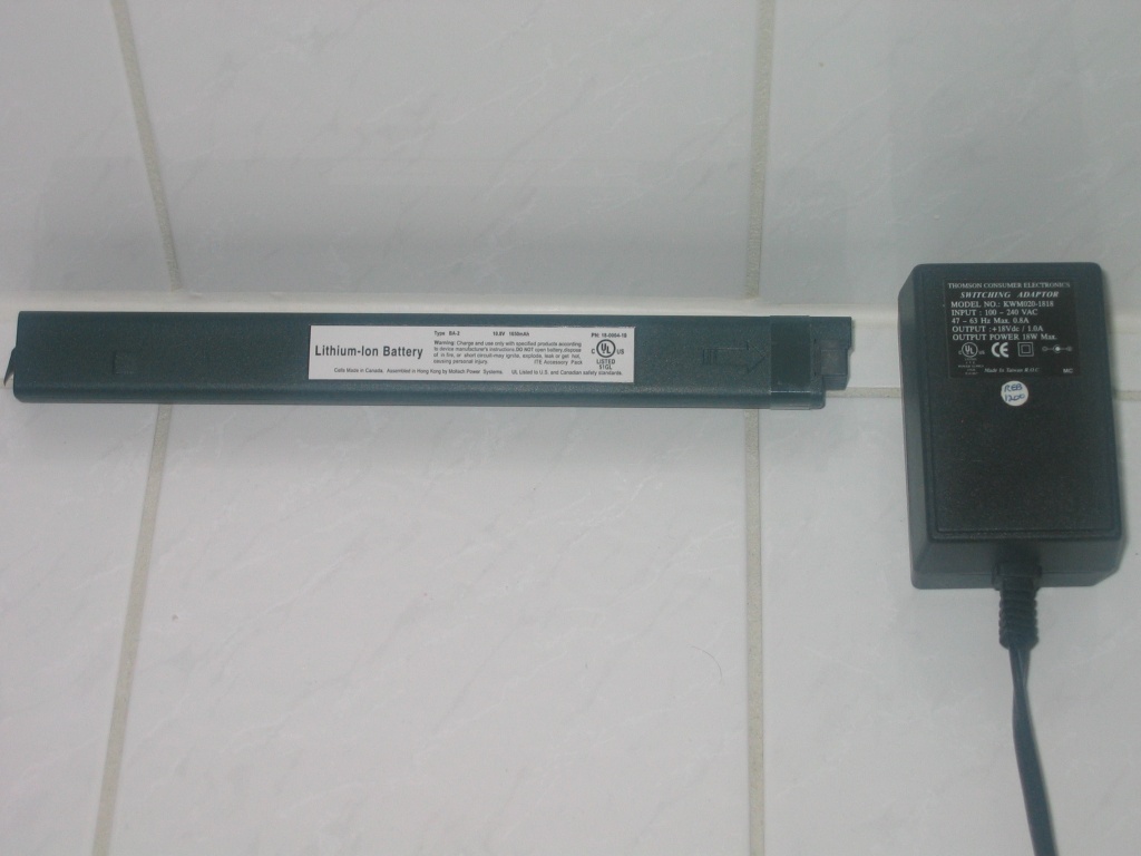

I just checked my adapter and it seems the plug has an outdiameter (od) of just 5.0 mm so it can use the Adaptaplug L or Adaptaplug N from Radio Shack along with a Adaptaplug-compatible Power Adapter (18VDC, 1000mA)

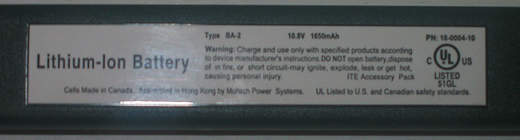

For the REB1200 Internal Battery (Semi-elliptical in a plastic housing) the information printed on the battery is:
Lithium-ion Battery
Type BA-2 10.8V 1650mAh
PN 18-000-10
ITE Accessory Pack
Cells Made in Canada
Assembled in Hong Kong by Moltech Power Systems
I attach images of the above for visual reference.

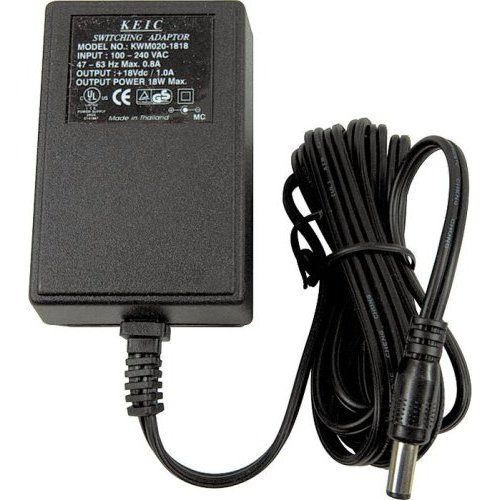

I just found this VERY similar ac adapter on Amazon.com, Dunlop ECB-06 18V Power Adapter
This adapter is sold through Musical Instruments Vendors as it is used by a line of Guitar pedals.
It appears identical to the REB1200 ac adapter I have, and is 18Vdc and 1000mA with center positive. They don't state the od, but similar Dunlop adapters (like ECB-003, ECB-04), do mention a similar looking plug is 5.5mm.
It does look identical to my ac adapter in every respect except the Vendor's name on top!

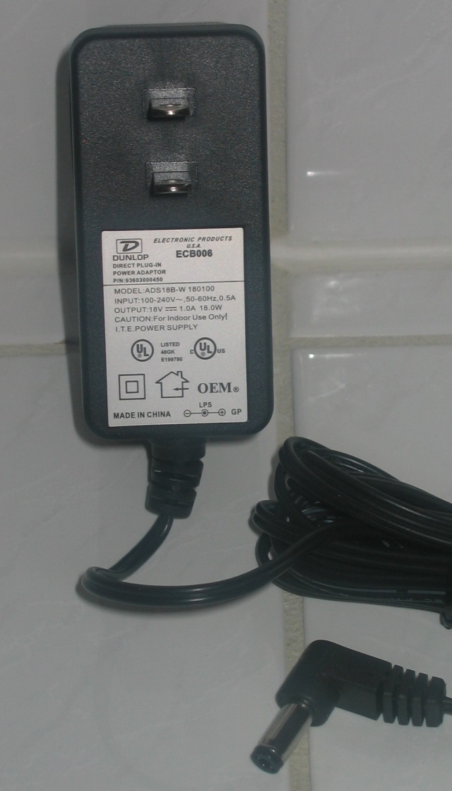

Thumbs up THIS DUNLOP ECB006 AC ADAPTER WITH GREEN REVERSE POLIRTY CABLE FOR REB1200 USE!
Originally Posted by nrapallo View Post
So I ordered it (approx. US$25)!
I was told it would take two-to-four weeks to get it, so I will report back about just how compatible it is!!!
NOT COMPATIBLE!
I ordered it sight unseen, but received a totally different looking ac adapter (like the other ones ECB004). See attached image of what the current generation of this adapter looks like.
The voltage, amperage and wattage looked compatible, but the tip was center negative (that's ok since they had a cable/plug that switched it to center positive). I could live with this BUT the inner diameter is only 2.0mm which means it can't fit onto the 2.5mm male end on the REB1200. Size really matters here!
EDIT: I was able to remove the inner lining tube and then fit it onto the REB1200 2.5mm connector. However, there was no charge passing through. It turned out I was given the "red" reverse polarity cable but needed the "green" reverse polarity cable. The music store I got the adapter from had many such cables, like
Oh well, I tried to find an alternate source, got close, but it the end it was not workable!
IT FINALLY WORKS WELL!!!!
This can be an alternative source for REB1200 AC adapters!
