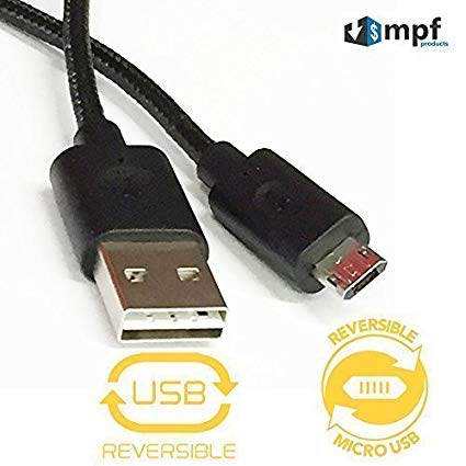

I'm not at home so can't check but is it a reversible micro USB connector? Check the attached image. Basically, you can plug it in either way and it will work. Kinda like USB-C.

DNSB, yes, I think that's it. I've never heard of it.

The reversible connector is not actually a standard. I have a couple of the micro USB to USB A cables with both ends reversible. Check the rather thin piece of plastic in the USB A connector in the image.

Ah, I misunderstood your question — sorry about that! I'm glad someone else had a better answer than I did. I have actually still been using the cable that came with my GloHD to charge both the Glo and Forma, so the cable that came with the Forma is still in the box. Maybe I should dig it out and start using it if it's reversible (and assuming it is backwards-compatible to the Glo, which I can't imagine it not being).
